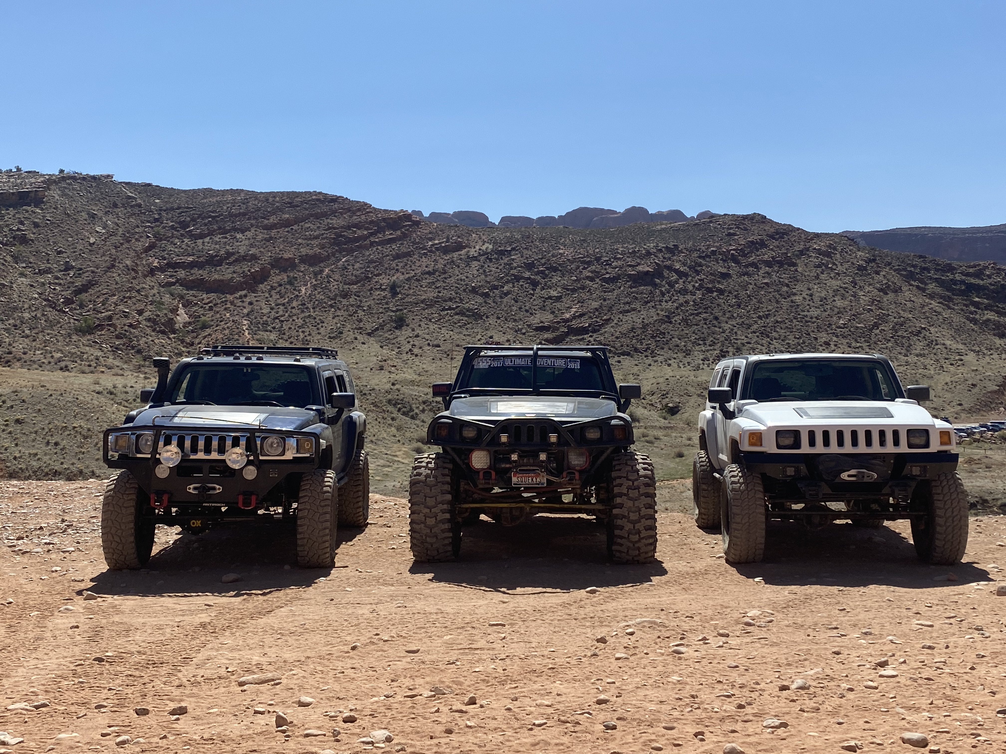

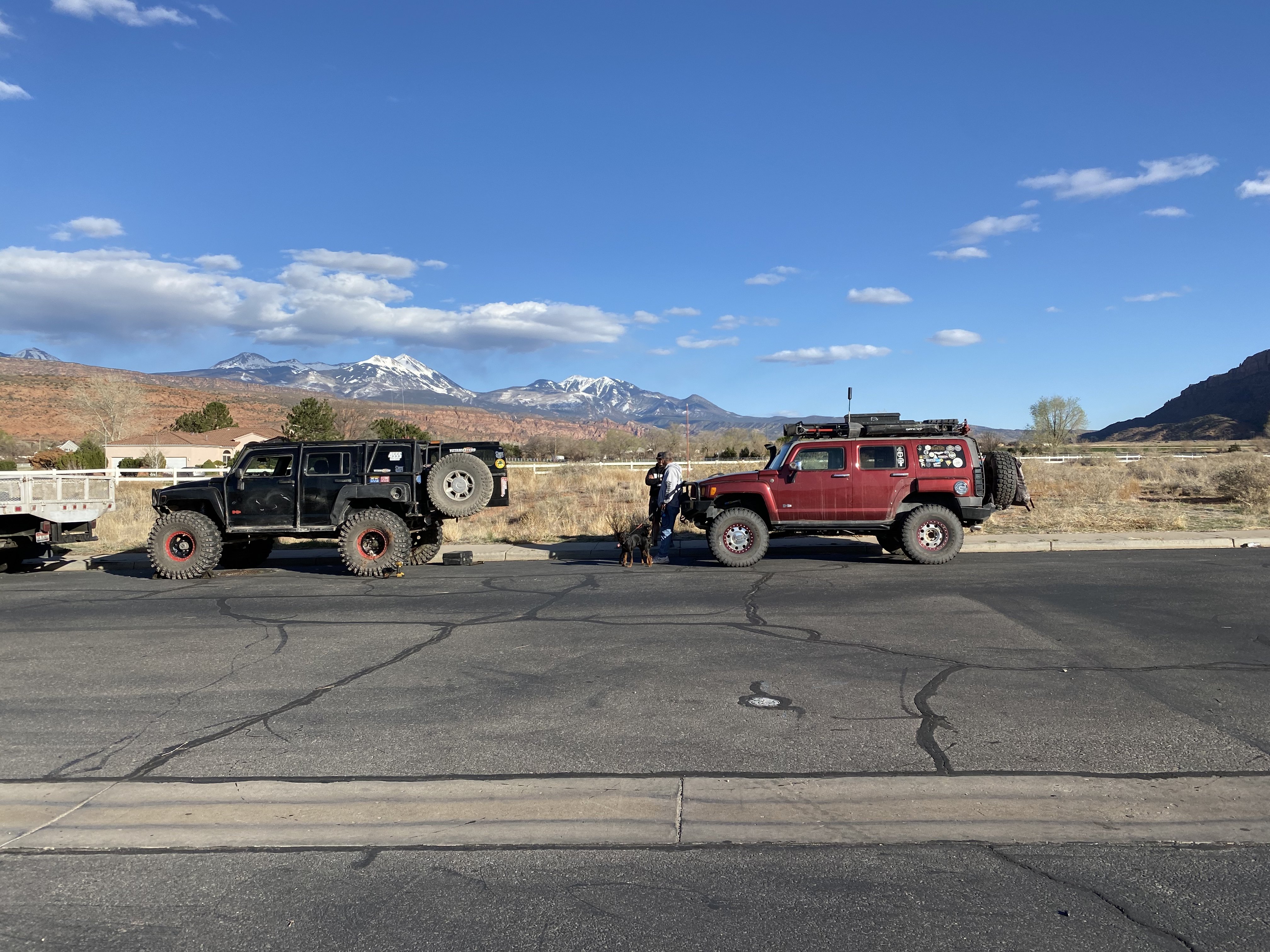

here’s a pic of Squeaky next to my H3 on 37s and Rancho lifted
and next to two SAS Alphas on 37s
9,496
For being on 43s I don’t think it’s horribly tall. I tried everything in my power to keep it as low as possible and still maintaining good uptravel
