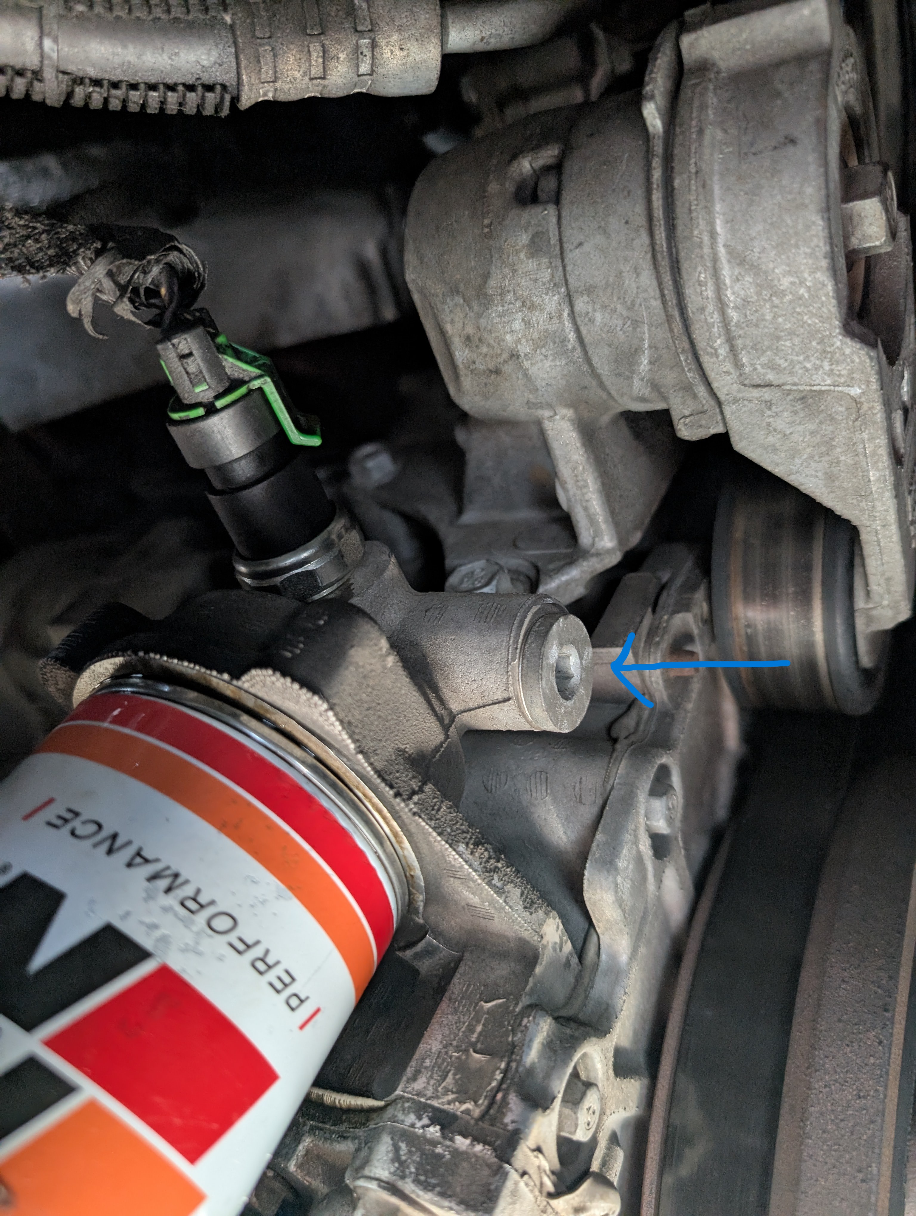

Hey all,
Nube to the forum happy to be here.
I am wondering if i unscrew this cap what's under it and if i am able to add an oil pressure sensor to this location . Still have the window sticker I thought you all might enjoy looking at it.

You pulled the plug holding the bypass valve to add your Oil Pressure Gauge. Did you leave the bypass valve in place?
BTW the plug is metric, not SAE.
Ridinhigh1500
35
Raleigh, NC
All I did was pull the plug to put in the sensor that is it. It has worked great for almost two years now. Yes, I know it's metric but I didn't have any metric RBT impact sockets that big. It also fit nice and tight.
You should be able to pull engine oil pressure using a scan gauge.
You're looking at an I5 here, it only uses a pressure switch. The V8 has a pressure sensor, which is mounted in the head.
When I added a gauge to my I5, I removed the pressure switch you see there and added a brass tee to mount the switch and the gauge's pressure sender. Also, only go with an electronic gauge, not the cheaper mechanical gauges. Having a small hose be a point of failure on something like this is a terrible idea.
