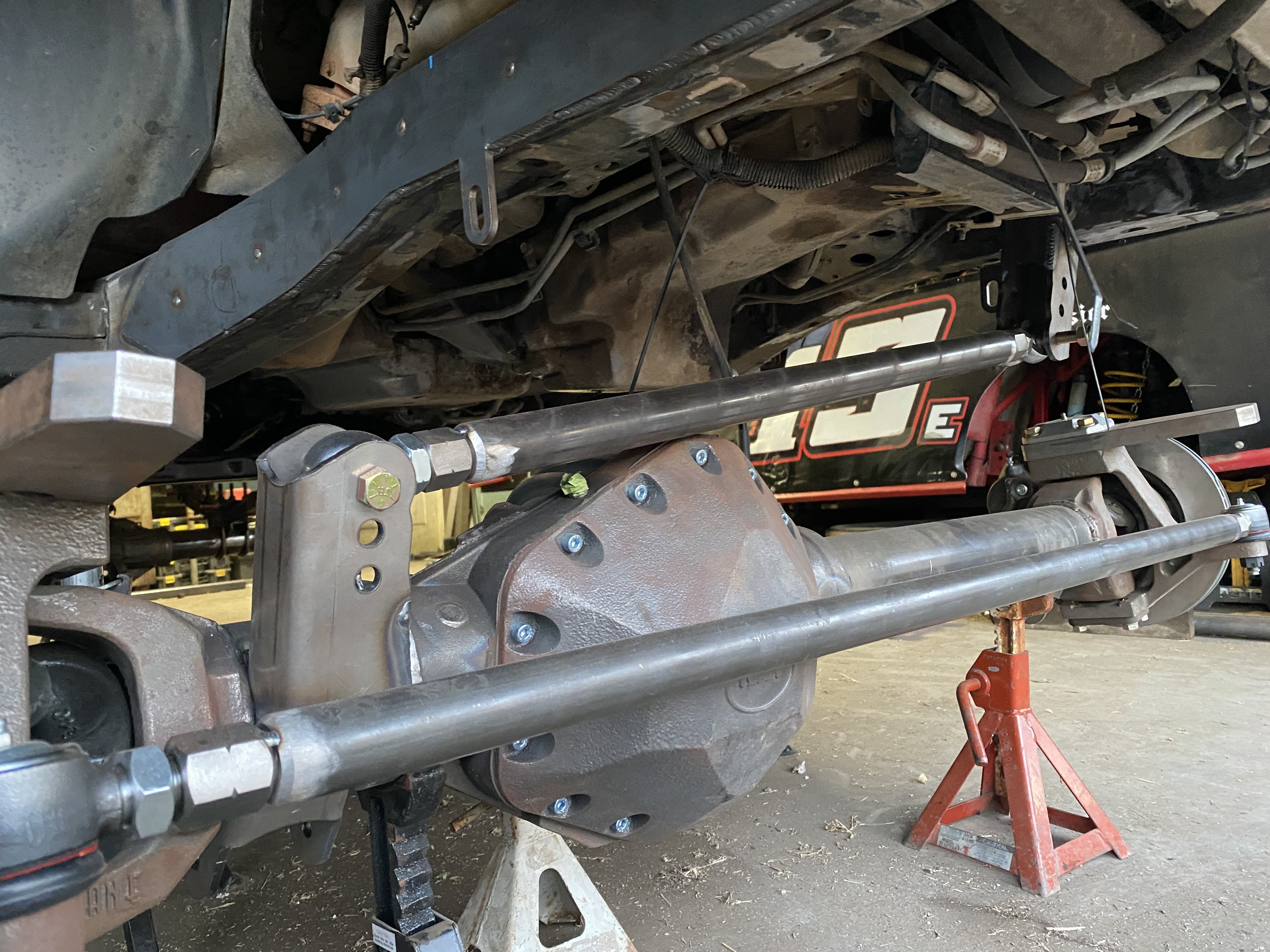

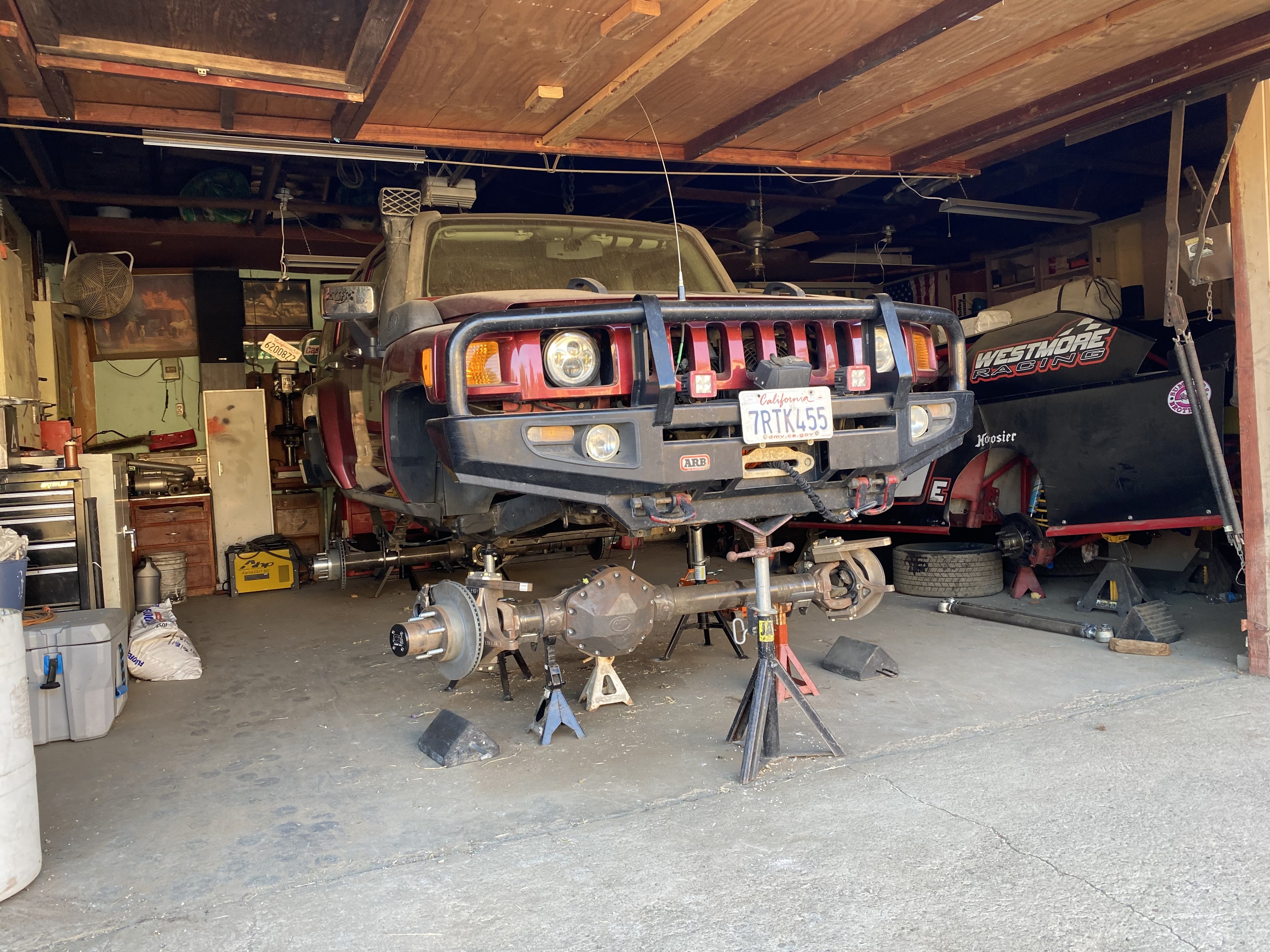

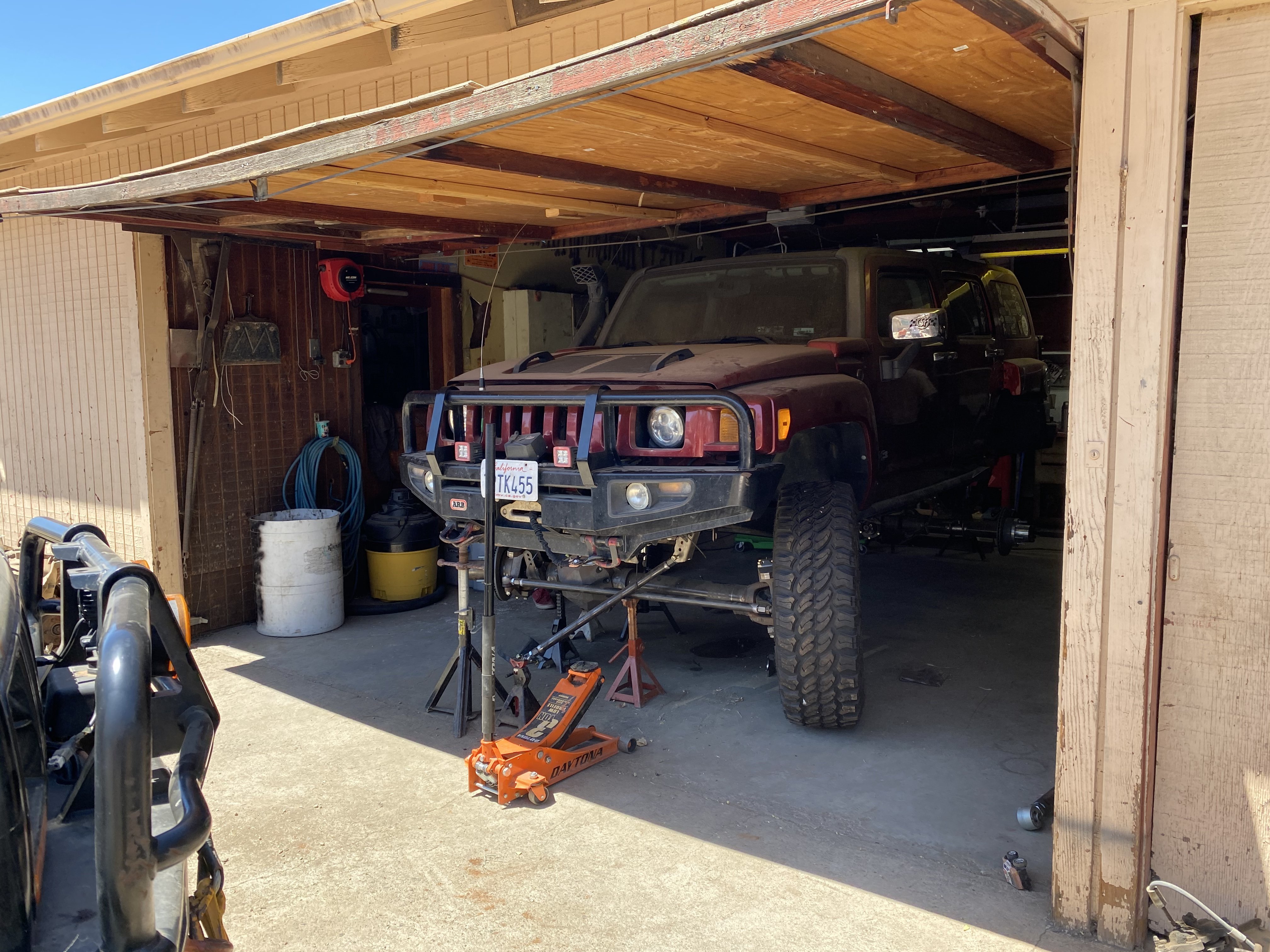

20F999B4-CE36-4328-AB0A-43F4A4D2E2E4.jpegTrackbar tacked in place. We originally started with an inside the frame upper mount, but ended up using an outside frame mounted upper trackbar mount

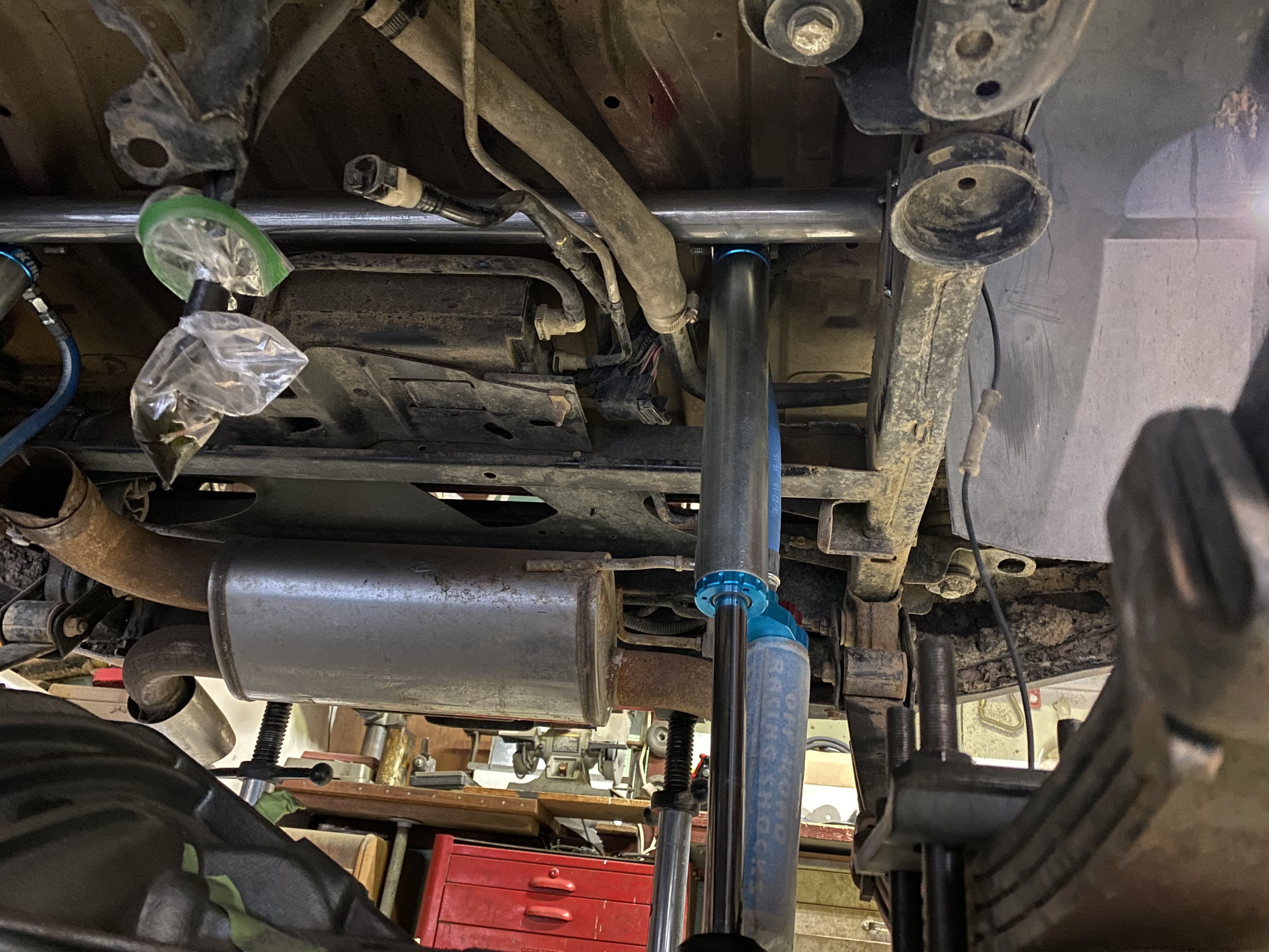

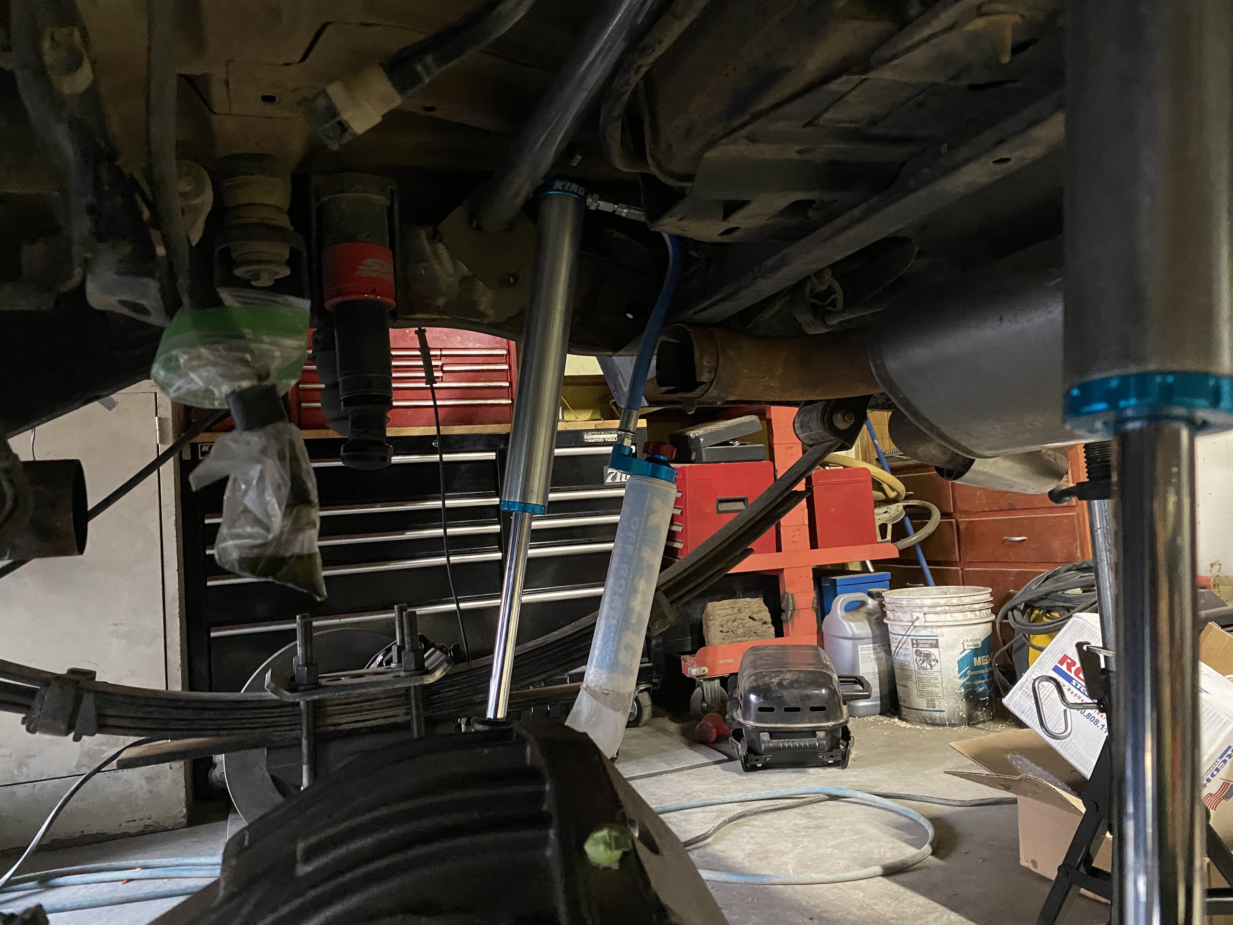

D73E94BD-7D9A-4F59-9526-D8180EAE329A.jpegThe rear shocks are King 2.5” shocks with a 10” stroke, they’re pretty long so we did a custom crossmember to mount the shocks higher up
