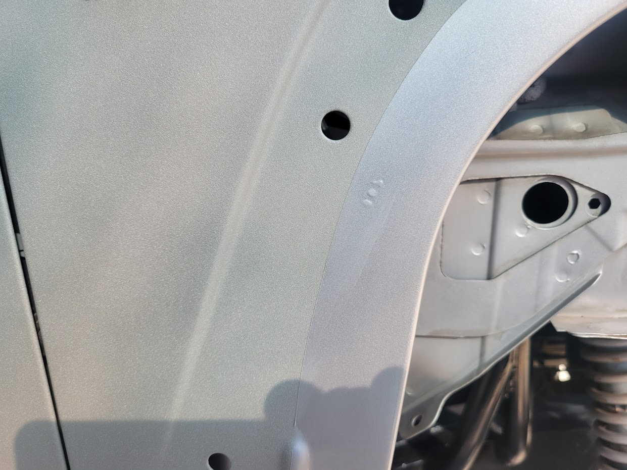

Decided to strip all the trim off the H3 and finish my "paint" job, dessert pinstriping was getting bad and clear coat was starting to flake off. 3 years ago I sprayed the roof and hood, the clear coat was pealing off and looked horrible, typical GM problem. The roof and hood have held up really good for 3 years so now was a good time to finish. The Raptor Liner came out great, I'm 9 out of 10 happy with the results. Was hoping for a bit more of smoother finish but it should get better after a few washings or a 3000 grit wet sand.
The best part of painting anything is prep work. Took longer to do first round of tape than to spray.

Used a cheap purple Harbor Freight gun drilled to 2mm but with how I used it the regular 1.4 tip would have been better. I thinned the Raptor to 20% gun pressure was at 60 psi, flow valve was set at 3 turns open. When we sprayed my sons truck with white, the flow valve was wide open and it was too much, we got some tiger stripes but not too bad. It is very forgiving and mistakes are easily fixed.

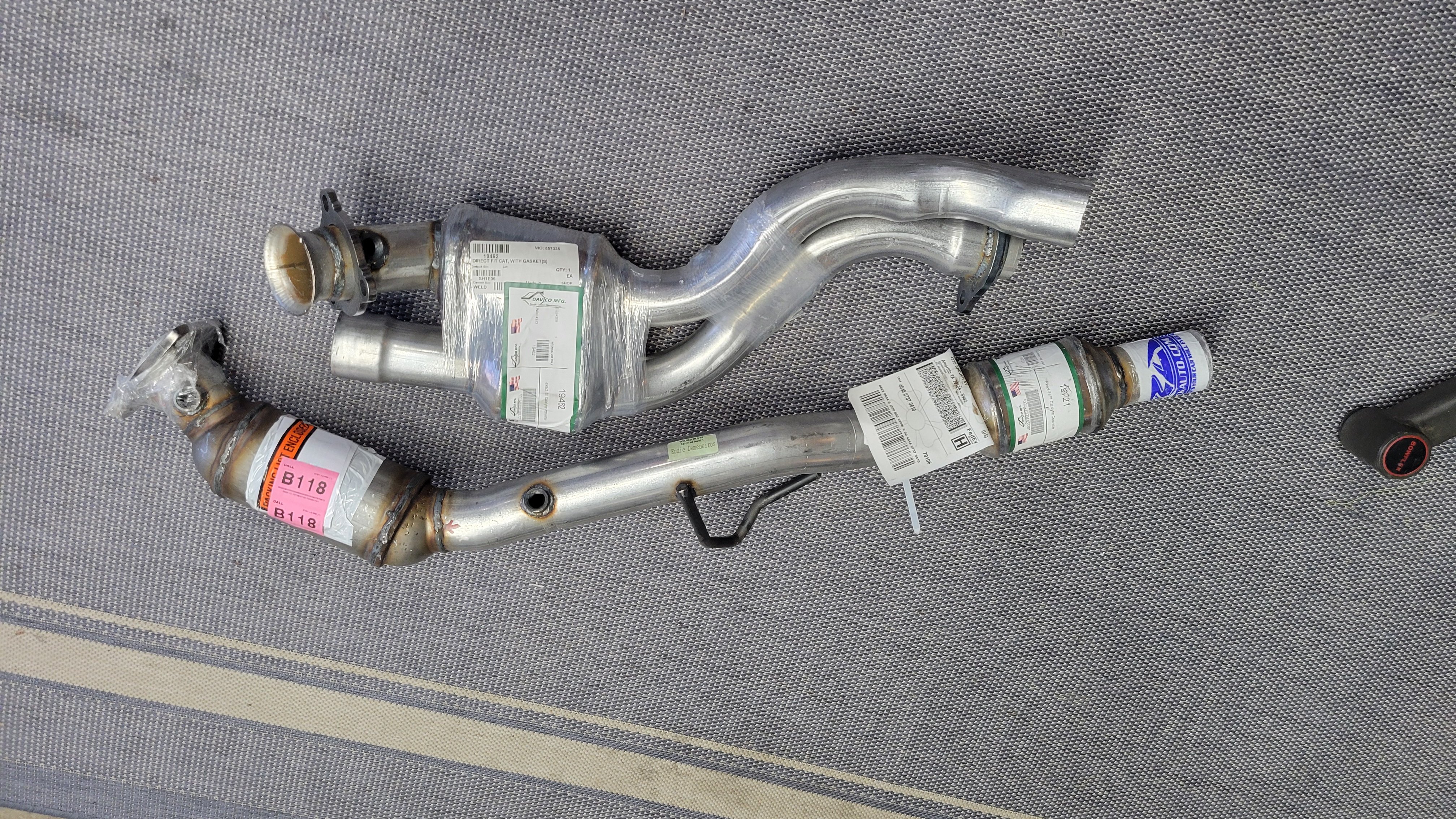

Santa from Rock Auto made a special delivery, last of the big ticket items needed for the swap. Engine should be done in a few weeks then need to nail down a date to start pulling out parts. Going to wait until closer to summer have a couple trips planned to the desert yet this spring.

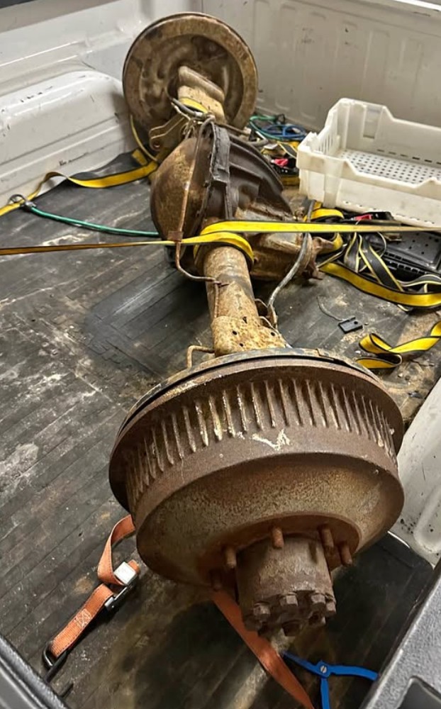

Broke a rear axle for the first time trying to pull someone out. It was enough for the stars to align, and I bought a 14 bolt. Found a 1999 2500 Silverado FF for $200. Looking for some input from the few that have already gone down this rabbit hole, here is a list of what I have already bought, then a list of what I think I need. Looking for ideas and input, good, bad, and ugly. Need to make it quick and simple for a Rubicon trip this summer for a special occasion. Will add E brake and ABS later. Conner and Chris have already made recommendations, and a truss and anti-wrap will be down the road. All OEM mounts have already been removed, waiting for Barnes parts to arrive. Last picture is proof I did some of the work myself. Big props to my son Derek for doing most of the cutting and cleaning.

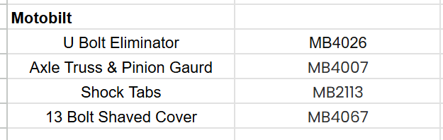

Parts I'm thinking about:
Lugnut 4X4 Disc Conversion
BYO w/E-Brake
Barnes 4WD
U Bolt EliminatorB4W0066K
Pinion GaurdB4WK1004H
Shock TabsB4W25026P

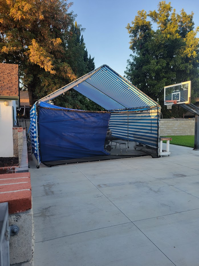

Makeshift paint booth.

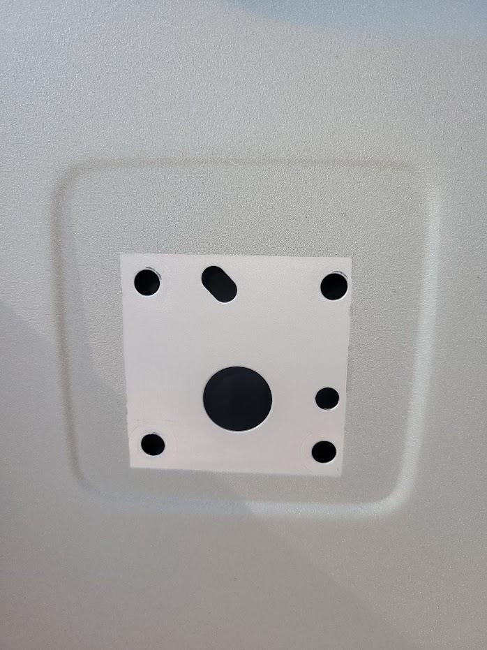

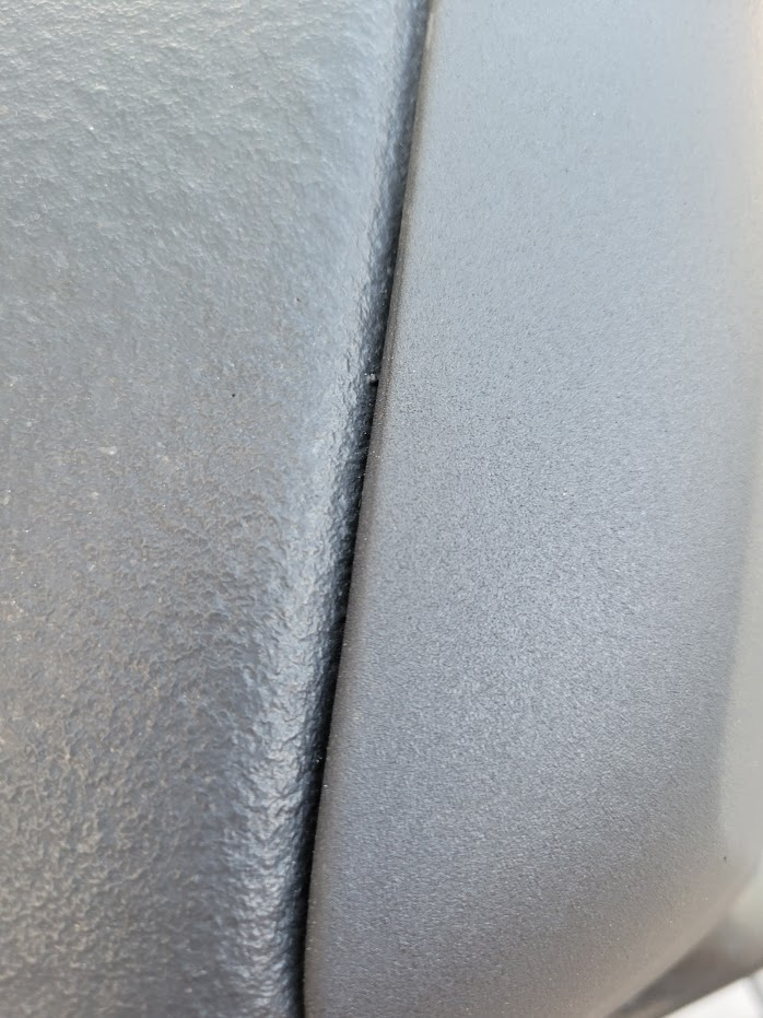

Comparing the new Raptor with the old paint.
Comparing old Line-X to new Raptor.
