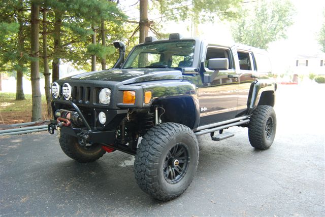

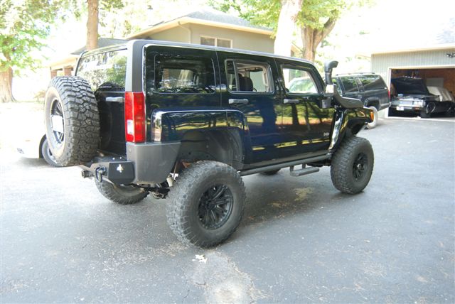

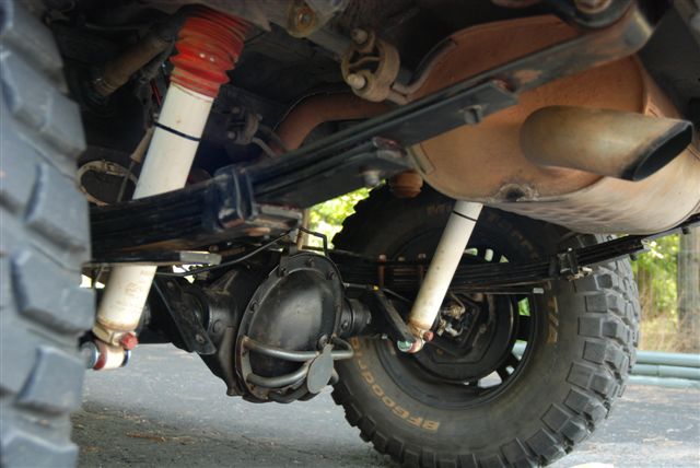

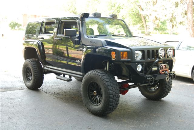

Now that Warren is finally out of the garage (and washed)...here's a few pics. Tires are 35"s (and look tiny). I'm currently running stock rear springs with a SOA and some Colorado/Canyon add-a-leafs. I bought them from a guy on ebay named "topguncustoms", that I had dealt with before. They were cheap and got here fast. I didn't have time to comb the boneyards for some SpeedySprings but, I still want to do his full-length 3/4ton leafs in the future. Right now I'm sitting 1/2" higher in the rear (just the way I want it to). The ride is actually very nice...not harsh at all. We'll see how the cheapy AAL's hold up over time. Don't look too close...still got some stuff hangin loose but, I'll be fixin all the details over the next couple weeks...
DSC_0016.JPGDSC_0018.JPGDSC_0019.JPGDSC_0007.JPGDSC_0013.JPGView attachment 5296View attachment 5297View attachment 5298
Next stop?...the RTI ramp for some flexin and bump-stoppin.
