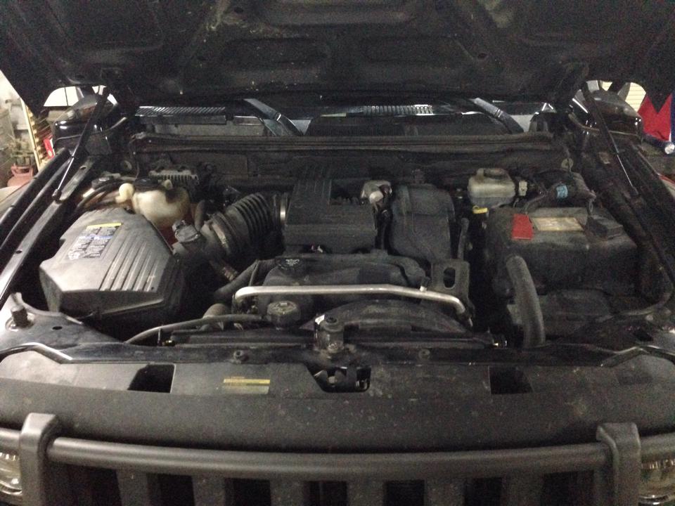

The grill has two sections. To remove the assembly, it's four bolts (two in front, need a ratchet with a longer extension, two on the back) and two nuts, all 10 mm. Then its plastic snaps on the ends into the fenders. Just give a firm tug straight back. The two nuts and two bolts on the back are easily visible when you open the hood and look at the back side of the grill.
You don't necessarily need to remove the inner "liner" that gives the grill its strength to use plastidip, bedliner, etc. The link above includes pictures with the liner removed.

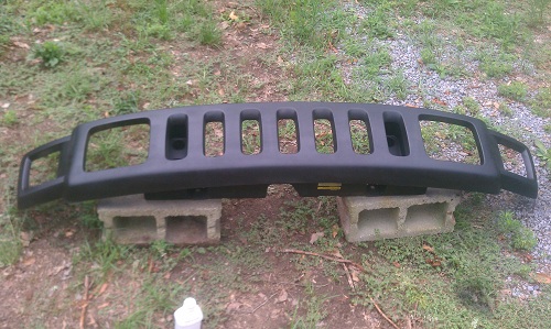

Plasti-dipped
took grille off, put 4 coats on

That was the first time i did it, ive done it over since then but it looks the same as that now but dirty. i need to find a better way to clean this stuff
this is my most recent picture of it that shows atleast part of the grille (taken yesterday), ill post a better picture tomorrow because its dark now

Make sure you get the edges really good. Flip it over on the face and spray around the edges from the backside. Then flip it and spray the front. I didn't and I can see chrome around the edges on mine. I gotta take my grill off again to replace all the clips I broke so I'll respray it. I don't wanna have to take it off again for quite some time cause those clips cost me $30.
