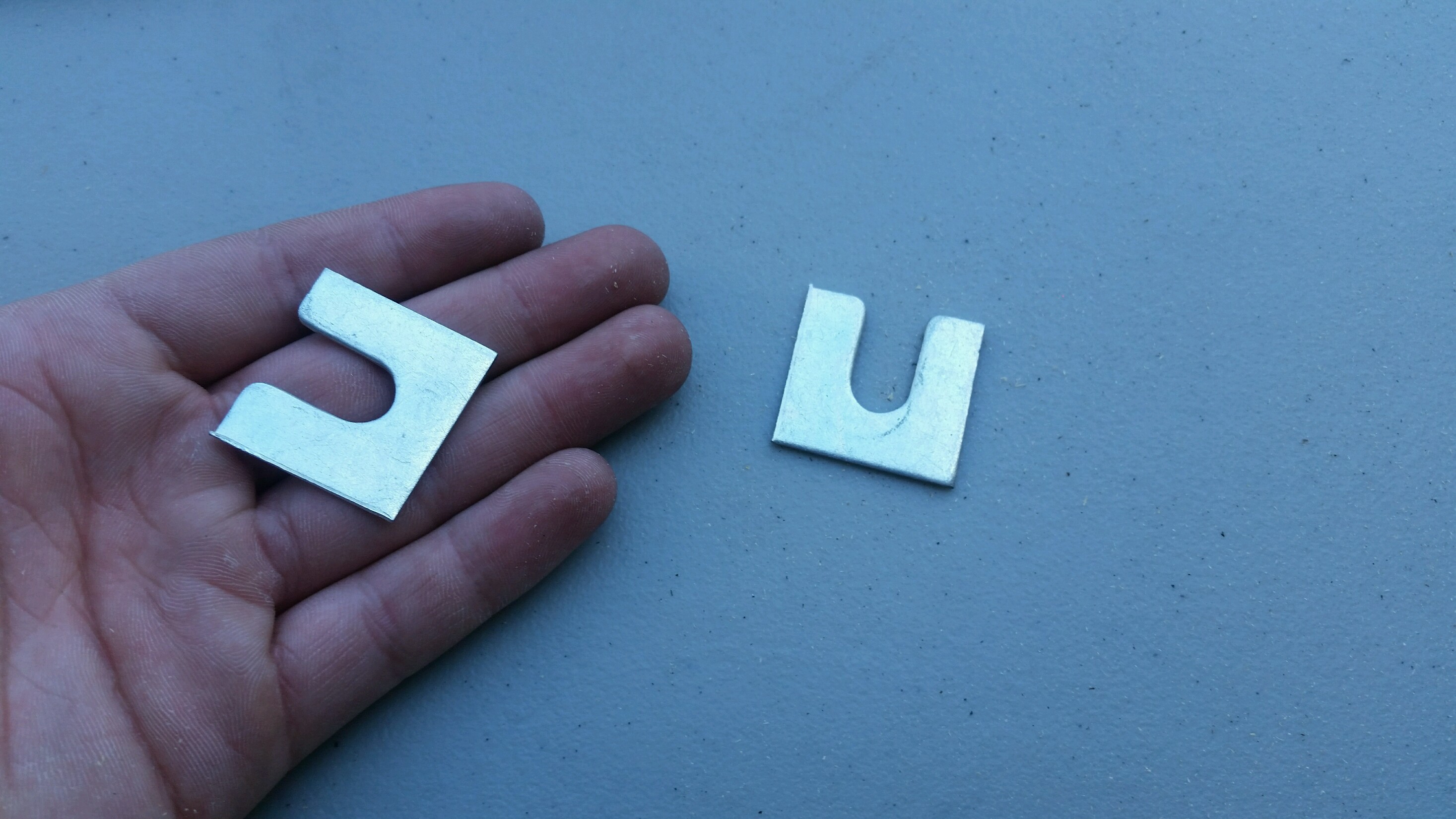

Got off the grill, but when I was undoing the clips on the passenger side two metal pieces fell out, I cant find anything similar on the driver side...
4,244
Those are body shims. I would guess someone has put those in there to fix a body panel alignment issue...possibly from a previous wreck or something.
