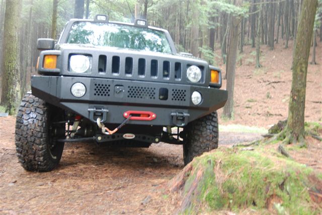

Let me know if you need help with the BA and/or winch project....I know people. Definitely enlarge the hole where the line comes through the front of it. For some reason they made this hole to work with the roller but, its too small for a Hawes type. Failure to enlarge it will surely result in a chafed winch line ($$$). Its a minor mod but, since you are re-coating it (like most BA owners)...now is the time. Also, you might consider using your previous brushguard with the BA. The one that comes on the BA can be un-bolted, and tossed aside. I installed some stainless button-head bolts to conceal the holes....

Those same holes also make a great place to mount your Hi-Lift. I think I have a couple pairs of BA bumper jack-mounts lying around. Lemme know if you're interested...I can throw em my box, and get em to you the next time we hook-up for some wheelin...

Thanks for the tip CJ. The BA is STILL in my garage because a combination of laziness and no time have prevented me from getting it blasted and coated. I will have the opening widened slightly before i have it all finished. I think i will keep the brushguard that it comes with though.
