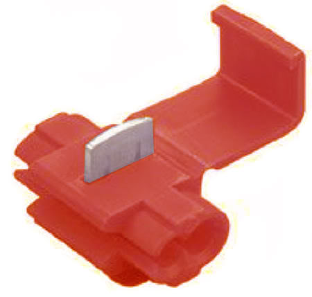

If you used something other than the scotchlock (briefcase) splices, then I'd give them a hit with some good flux, solder, and soldering iron. If you used scotchlocks then i'd ditch them and just solder the wires together properly with some heatshrink tubing over them. Honestly, unless you have a really good crimper, I'd solder everything to make sure you don't have any issues. The cheap barrel crimpers you get from just about everywhere are next to useless for proper crimps, especially on small gauge wires.

Squeeze splice. The wires are tucked up pretty snug above the glove box. I'll get a few shots and post them.
They came in a package like this (and a close-up for a little more detail)

Thanks for the reply! I would love to solder them, but can't given my current housing. I'll have to check into crimping them. Right now the wires are connected with squeeze splices.
