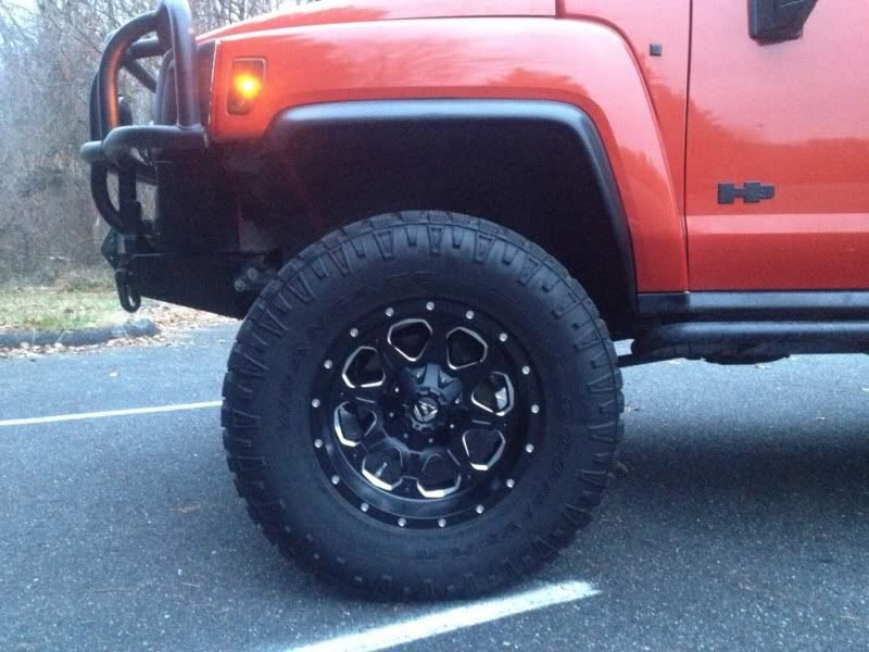

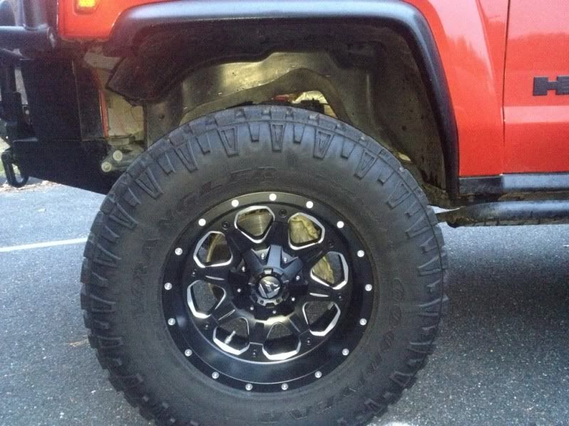

I came home from a work trip to find my 5 new wheels sitting on the porch and a delivery attempt slip from ups for my fender flares. I had been running 5" backspacing 18x9 wheels previously and can now see why 4.5" of backspacing is basically the minimum based on how little room the is from tire to knuckle. The new wheels are 18x9 fuel boost with -12 offset, 4.5 backspacing. With the half inch less protruding on the tires and the fender flares I don't have much tire sticking out anymore. Now I can actually pass inspection if I have to. Pictures aren't that great but it's all I could do with a parking lot, phone, and near dark conditions.

Thanks. I'll try that too. I wish It was a little warmer so that paint on the flares could bake some more in the sun.
With your setup do the fender flares stop debris from hitting the side of your car or just reduce em?

There's still some dirt but the flares to block most of it. I don't notice the water and mud being slung around while I drive anymore
