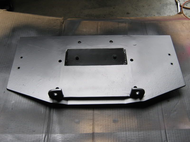

I mounted it and used it on a trip to Evans Creek. Then when I got home I pulled it all out and checked everything. It made a really hard pull on a stuck Super Duty, but I found no signs of problems. Nothing cracked, stretched, or shifted at all. So, here it is with all the mounting holes and a coat of paint:

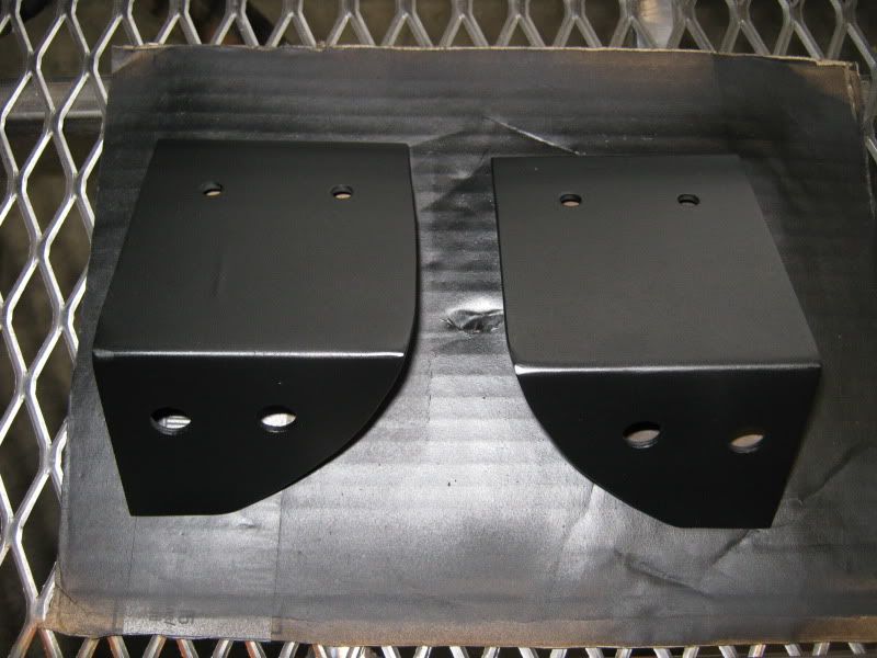

In the picture above you will see two holes on the right and left ends of the plate. I made these two brackets which bolt to the bottom of the winch plate, and are bolted to the truck frame using the two bolts for the front tow hooks. They probably are not really needed, but I figured they would tie the whole thing to the frame in three points now and give it more rigidity for side angled pulls. I failed to get pics of it installed with the brackets.

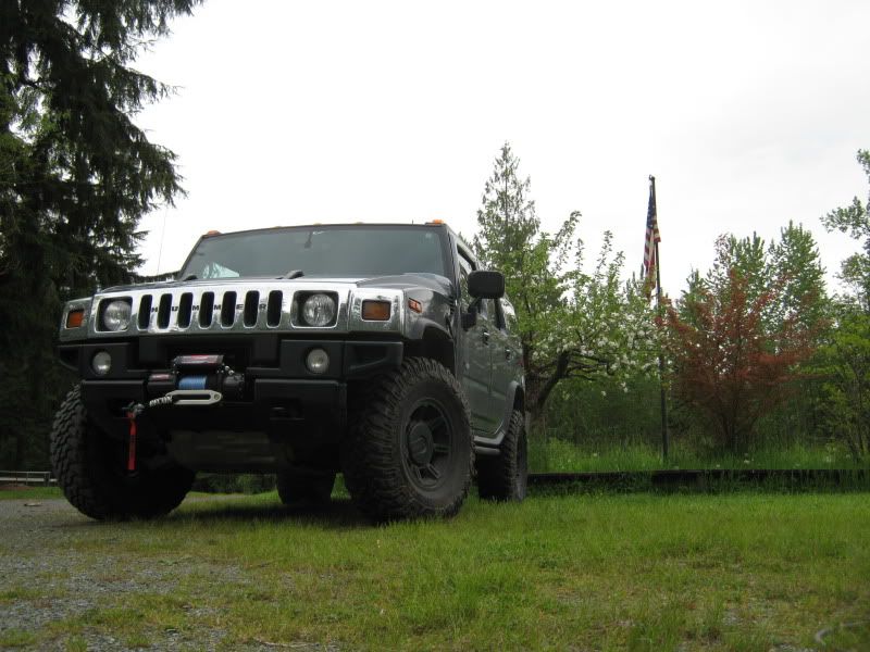

And the whole thing installed:
