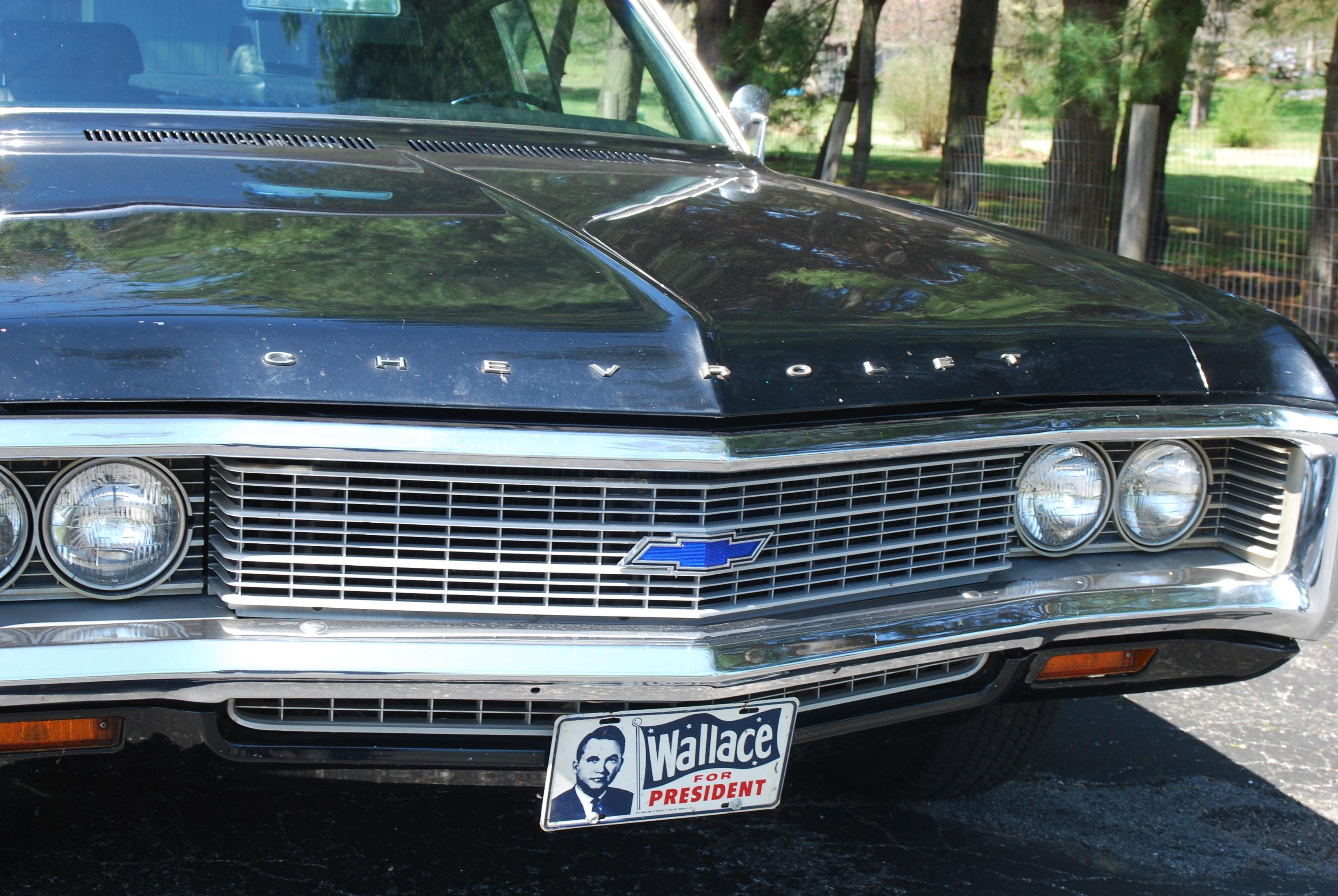

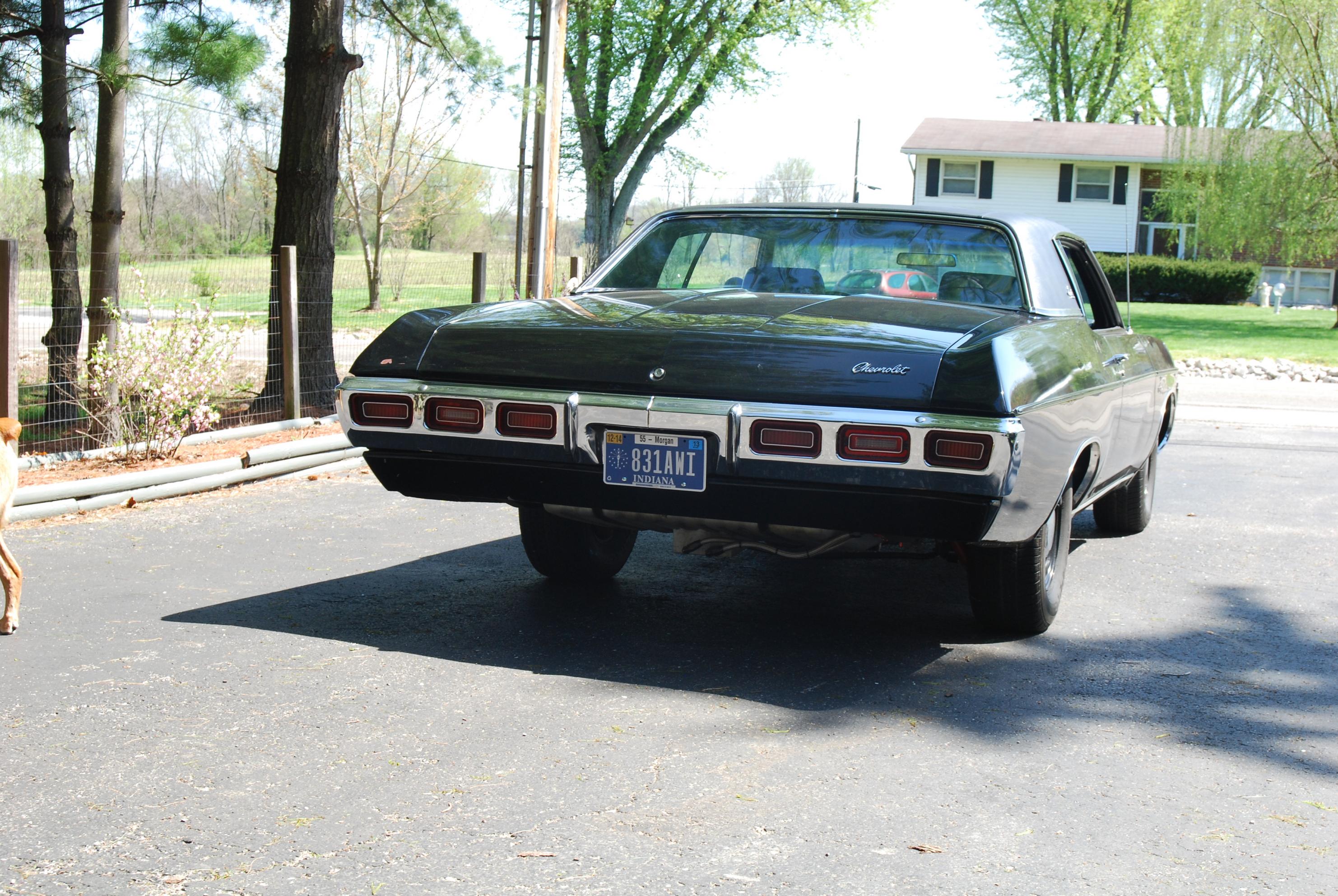

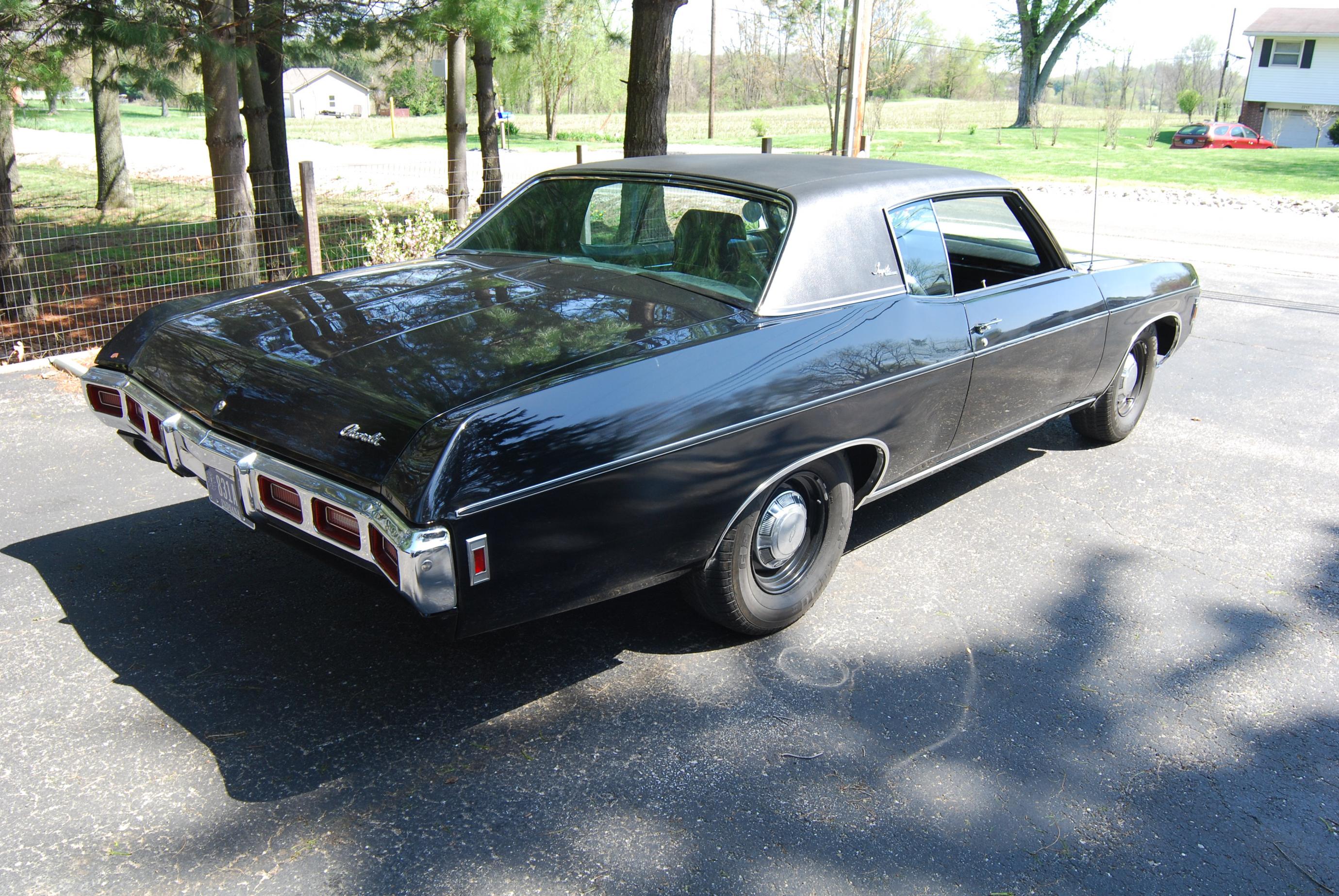

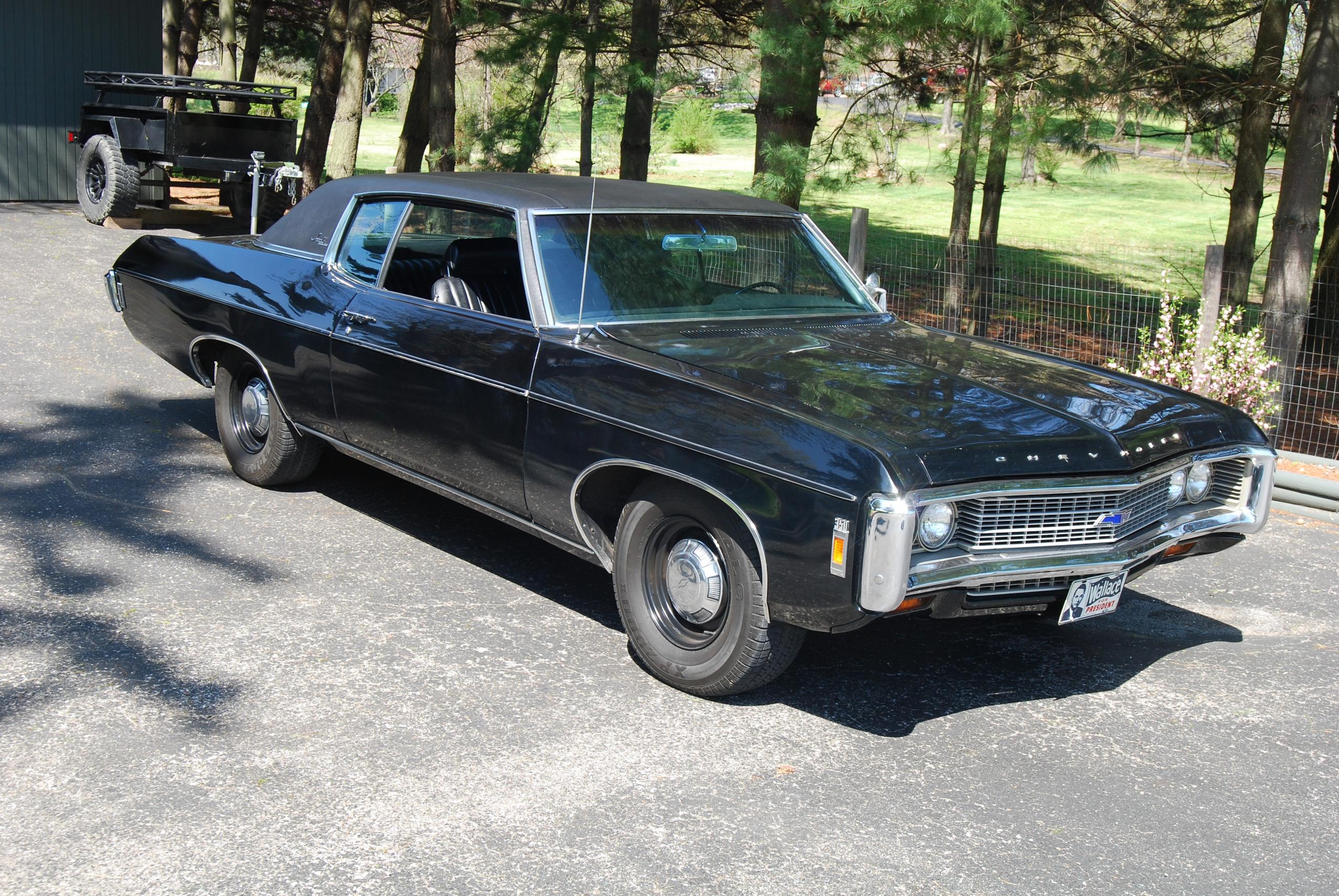

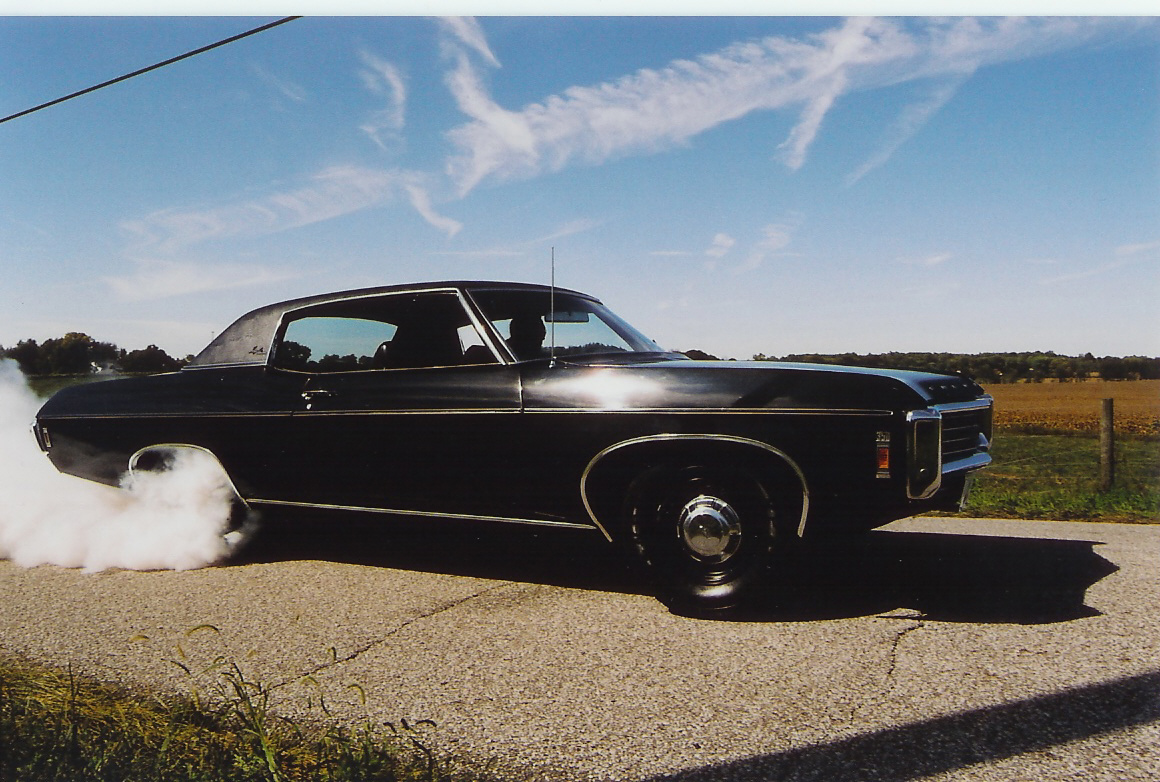

My 69 Impala (whale)...

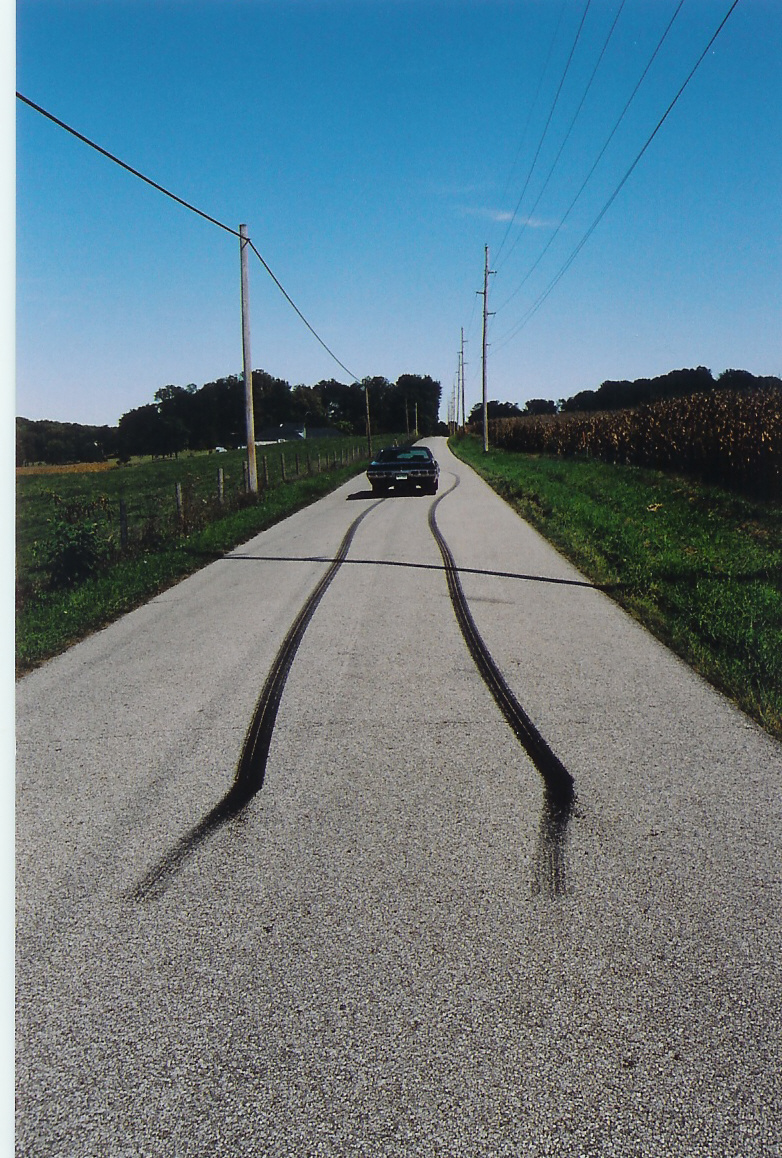

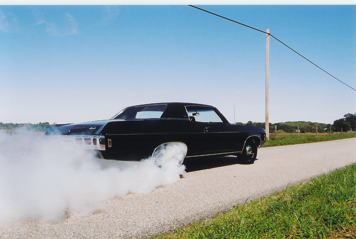

Its filthy but, that's original paint. Factory buckets/console car, F-41 suspension, radio delete, tilt, 502 crate motor, Tremec TKO-600 5-speed manual, Lakewood bell with Centerforce clutch, stock 12-bolt with Eaton posi and Richmond 4.11s, custom upper & lower trailing arms, airbags inside rear coils, AeroMotive fuel system, Barry Grant carb (750vs for street and 850DP annular discharge for strip). Weighs 4400 lbs without me...best time is 12.92 at 108 mph with mufflers & MT-DOT Radials. Runs on 93 octane, and left front wheel might hop a beer can on launch. Its an extremely mild motor...idles like a *****-cat...drive it anywhere...8.5:1 CR. Poverty caps and orange valve covers...total sleeper. It loves to eat teenagers in Mustangs.
