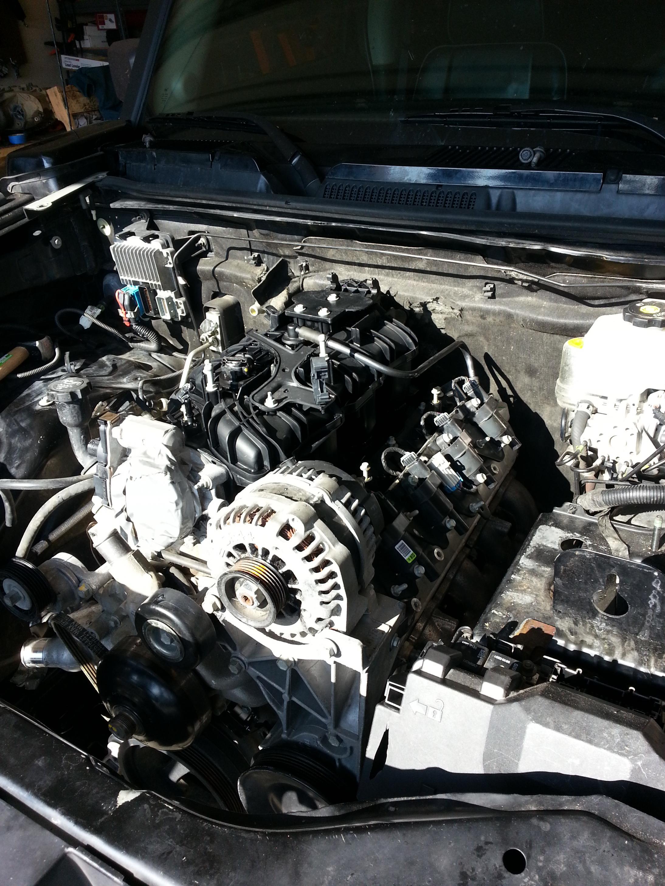

I bought a 2006 H3 a few months ago and have really enjoyed it with the exception of the complete lack of power from the 3.5L I5. The only modifications I've done so far are black out the chrome, tint the windows, level the front, and new wheels and 35" tires (which definitely did not help the HP problem).
Recently I had a pretty major issue with the stock motor. A small bolt came loose and fell out inside of the timing chain cover on the back of the engine. After bouncing around inside for awhile (made some very strange noises), it caught the timing chain and was ejected through the timing chain cover. Luckily I was not too far from home and was able to make it before it lost too much oil. The engine is very repairable but I decided since I was probably going to have the pull the engine anyway, this would be a great time to do a 6.0L swap and build a H3 that would have the power I reliability I want.
After doing some research and talking to some knowledgeable people, I decided the best engine for the swap (while staying within a reasonable budget) was a 6.0L LY6 out of a 08+ chevy truck, van, ect. These engines have the desirable L92 heads, variable valve timing, are 58x, and make great power. I found one out of an 08 2500HD with only 23k miles complete with all the accessories.
Most people who have done similar swaps in 06-07 H3s and also Chevy Colorados use a car intake for clearance with the pinch seam on the firewall (08+ models have a different firewall shape). I have read that the stock truck intake makes great power and torque so I wanted to keep it if possible to save some money by having to buy a somewhat expensive car intake/injectors. I spent some of that saved money and bought a mini sledge hammer from harbor freight and went to work "modifying" the pinch seam and firewall for clearance for the truck intake. I did a test fit today and everything seems to fit well so far.
I spent a lot of time trying to find similar swaps and there's not a lot of info out there for H3 swaps yet so I'll try to cover all the major stuff and post a complete parts list. I'm hoping to make this a reasonalbly quick project so I should have some updates soon.
Engine swap and quick don't belong on the same sentence. There WILL be some head scratchers at some point.
Please keep us updated on this. Looks like you have done a good bit of research up to this point and are already deep into it. Be sure to keep us posted with lots of pics. I want to see what you do to get exhaust headers fit in there and what you end up grafting on wiring.

TM...So did you use stock Alpha motor mounts? Looks like it belongs there. Just curious what amount of "fab" is required, other than trimming the firewall, and replacing the AT with one from a V8. I've got an 08 model so it is probably good to go with the firewall. I know many stock Alpha owners complain about radiator capacity...going custom to handle the extra cubes? Make sure to have 04coly record the wiring mods (probably some future sales in that department).
The motor mounts I’m using are from Current Performance. Here’s the link:
http://www.currentperformance.com/shop/04-08-colorado-canyon-v8-engine-mounts/
Haven’t decided what to do about the cooling system yet. On Mash Motor’s website they say that their swaps reuse the stock radiator and include a “heavy duty” fan and clutch. I’m hoping to use an external trans cooler and maybe an electric pusher fan on the front of the radiator along with the stock mechanical fan. If that’s not enough, I might have to go with a custom radiator.
The oil pan is GM's muscle car pan (part# 19212593). Its the same one used on Alpha H3s. The cheapest place I found to buy it is Jegs.
