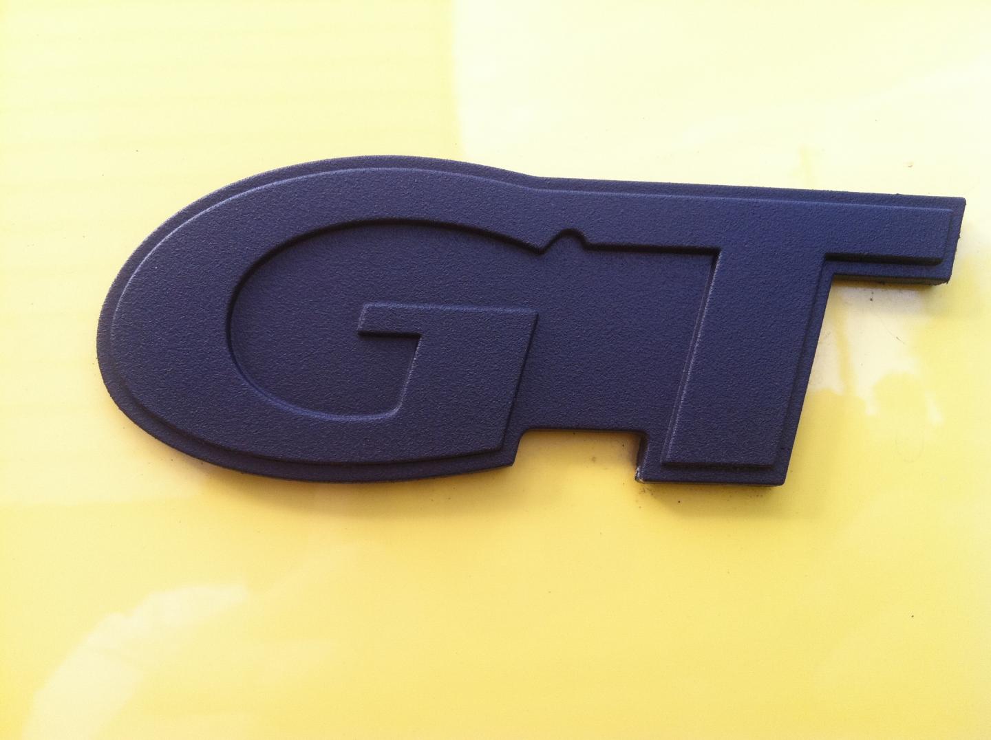

MustangGirl666
291
West Hartford CT
I plasti dipped my emblems about 3/4 months ago on the H3 and its held up really good, I also plasti dipped my mustang's emblems a while ago and they also have held up, I like the texture of the pasti dip compared to regular paint to and you can always redo it.
