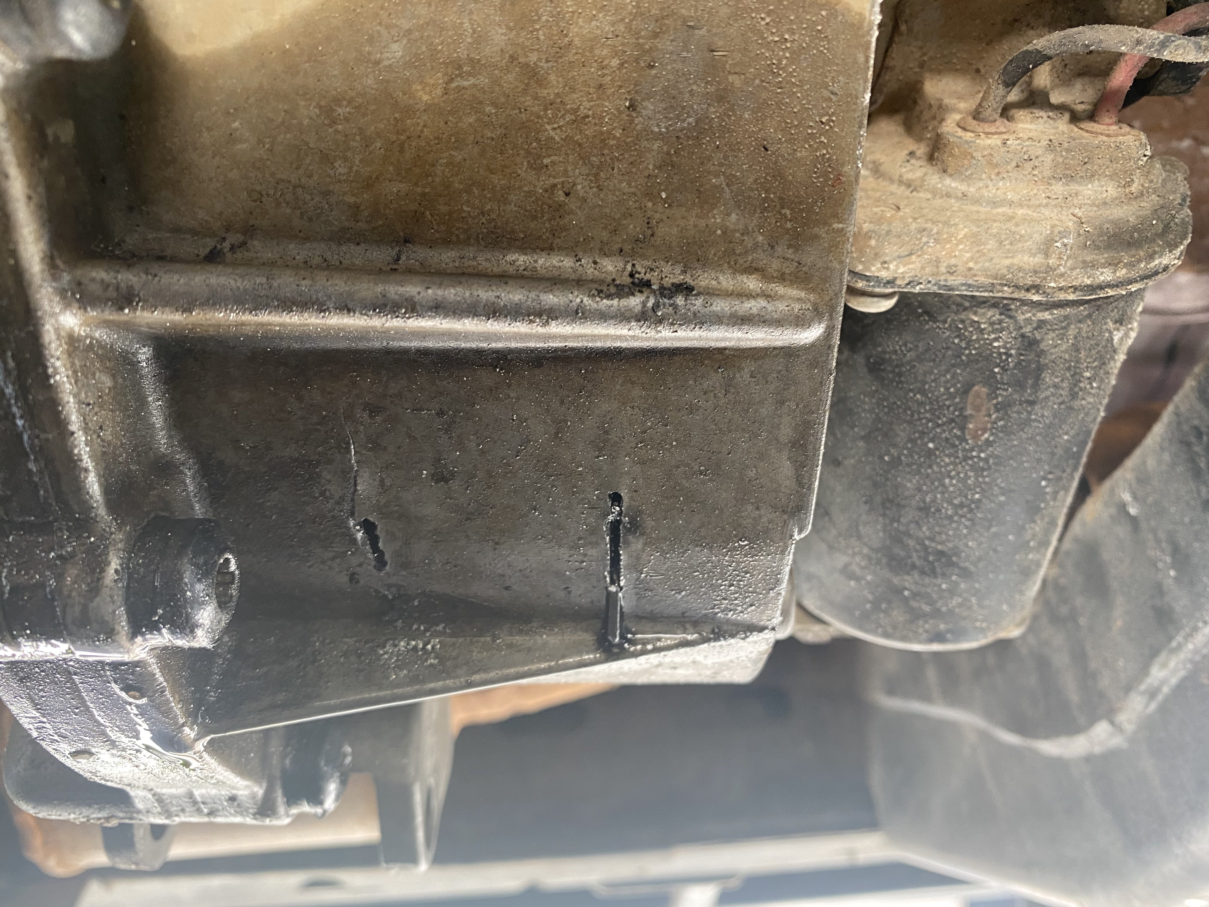

Most of Us are confident it was from when the spring plate broke. The axle came off and pushed upward and forward. Was on an incline so the weight of the vehicle pushing back on the axle. Basically the rear driveshaft got pushed into the tcase. Wasn’t apparent right away because I was able to wheel the rest of the week. It was on a straight dirt road when we finally heard clicking and realized something was wrong with the tcase. 38CB6F07-4ECB-4A49-9481-05085DDFD1BE.jpegAs you can see there are two slits cut from the inside out

Most of Us are confident it was from when the spring plate broke. The axle came off and pushed upward and forward. Was on an incline so the weight of the vehicle pushing back on the axle. Basically the rear driveshaft got pushed into the tcase. Wasn’t apparent right away because I was able to wheel the rest of the week. It was on a straight dirt road when we finally heard clicking and realized something was wrong with the tcase. View attachment 27932As you can see there are two slits cut from the inside out
Thanks Vdawg!
It seems that happened in the front slip yoke area, where chain move the front slip yoke. Did you ever open the transfer case to see what causes those cuts?
I think that maybe the broken plate causes something, but seeing that those cuts are in the front slip yoke area, i think that the only possibility is the snubber plate breaking free and causing that!
4speedfunk has some thread talking about that snubber plate failure and how to reinforce it
Hope we can discover more about that failure and adress that in the future!
