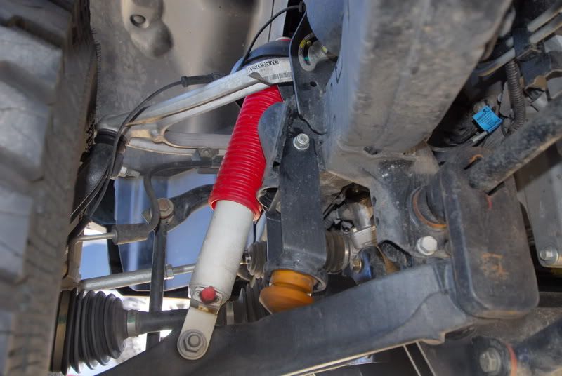

Schwarttzy, The reason I'm looking to add the trail duty extended bump stops is that I recently purchased a H3T Alpha. The previous owner installed a Tough Country 4" Lift. Don't think there were many of them made, and spare parts for the lift are non existent. The Tough Country 4" lift kit came with extended bump stops of their own, but they were long and skinny, and I read complaints of them popping out. When I bought the truck, the front driver's side bump stop was missing. In my situation, since the truck has a 4" lift, the trail duty extended stops won't actually be resting on the arm at ride height, but would prevent the arm from slamming down into metal, and would be less nose dive than if i were to use the stock bump stops. The Trail Duty bump stops also look like they'd stay put better than the Tough Country stops, and they're available, maybe. If my logic is flawed, I'm open to constructive feedback, as I am a newbe, and respect the experience of other members on this site. Thoughts?
Run stock bumps with extensions (similar to the Rancho kit). Probably have to fab your own...or go for hydraulic bumps.
Long term goal is Light Racing's Jounce kit (front end), but they exceed my current budget. Appreciate the idea on stock bump stop with bracket extensions, hadn't thought about that. Might end up going that route.

The Rancho bump extension brackets leave a lot to be desired. The concept is okay but, the brackets themselves are iffy. They are made to be "bolt-on" and this includes drilling and installing a cross bolt as well as using a special nut welded to a long piece of metal so you can get another bolt installed. When you finally get them installed...they sit at a rather obtuse angle to the control arms (IMO).
I think welded-on extensions would work much better. You would need to gently cut the factory bump stop cups off the frame, and re-weld them on to some 2" x .250" wall tube extensions, approx 4" long. This would also give you the opportunity to correct the angle so they contact the LCAs properly. One of several minor tweaks that the Rancho kit needs to take it to the next level.
Exactly. Thanks Hunner, I could not find a clear picture of what I was talking about. I always thought the Rancho extensions look goofy...like the bump is tilted in the wrong direction. Look closely and you see the stock bumpstop mounting cup hidden inside the new extension. I think you could cut that loose with a saw-zall and make some custom extended bumps out of 2" tube. Then you could correct the goofy angle and position them to contact the LCA at the proper angle. Pic is worth a thousand words.
