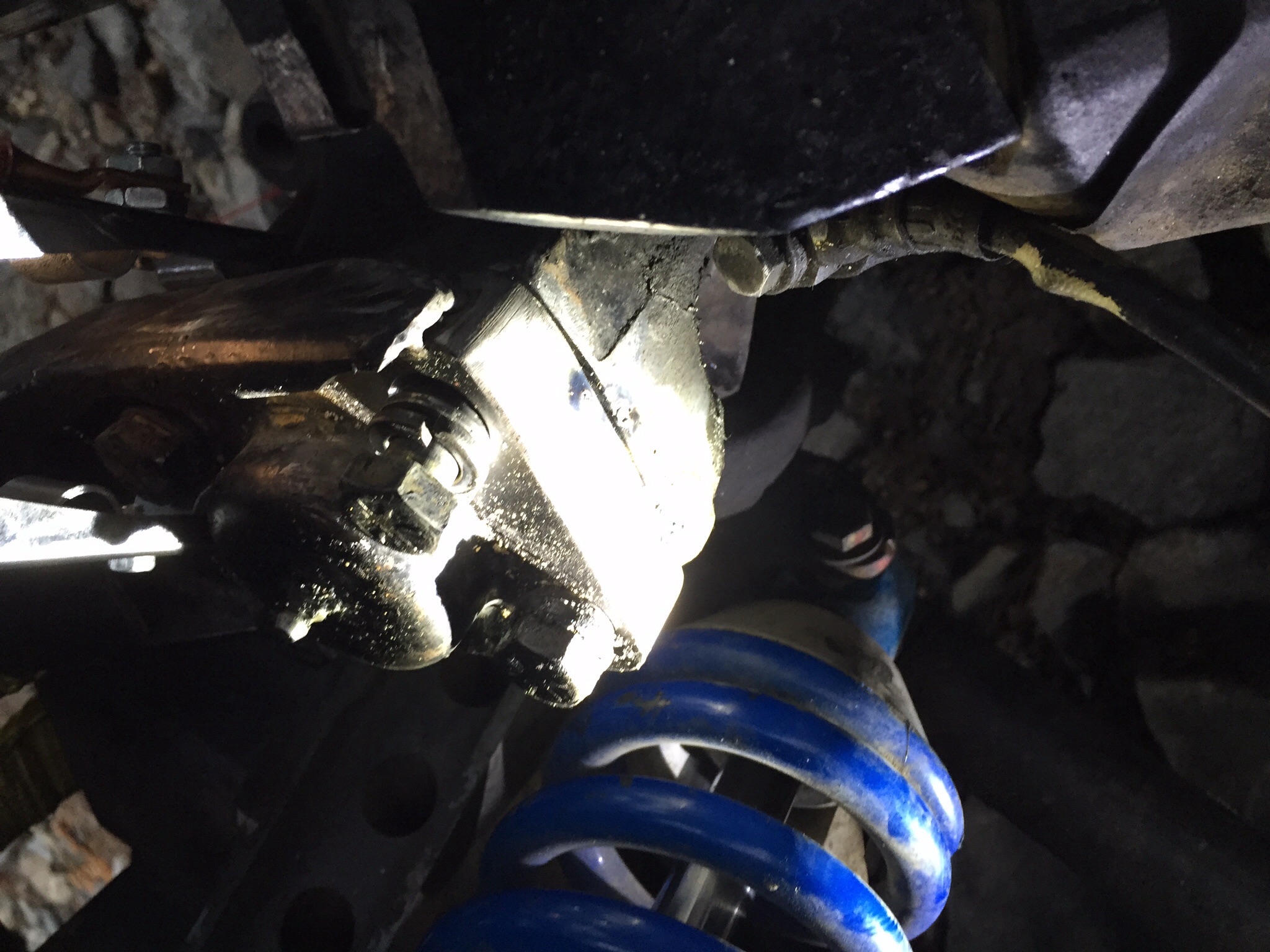

Serge do u have pics of what broke?
Have resources, ready to assist.
Bebe, send me a pm and I will send you his number. From what I know, he's headed up there with the f350 and trailer. The right side knuckle sheered the bolts on the right side

So basicaly upper ball joint plate broke 3 and pulled out 4th bolt.
minimum upper king pin joint needs to be rebuild, broken bolts extracted, possibly replacing knuckle if cant extract bolts.

I have a fab guy who can go on Wednesday. He has parts as well. Good idea to bring the spare knuckle in case yours is fubared.

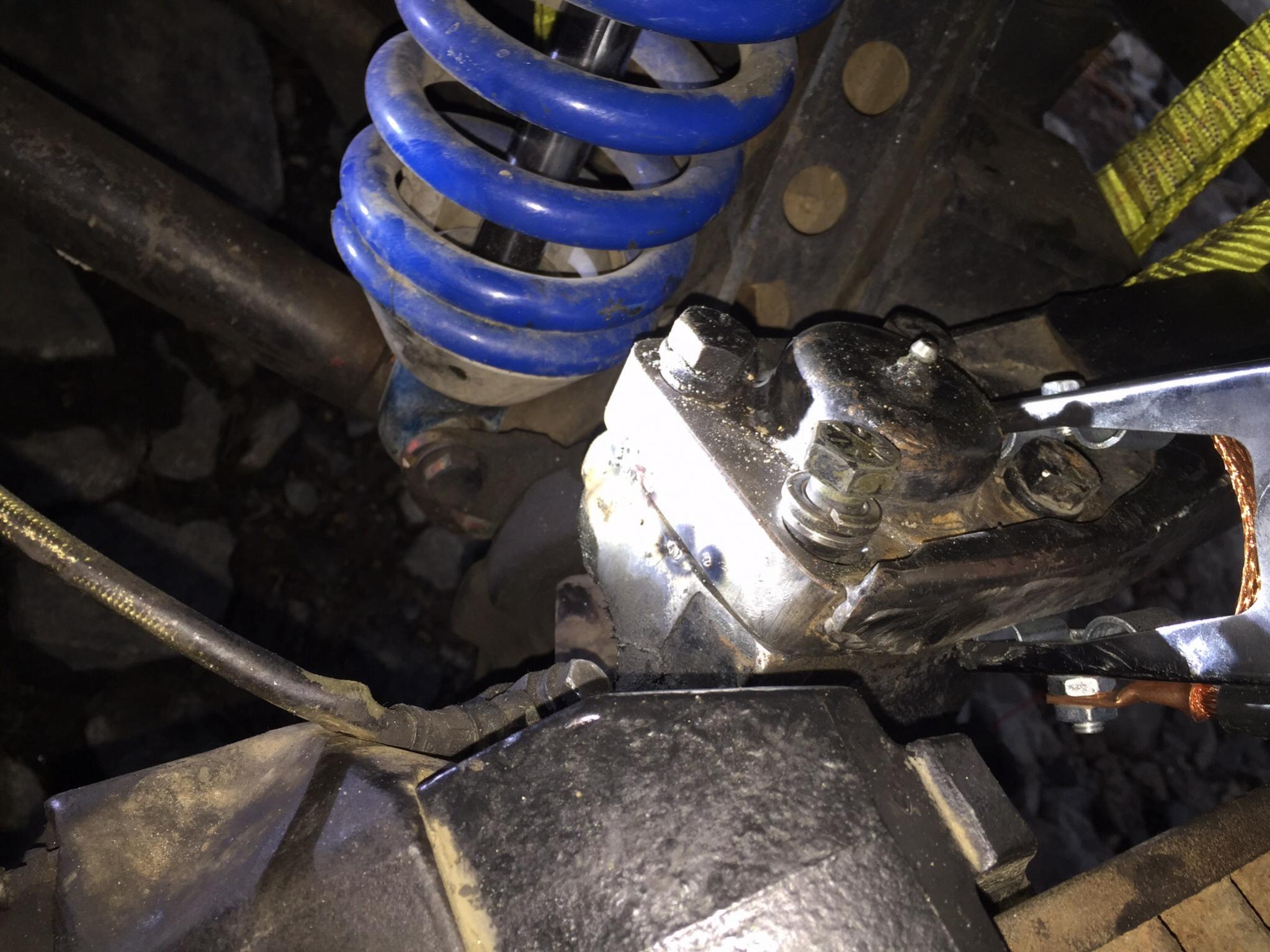

pic is before i tried to weld it, weld didn't penatrate but it will have to be cleaned up with grinder. Also welded bolts to the top plate.
9,506
Welding on the knuckle right? If so and its cast bring a torch. Preheat is important on that but if Bebe has a fab guy coming out I'm sure he knows what to do. I'm happy you made it out safely.

After looking at the photos, I can't tell which will be more time consuming, so I'm sending pics to Brian to see what he thinks.
