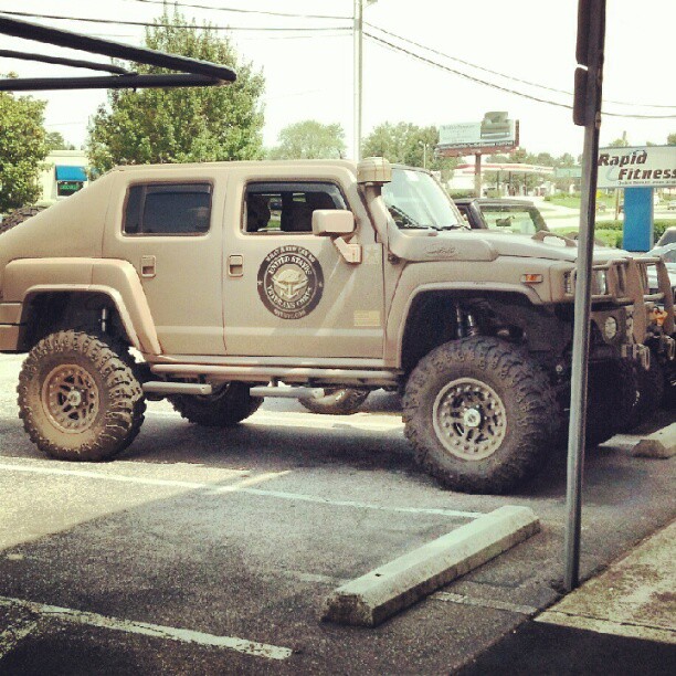

Latest update. The guys at East Coast Gear Supply have had the truck for three days. First swapping the steering ball joints to some ProSteer ones. The original ones were starting to get loose and these are supposed to be bombproof! Diff oil was changed since I had the R&P swapped out about 700 miles earlier. Rear brake hose was also swapped for a longer one. The one that was on there was really a little too tight and I didn't want to risk anything. The biggest thing they did was adjust all the control arms. One to center the 40s in the wheel well, and second to square both axles. Now they're both pointing in the same direction. :D The rear axle was pushed slightly more back than center. This was done to completely clear the plastic fenders pieces in the front portion. Like this, it's only rubbing on the rear ARB bumper. Next step is to remove rear ARB and move it slightly backwards. When this gets done, there will be zero rubbing. Here's a pic ECGS put on their Facebook page when they were adjusting the control arms and checking.
I asked them why they didn't ramp it more since it can do 1100? They said they were scared to roll it. :) THANKS ECGS!
