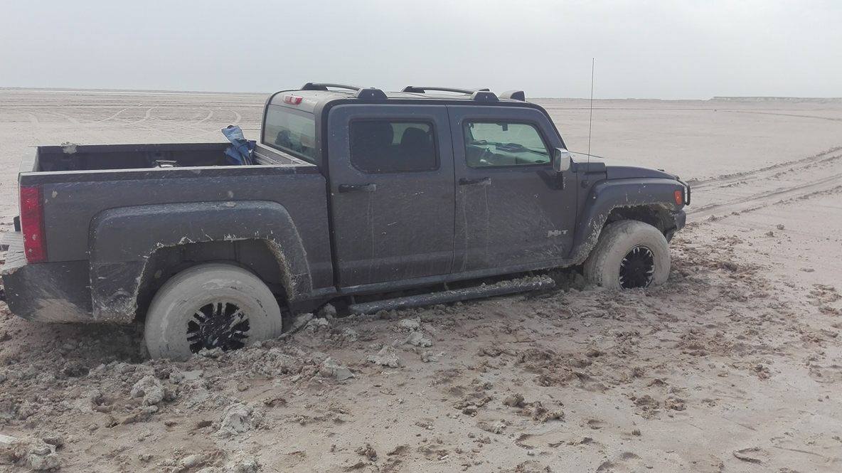

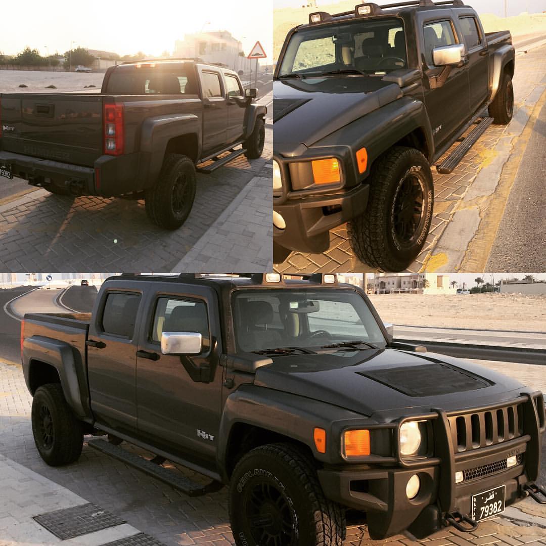

Hello guys i am the owner of a 2009 3.7 Hummer H3T adventure. I am currently living in Doha and I am finally ready to start upgrading my truck. Any ideas are very welcome. Car is stock other than an upgraded headunit and a torsion bar lift.
First things first I need to get some bump stops as I checked mine earlier and they are non existent! next payday I intend to buy some 315/75R16 yokohamas then following that I was thinking some upgraded shocks.
Any guys from/live in Qatar that know any good places to mod your truck? I cant seem to find anywhere so I am going to order parts online..
