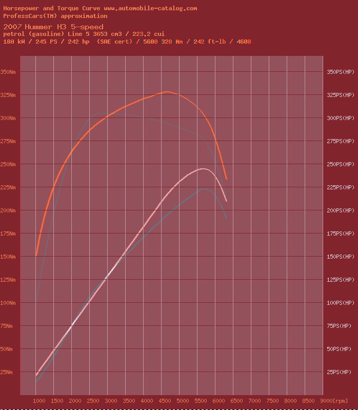

Its strange that the 3.5 is considered such a dog, but it does have more power right where you need it on the highway. Not a lot, but the curves are fatter between 2000-3000 rpm. The 5-speed gearbox also has a 5% lower OD ratio than the automatic (but the auto's 3rd is 1:1, as is the manual's 4th gear). A transmission cooler for the 4L60e should be a mandatory upgrade with 35" or bigger tires, especially in the south, and a PCM tune would be a very wise upgrade as well. There are a few other things that could bump power to help offset the power hit from the 37's like AFE dry filter, intake, header, exhaust, e-fan and ported throttle body matched with the PCM tune. You have removed that restrictive firewall coupler at the airbox, right?
