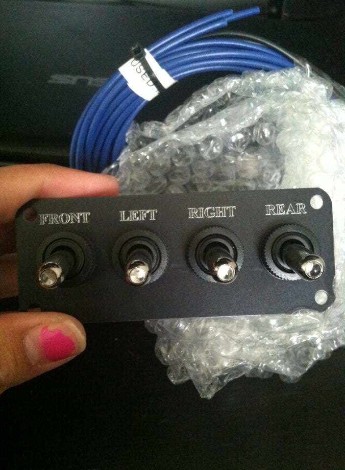

Can't wait to see the set up in person and we can have a side by side comparison when I get all the LED's on and onto the new switch deck.
