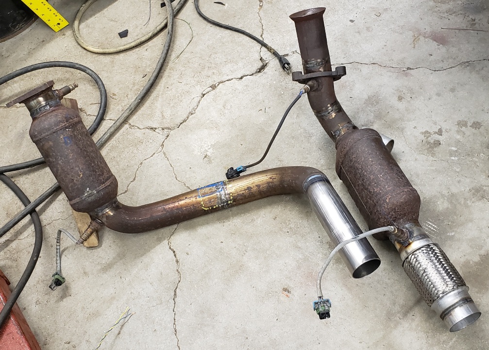

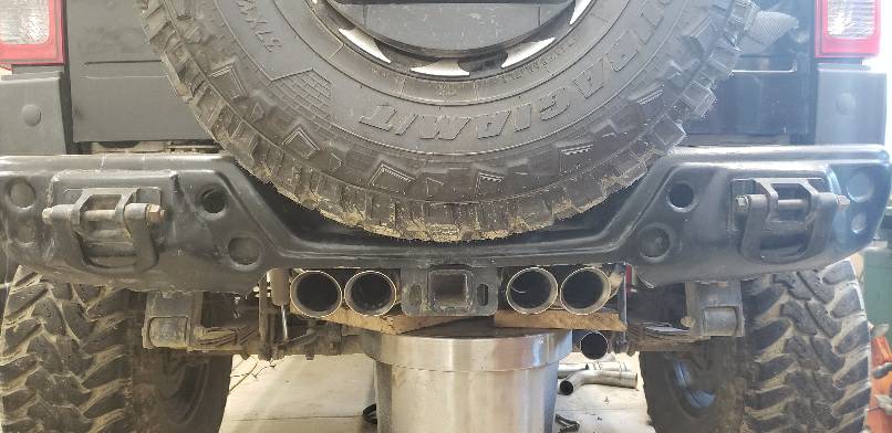

Exhaust is mostly tack welded in place. I will likely raise the exhaust exits up into the bumper in the future if I redo the bumper and hitch but they should work for now. Exhaust is taking a lot longer than expected, hope to have it fully welded with all the hangers in place next weekend. 20210123_194639.jpg

Exhaust is mostly tack welded in place. I will likely raise the exhaust exits up into the bumper in the future if I redo the bumper and hitch but they should work for now. Exhaust is taking a lot longer than expected, hope to have it fully welded with all the hangers in place next weekend. View attachment 27129
Sent from my SM-G960U using Tapatalk
Jimmy, the exhaust tip placement looks fantastic. Kinda reminds me of a Corvette style placement lol. I like how they are high up for clearance.
I looked at my T and I have the hitch support bar going across both sides of the hitch, so this isn't an option for me sadly. Love the look. :cheers:

I really like what you have dine with the bumper as well.
Thanks, i think the exhaust tips are the same design as my old C6, I had the same thought as I was installing them.
