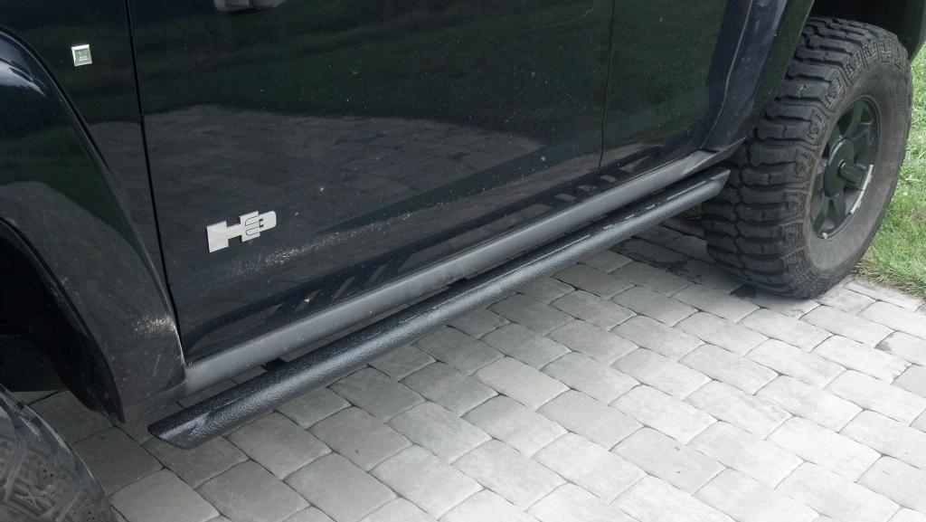

Driver's side slider after I had them Line-X'd.

How is the Line-X holding up on the sliders? Mine is a miserable failure.
Mine has been perfect, although I haven't scraped it across any rocks. It's been on for about 1-1/2 years now, I think. No problems.

Mine did great until the rocks also. Last chance canyon and sleeping Princess made it look bad. Now there are big chunks pealing off. Looks like bad prep job. Line-X offered to redo it for their cost, but it needs to be striped and blasted first.

Portager, Line-X told me up front they wouldn't warranty it. :giggle:

My Line-X wasn't warrantied either, but it should have held up better than it did. The dealer has offered to fix it at their cost but I'm thinking rattle can spray would be easier to touch up.
