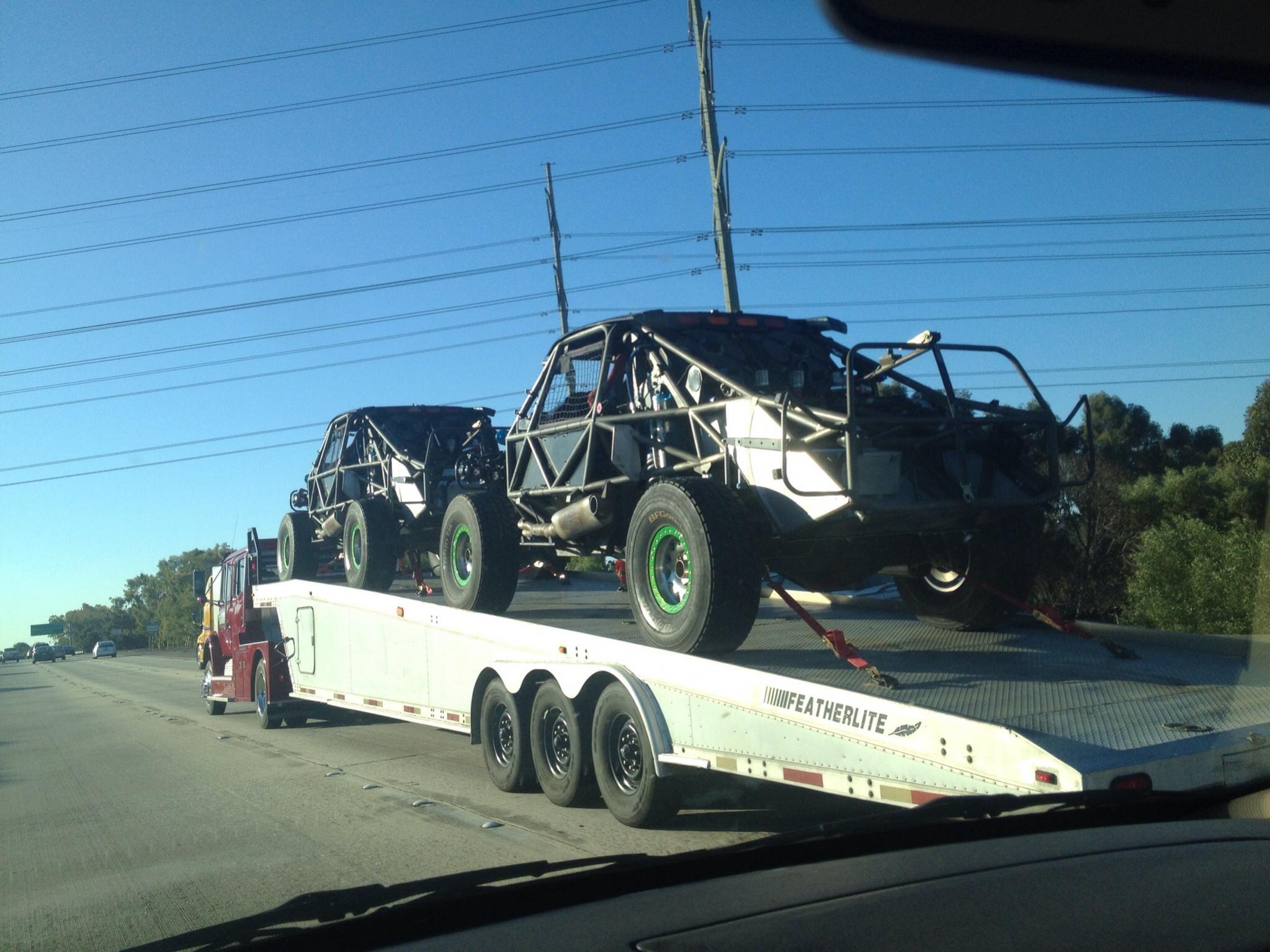

Well it looks like my time to own this awsome truck is coming to the end. If deal goes through I will be giving it to its "new" owner by end of next week.
Mb30sdl
Hamster that pokes Bears
1,588
Raleigh area NC
One word - upgrade, to meet my new needs. But I have a feiling Chris will post before I have a chance. One pic will tell a thousand words.
