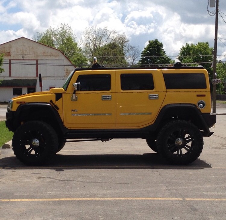

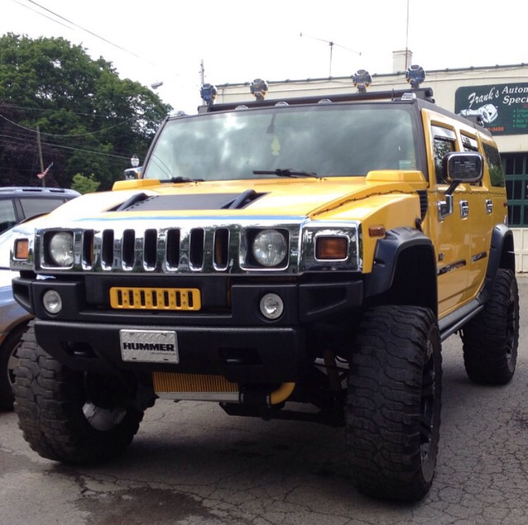

ImageUploadedByTapatalk1417974955.279299.jpg got another pic of it and done info has a 6 fab tech lift i think it said 40' interco tires, 123k miles, 20' rims the fender flare of course... I honestly. Don't know why they'd be willing to go to 16 for this deuce?

It's a 2003 and it was for sale near me 6 months ago for $27,995.
FWIW the dealer is asking $15,000
http://mobile.dealercarsearch.com/V...033&Guid=689a795d-03b6-47a5-8afb-52435eb8a13b
I test drove it in June and there is a reason its so cheap and there is a reason the dealer near me got rid of it and the dealer after that got rid of it (been for sale at 3 different dealerships in 6 months). I advise anyone looking at it to stay away....far far away. It has a $6,000 Pro Charger, $3000 Fabtech Lift, and $2800 set of tires and there only asking $15,000....doesn't add up does it? For good reason

Wow you found it! You test drove it did it drive bad is that the reason you think? Or something else? Because the interior looks great so idk there's def something strange about it.
