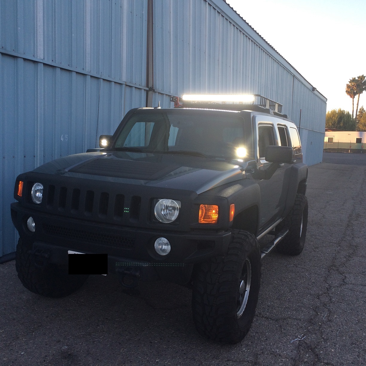

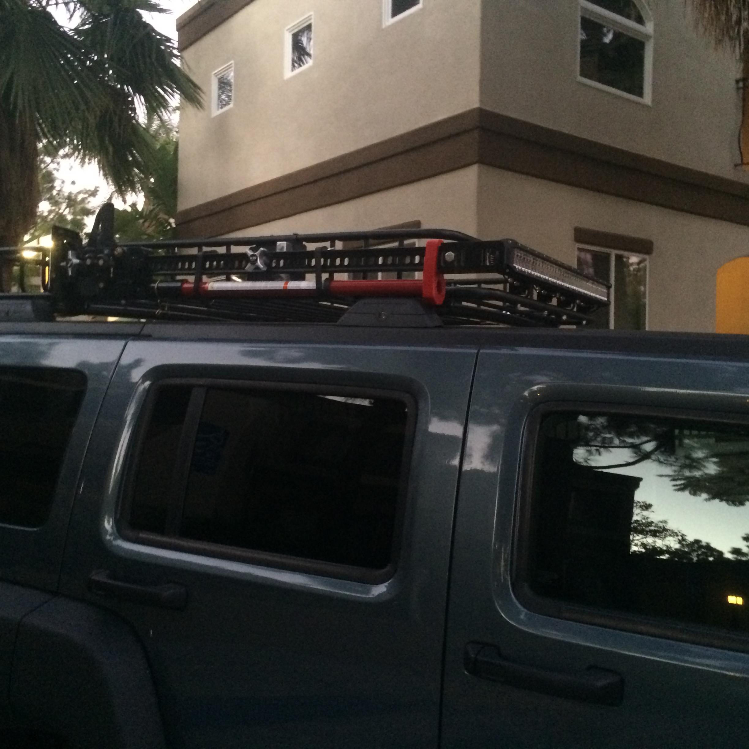

Here is the list iv done...
2007 H3 I5 Auto, State Blue Metallic W/LineX Fenders and grill, Scan Gauge II, Air Raid intake, Cat back exhaust with series 40 flow master, 35" Kumo road venture MT, 17" Ultra Motorsports Rogue Wheels,
2.5 Torsion key lift, 5160 Bilstein reservoir shocks, 2" shackle rear lift. 5165 Bilstein reservoir shocks,
CURT extended roof rack, Hi-Lift jack, 35" Cree light bar, 8" Cree rear top light, 3x3" Cree Pillar lights.

Oh wow dude that is one fine h3!!! I love your tires and it looks like its sitting really high as well! Welcome[emoji106]
