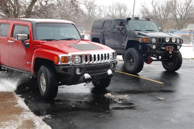

Now that I've logged five thousand miles on the SA, I feel pretty good about the it. It rides firm and handles well on the road. Off-road its downright STUPID capable. In fact...its way more awesome than I really anticipated back when I started it. Even sticking to the mild-end of the SAS spectrum...it came out way better than I ever thought (or wanted). I still got some changes and adjustments to make but, I'm slowly getting the bugs worked out. Here's a pic from just yesterday at a jobsite...
I drove 1-1/2 hours to get there, thru the remnants of a blizzard. I can honestly say there is no other vehicle I'de rather be driving in such conditions. The red H3 pulled in right after me, and the guy seemed to be completely aloof to fact that we had the same vehicles. I said "Nice Truck" and he sort of nodded and walked away...having no clue that I had done anything to mine. I'm still amazed at the number of people driving around H3's that have no idea what a unique and different machine it is from anything else. Jeez.
