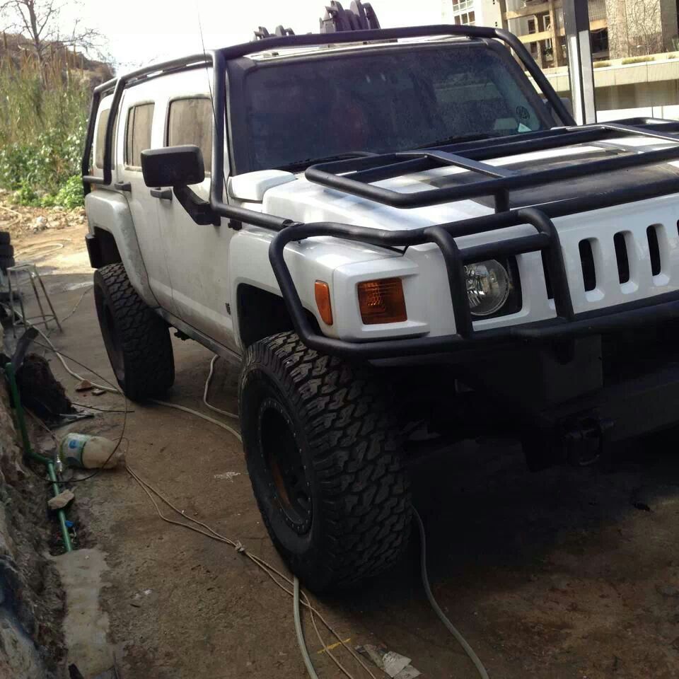

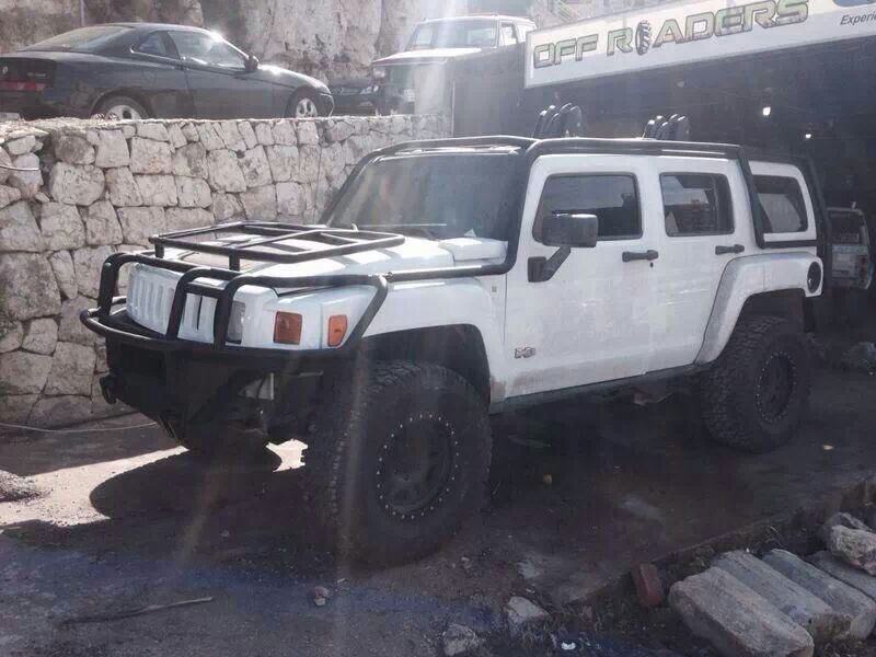

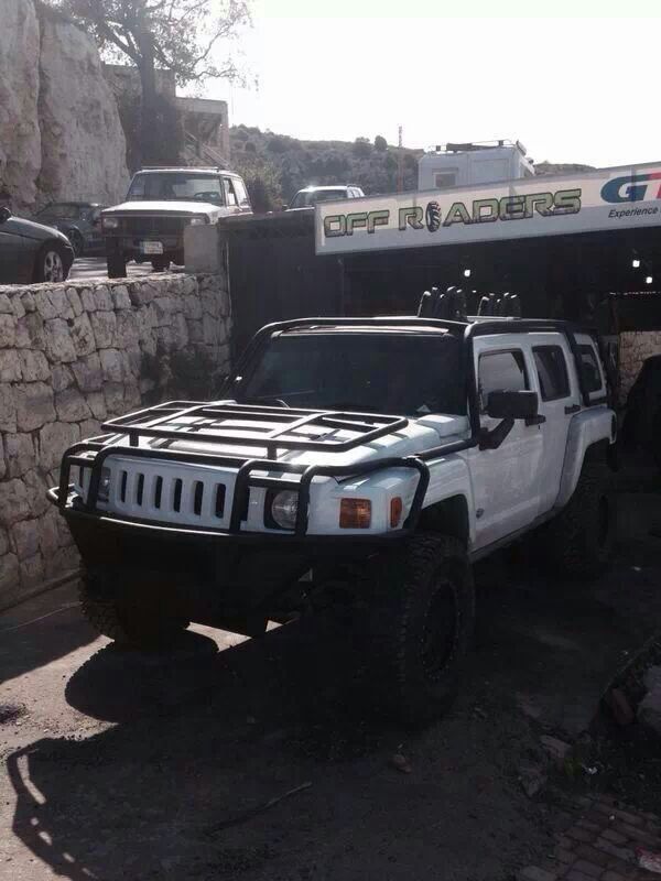

Yeah that one turned out pretty sweet, not quite what I had in mind as a roofrack is in R&D for production
