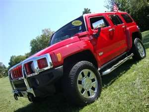

This is what the BG looks like.
Last 2 pix thanks to DAGKANA:

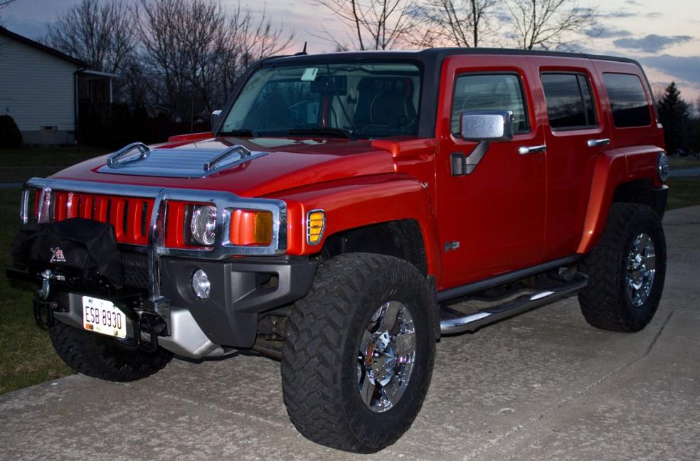

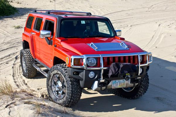

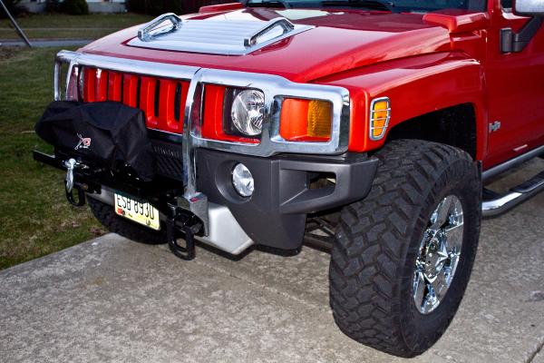

There is actually a couple people that uses winches with the H3X brush guard. Portager has one on his H3T with a DOI mount and there is someone on HF with a CBPhoto mount. Give me a few minutes and I will dig up some pictures.
Portager
1,506
Silverado
As Corey says I have the H3x square tube grille guard (official GM name) and I love it. I'm planning to color match the grille to the truck and eventually when the chrome starts looking BTS (beat to crap), I'll either powder coat it or have it coated with bed liner.
The first two pictures that Corey showed were when I had the fender flares. The next two are without fender flares. The last one is with the Hutchinson double beadlocks and Cooper STT 315/75R16. Not to mention the new step on the RD Rock Bashers.
