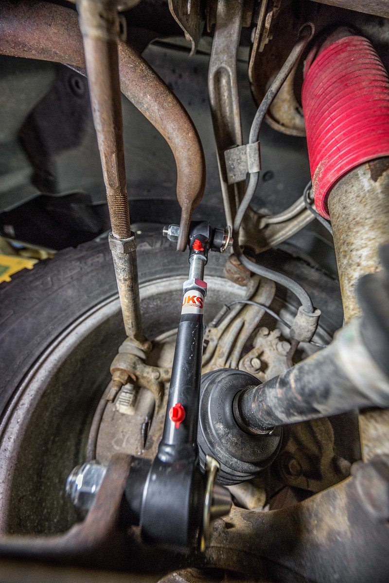

Installed the JKS 2001 Front Disconnect Sway Bar Links. Super easy to install. Simple as lining up the new ones to the old ones
(Cherokee XJ & Comanche MJ, 1984-2001, Quicker Disconnect, Fits 4.0"-6.0" Lift)
http://jksmfg.com/i-13306724-cherok...001-quicker-disconnect-fits-4-0-6-0-lift.html
I needed to buy these extra parts for it to work:
[2x] Offset Polyurethane Spacer (M03212-BK-01)
[2x] 1/2" -20 Nylock Nut (37130)
[2x] Stainless Steel Post (A1046)
[6x] Click Pin (03005)
Had to grease them up!
Done
It looked to me like it would hit the tire if I tried to swing it up.

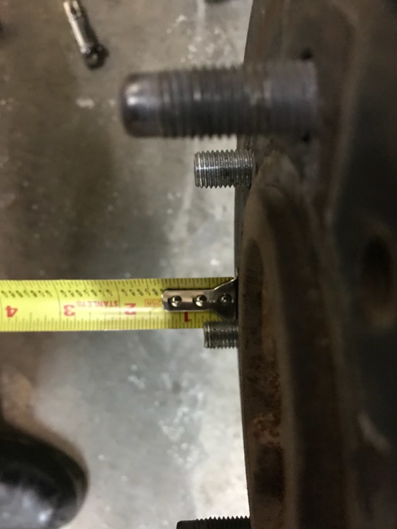

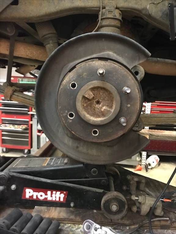

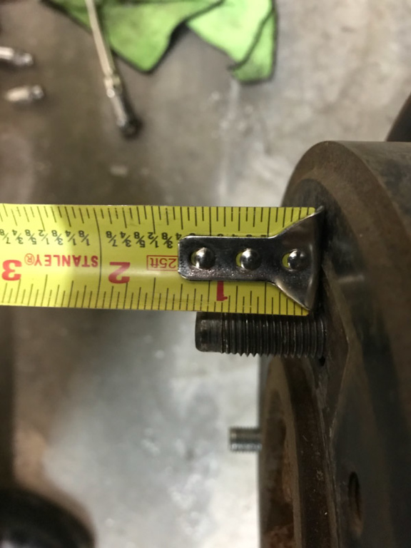

Problems With The Wheel Studs

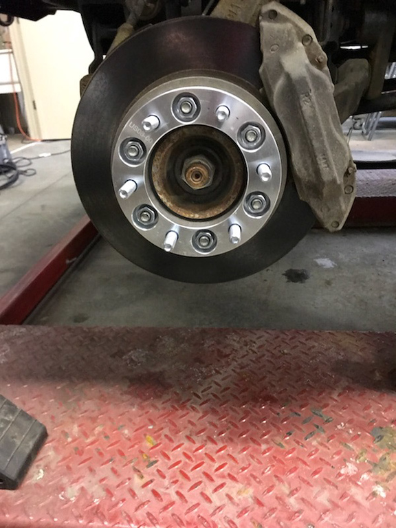

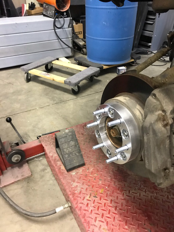

Spacers were added this weekend. Took a lot longer than expected because of more f0ckery from previous owner.
Front ones went on no problem.

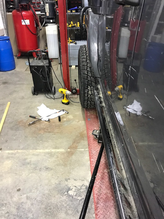

Look what goodies I found when I took off the wheels!

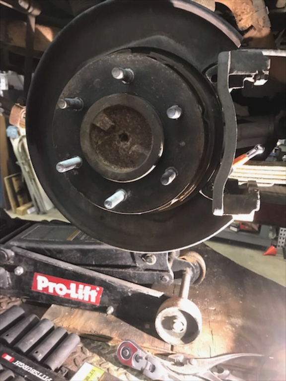

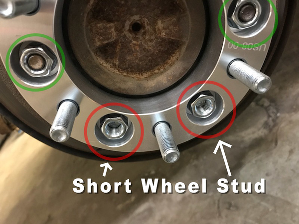

The back were a problem...
Yep... looks like previous owner got some new wheel studs replaced and didn't get the right ones. The H3 has different rear studs than the front ones. Looks short ones that were on there go on the front. I am really glad that I haven't driven this truck over 50mph yet...
Anyways studs were replaced.
And done.
View attachment 23249View attachment 23250View attachment 23251
View attachment 23254View attachment 23255

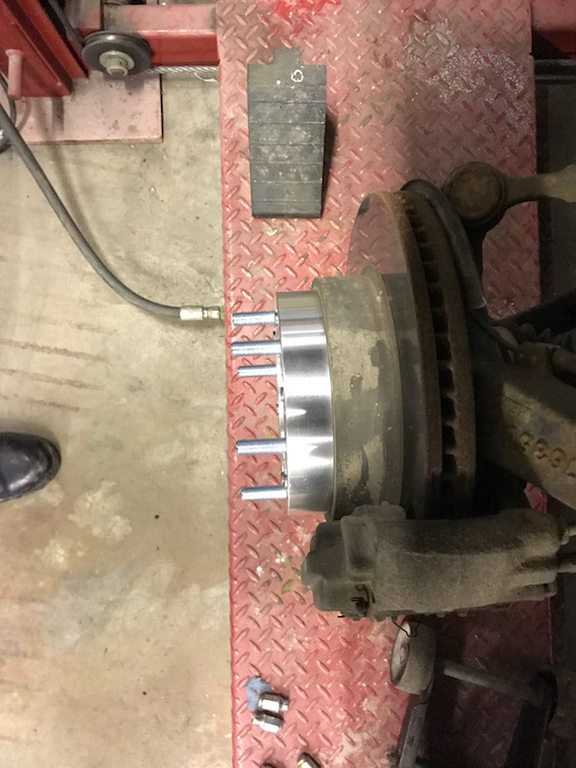

View attachment 23256View attachment 23257
And done.

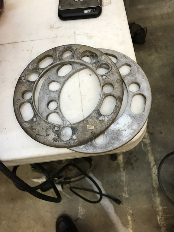

Wheel Spacers Installed
Pic I took of the spacers wasn't too good, so here are two more

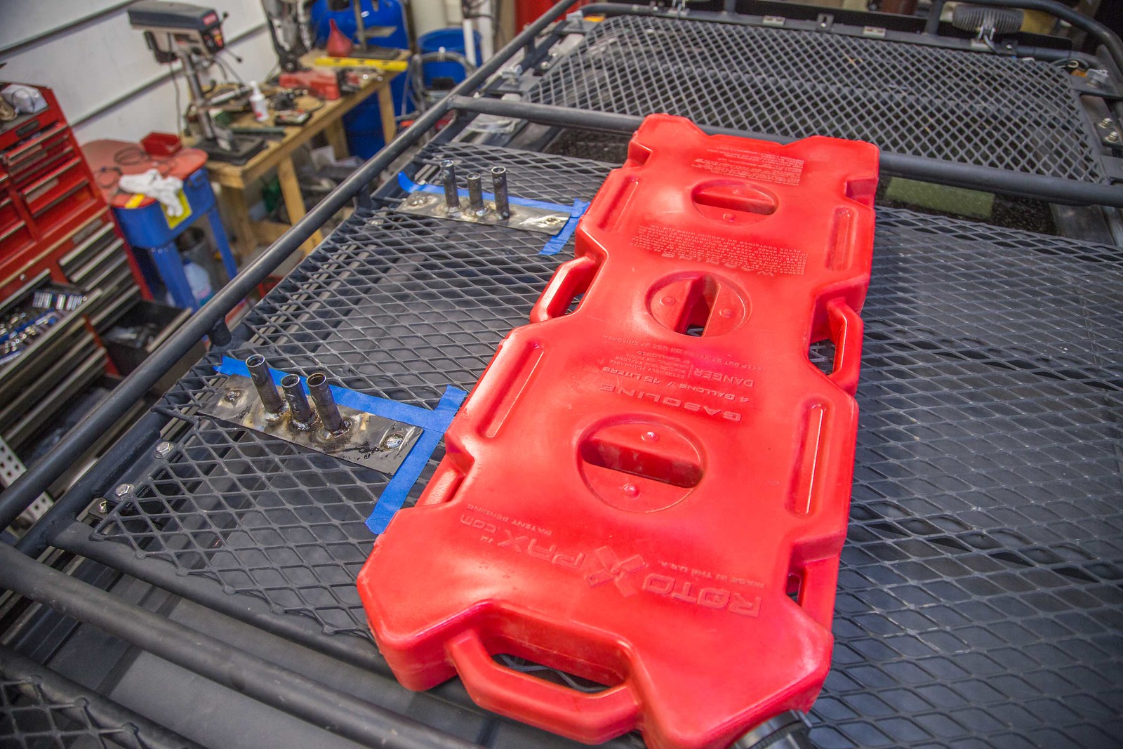

In preparation for the Rubicon this summer I wanted to have some extra gas ready. Got a 4 gallon rotopax, but I didn't want to pay an extra $70 for two mounts, so I made my own.
This is the locking nut I used if anyone is interested
Inside these pipes are nuts that have been welded in place
Lining them up so I can figure out how to connect them with a thread.
Here are the threads on the bottom
Painting them up.
Here is what the final mount looks like. I put wiring loom material around the pipes. Then put a bolt in them to cover them up. I did this so I can screw in another pipe on top of it if I need to run another rotopax. Made a simple custom washer/clamp.

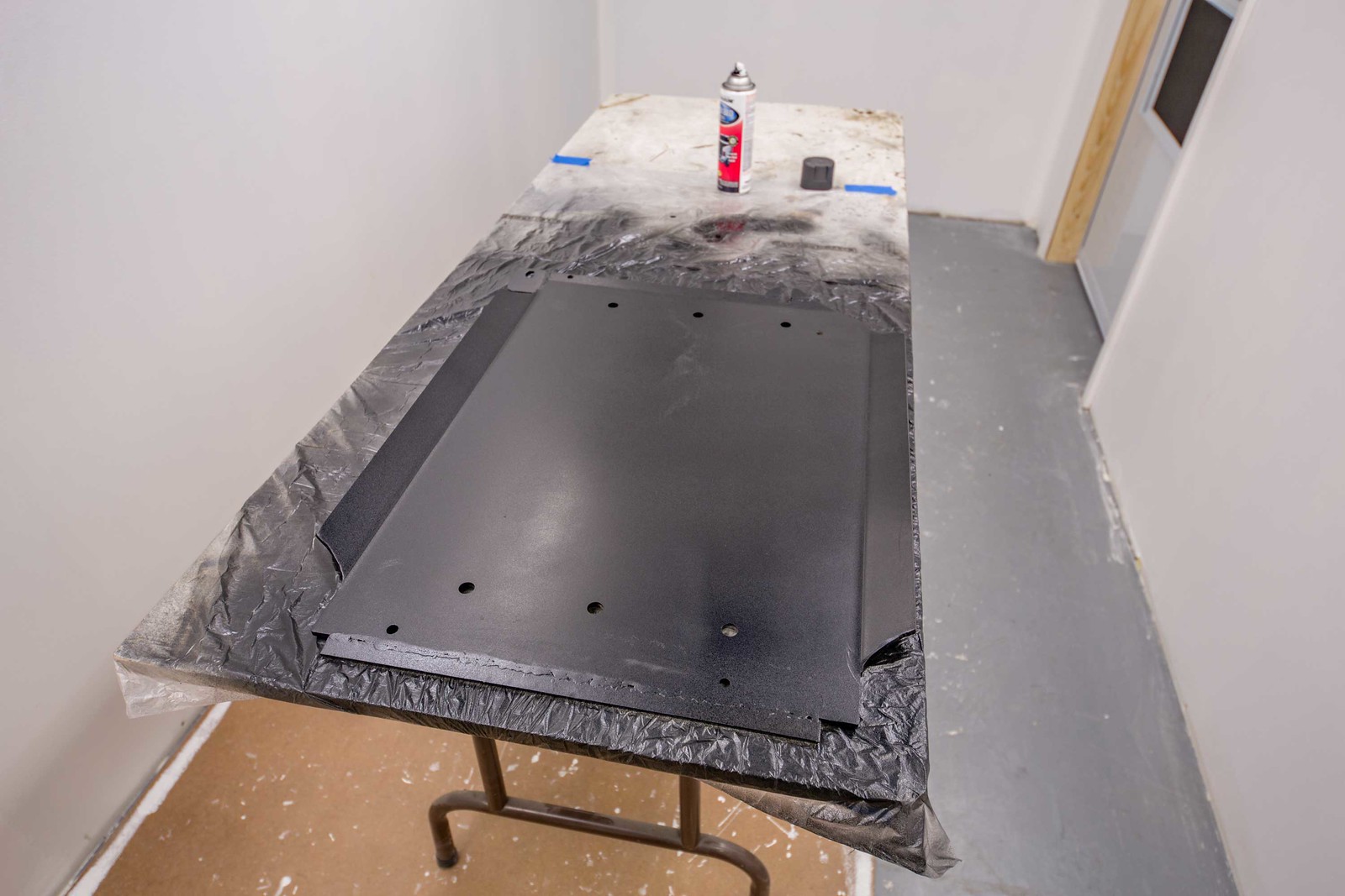

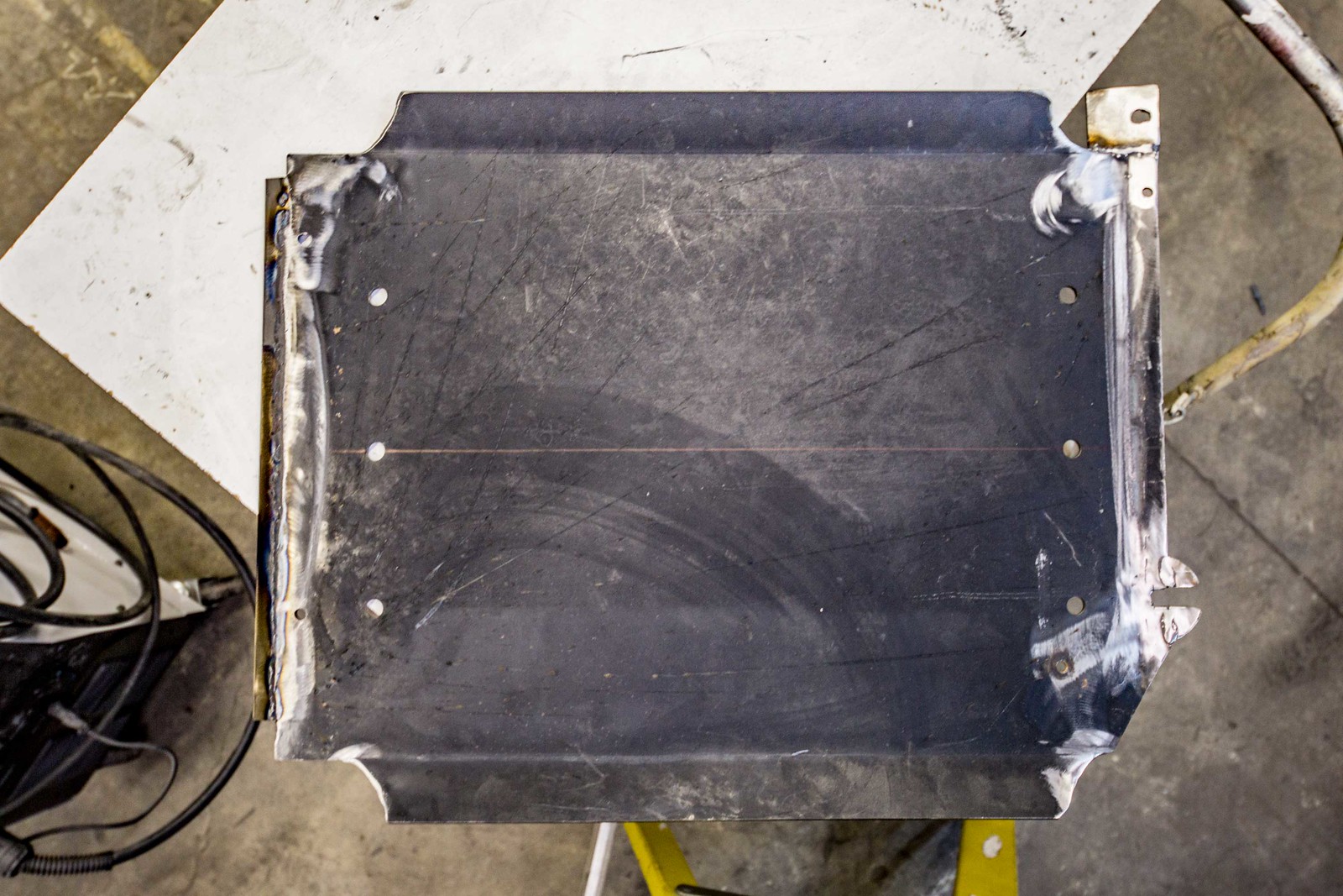

Modifying/Installing Front Skid Plate

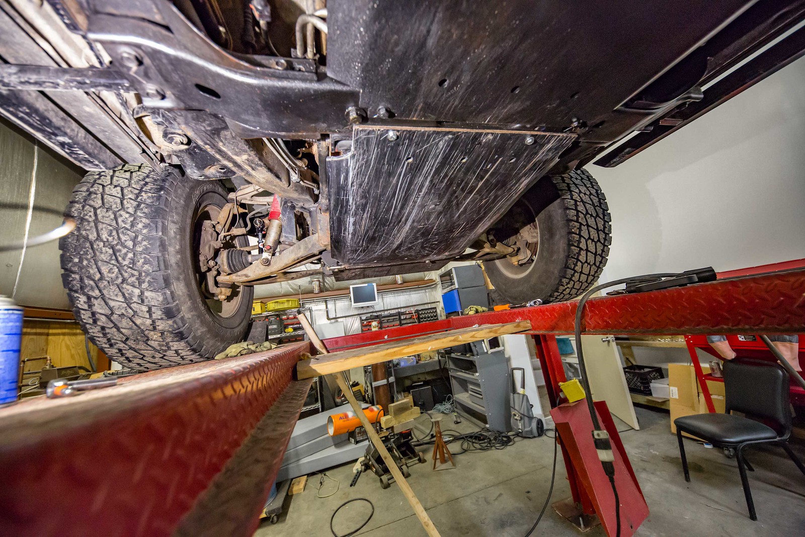

Found a solution to the rancho skid problem: Modifying Schwarttzy’s Front Skid.
Please note this is experimental and hasn't been tested yet. Try at your own risk.
Since the rancho cross member sits lower than the middle cross members, I had to bend the skid. Cut it half way through to make it easier.
Used iron 90 degree thingy with some c-clamps to bend it.
Was able to use the the one rancho skid bolts in the front to mount it. Still needed to back rear holes though.
I did have to add this piece to make use of the other rancho front skid bolt.
Drilling some holes on the crossmember for the rear.
Boom! It fits perfectly!. After taking these pics I did add a little piece to cover up the gap between the front and rear skid.
I did have to do some cutting on the angled part of the skid since the rancho links are in the way.
Acer4LO
Illinois
Here is the final skid. Only cutting and bending that I had to do was on the edges. Pretty simple to do overall. I think I like this idea better than welding mounts onto the Rancho links and then attaching a skid plate from there. This way the skid plate is sitting on the crossmembers instead of the links which I have heard are weak.
Haven't had time to put them on this weekend. I'll will do that when I get the time and post pics.

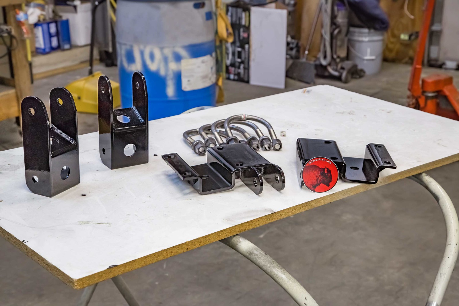

Leaf Mounts Arrived
So excited that these just came in!! Can't wait to install them! Thanks so much Schwarttzy!
