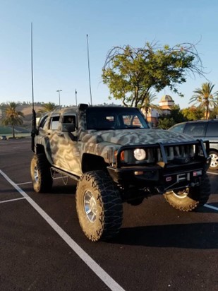

2. Next up the Bully Dog build. Featured a Duramax diesel, atlas, and dana 60s.

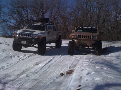

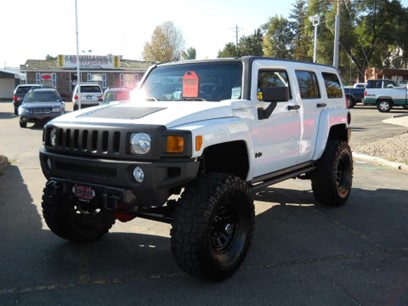

3. Next up is the infamous recon h3 slant back build. Fairly certain everyone has seen this build.
2008 H3 alpha, built by offroad evolution.

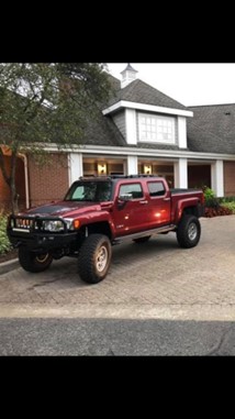

4. Also done at offroad evolution, the first SAS H3t.

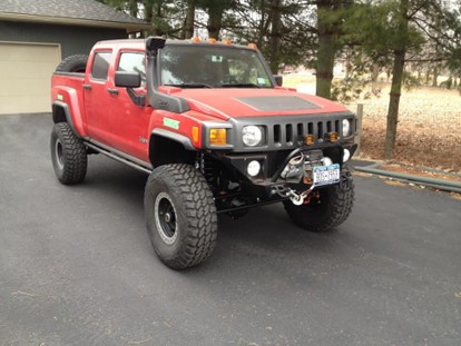

5. CJ (@4speedfunk ) started pioneering the low buck junkyard axle builds, with his being the guinea pig
DIY, ABS working, 3 link, coils, GM dana 44.

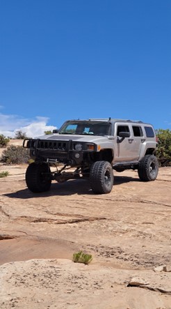

6. Next up is the infamous @06 H3 aka squeaky, sporting the THORparts DIY kit.
This build as we all know has changed a lot over the years. Currently on a kingpin Dana 70, Eaton H072, 3 link F/R, coilovers, NP205 w doubler, etc

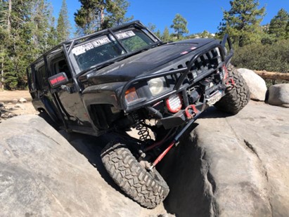

12. Ricks black H3t, started with a THORparts DIY kit. Dana 60s, coilovers front and rear, 3 link front, 4 link rear

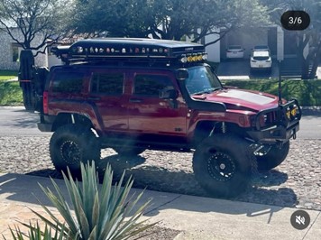

#7 is Dana 60 h3 on this forum
#8 was owned by the social media “influencer” themanspot. He got divorced and sold a bunch of stuff, now that h3 is in eastern Idaho
