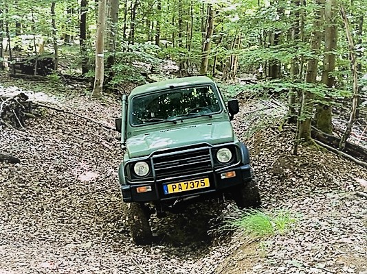

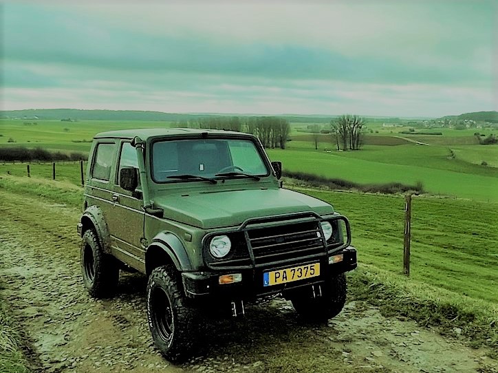

1.3 i with 70 HP, enough for it, 4.16 T case , 2" full lift kit from TrailMaster, 235/75R15 BFG's AT KO2, UCP from MasterForest, winch, Homemade snorkel, Optimal Yello batterie and Honda CRX MK2 seats . Love those Samies

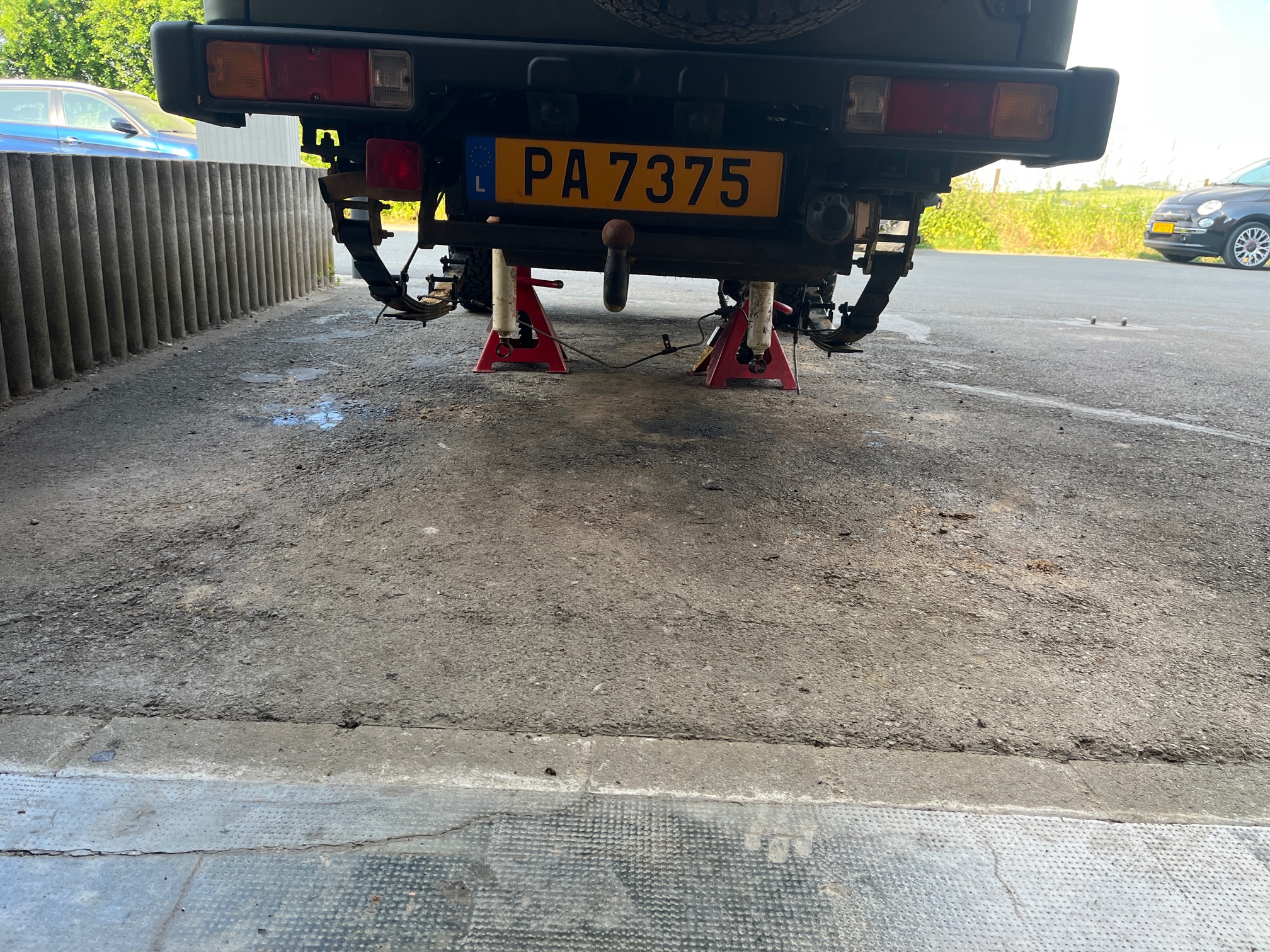

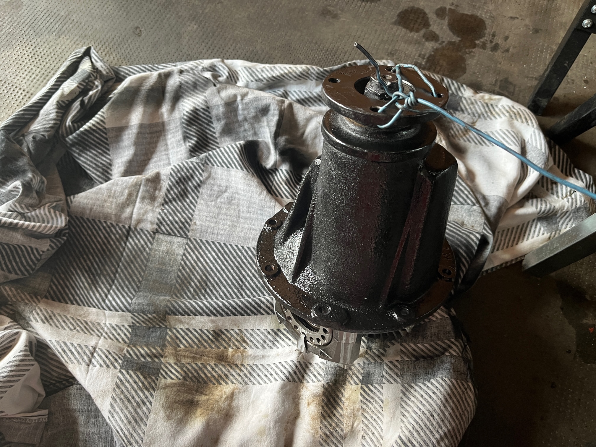

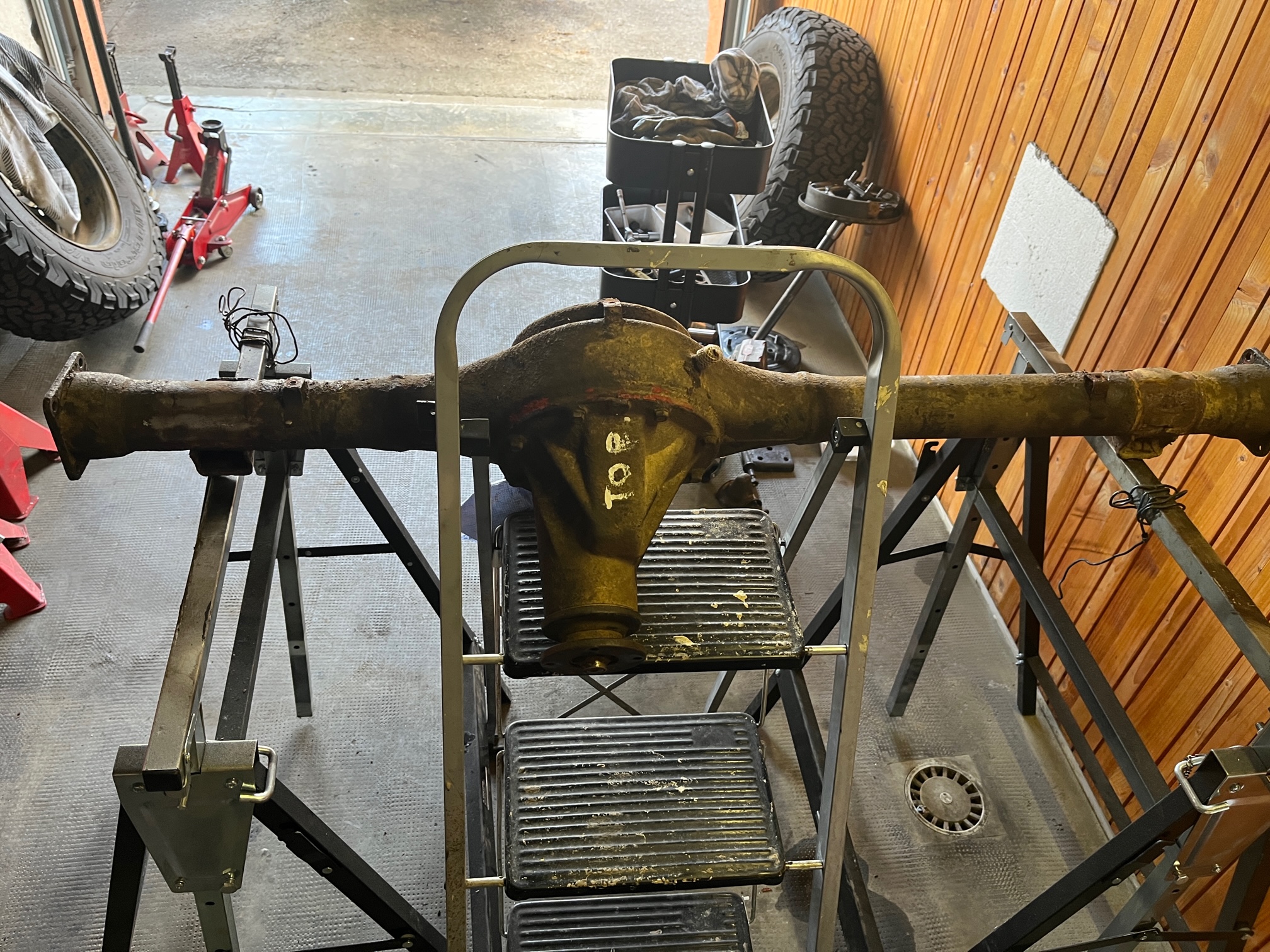

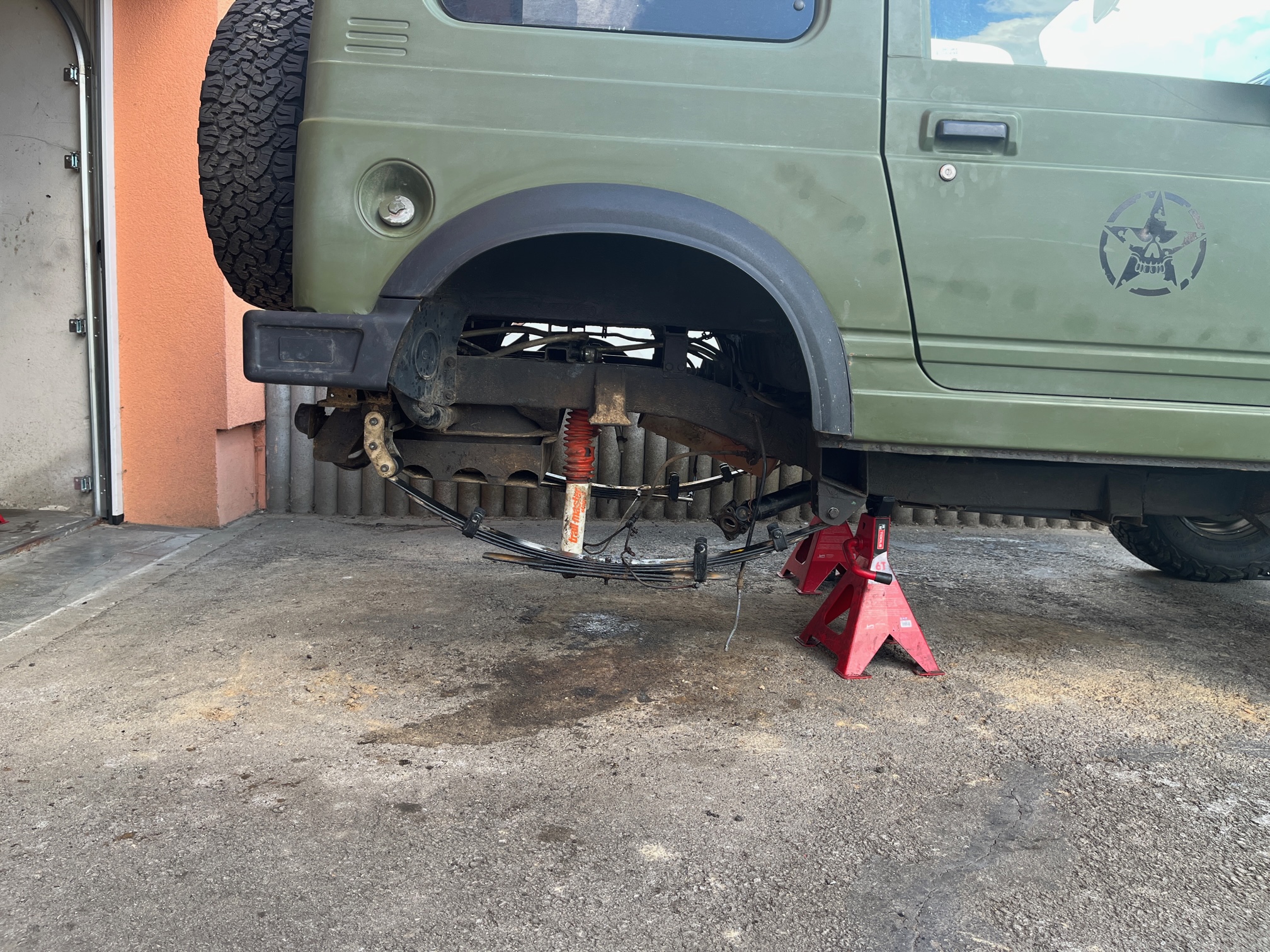

new solid axel need, old one is damaged at 2 places and leaks oil.
MasterForest FRANCE will send it to me . Thill then, get axle off, cleaned , brushed , checked and repaint the diff...

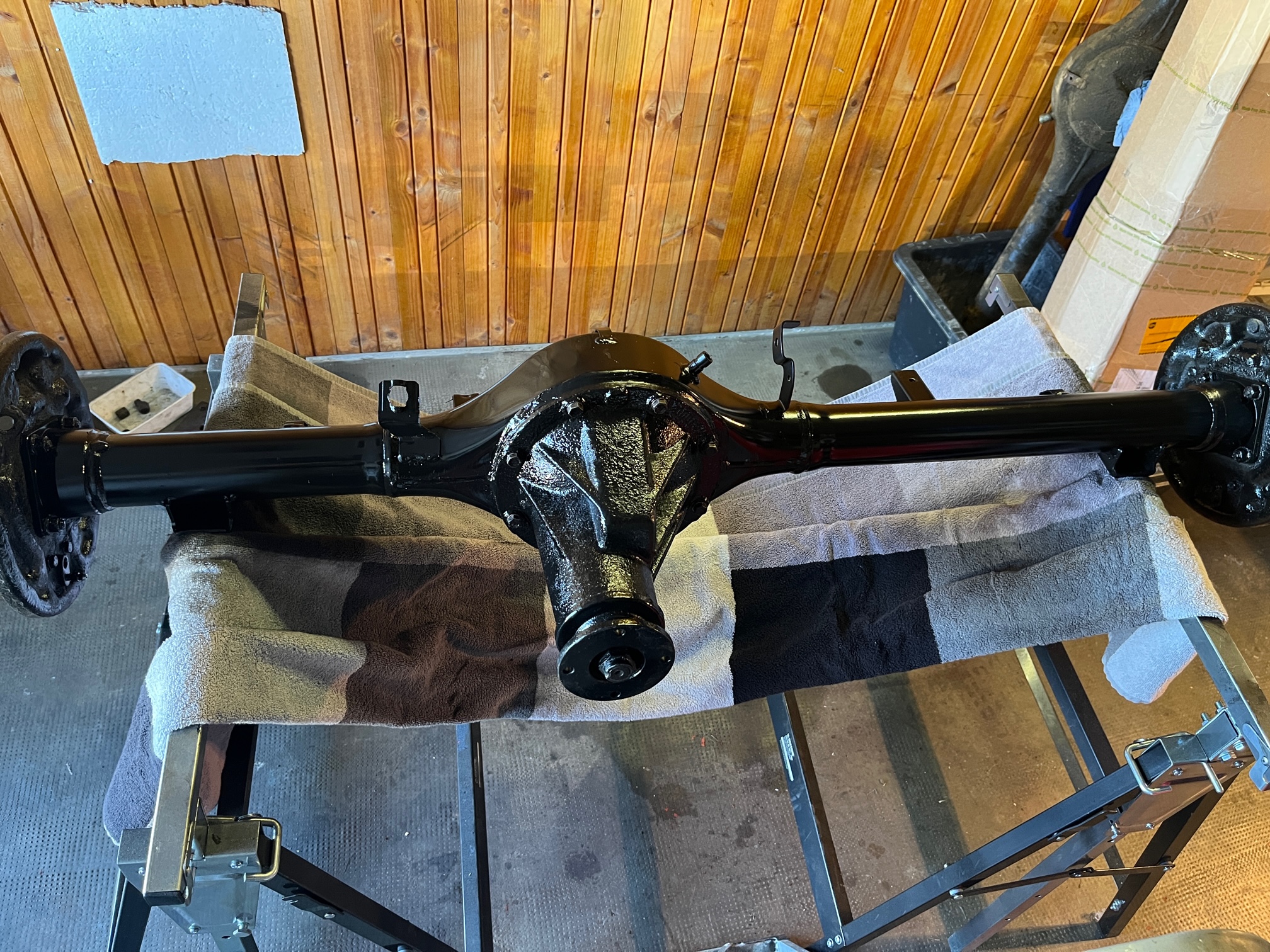

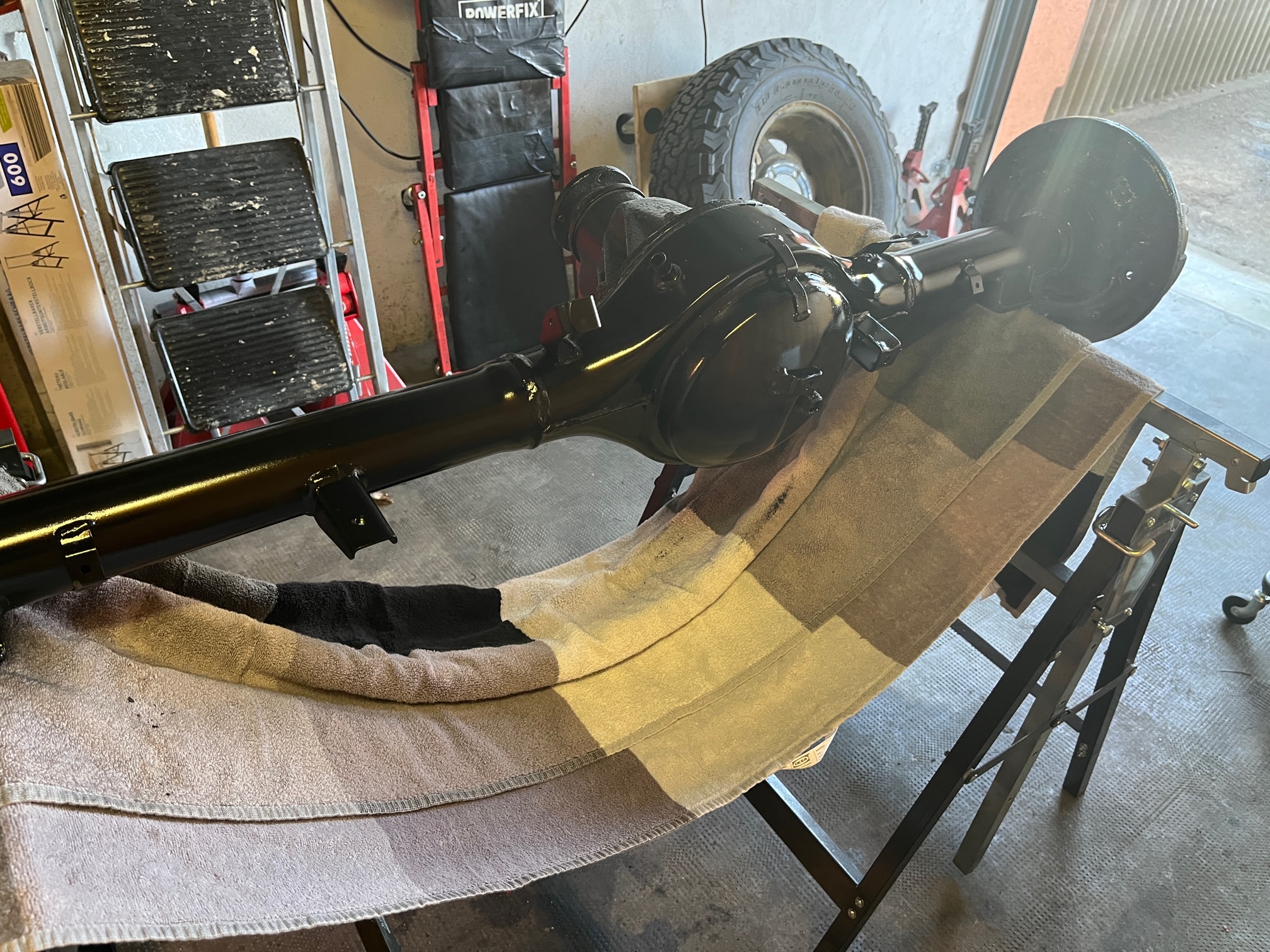

So finally the new Axel came today, did already fix the diff, the seals and their half shaft Axels back in.Waiting for the Diff-cover sealant to dry out ( the Right Stuff ;) ) and then filling the oil in.
To protect the axel better, gave her 2 coats of Hammerit ( like Rustoleum)
Soon , Sami will be on the trails again
