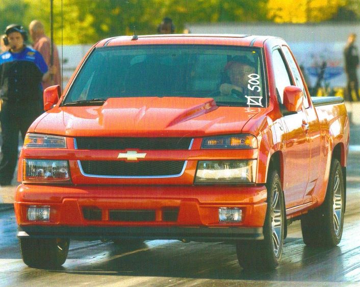

They made a bunch of 09 -12 5.3L Collys and Canyons. Many of those owners are customers.
The 2WD versions with some tweeks can haul azz, like this customer at Milan Dragway!
Just sayin......... Back to your regular H4O programming.
