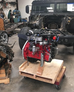

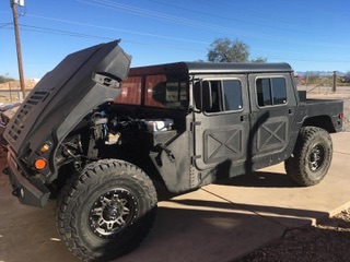

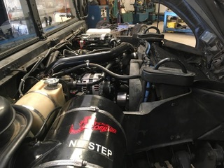

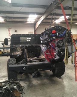

Preferred Chassis Fabrication recently repowered a customers M998 with a Cummins R2.8. The 6.2 had a ventilated block. This Repower conversion allowed the body, body mounting and drivetrain to remain stock with only minor modification to the transmission, transfer-case and driveline placement.
Performance is impressive and interior noise and vibration is severely reduced. And you can carry on a conversation while driving. A major benefit is that it is getting 20.8 mpg.
