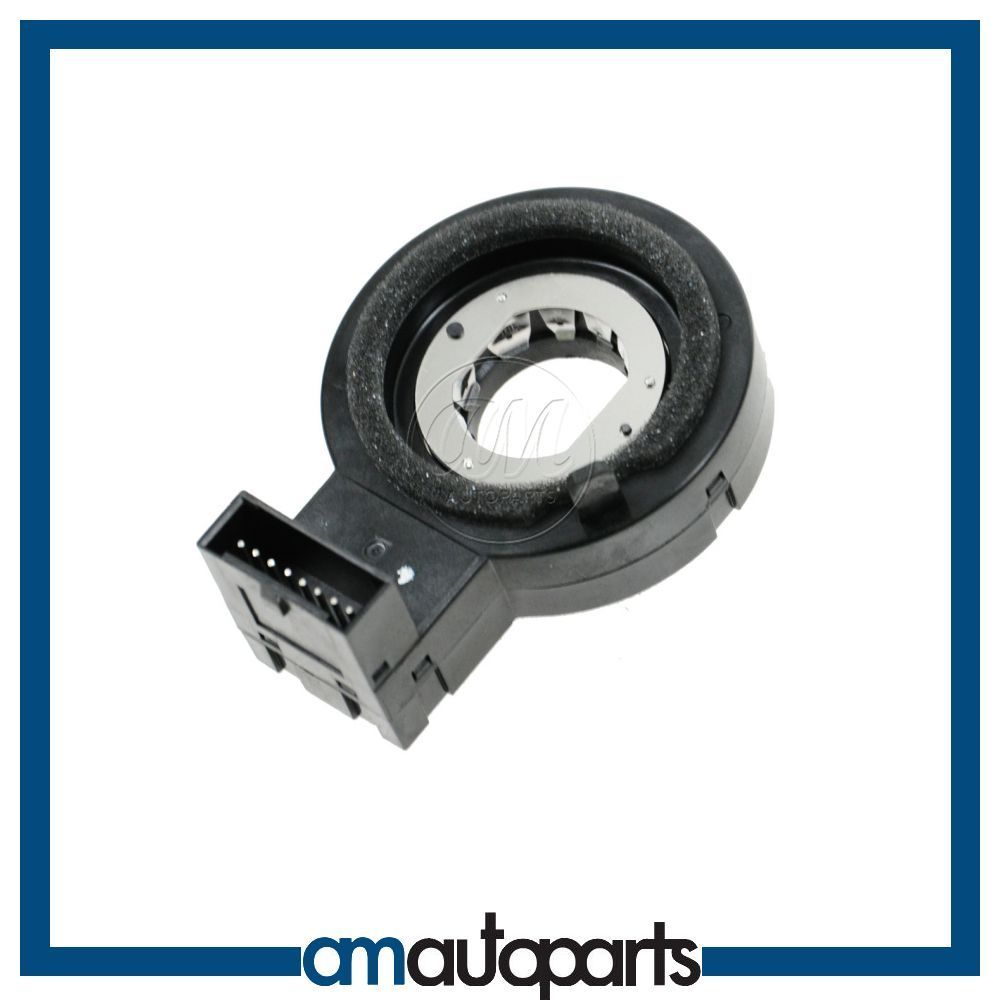

    However, if your steering wheel is centered...the code can be caused by the steering wheel position sensor itself, especially since the code is intermittent and seems to be tied to the outside air temperature. Do you park this truck outdoors? The Steering wheel position sensor is a little gizmo at the base of steering column, just inside the cabin. It uses magnetic "hall effect" and works just like an ABS sensor out at the wheels, and it sends a signal to the computer. Its possible that it has been kicked, bumped, or its just plain worn-out. Check the connection on it first...that might be all it takes to fix it. Here's what it looks like:
    Name:  wheel sensor.JPG
    Repairing...
    Changing this critter is a tad complicated...you have to pull the entire column, (it installs over the end of the steering shaft). Its not hard to do...just very tight working space under there. YOU MUST CENTER THE WHEEL AND LOCK THE COLUMN before you pull it. A new sensor costs about $90 and it comes out of the box "pre-centered" with a lock-pin installed in it. Only after you get the new sensor installed (on the bench), and the column back in the truck, can you pull the lock-pin out. Its very critical that the front wheels, the column, and the steering wheel are all in the proper "centered" position when making this repair. Some people may try to tell you that it can be "re-calibrated" via the Diagnostic port. That is total b.s...it must be hard-swapped with a new sensor. Check the connection to it first. If you still have problems, this may be the cause.
