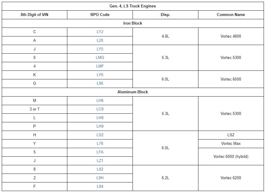

Is there an easy way to tell what gen the motor is. VIN or number stamp on the motor. I haven't yet bought the motor and was looking at a couple 5.3 out of a wrecking yard here until my friend said they may have an 03 suburban that has a good 6.0 motor and good trans (it was in a roll over so the body is toast).
Just find a 6.2 and you will be good to go
