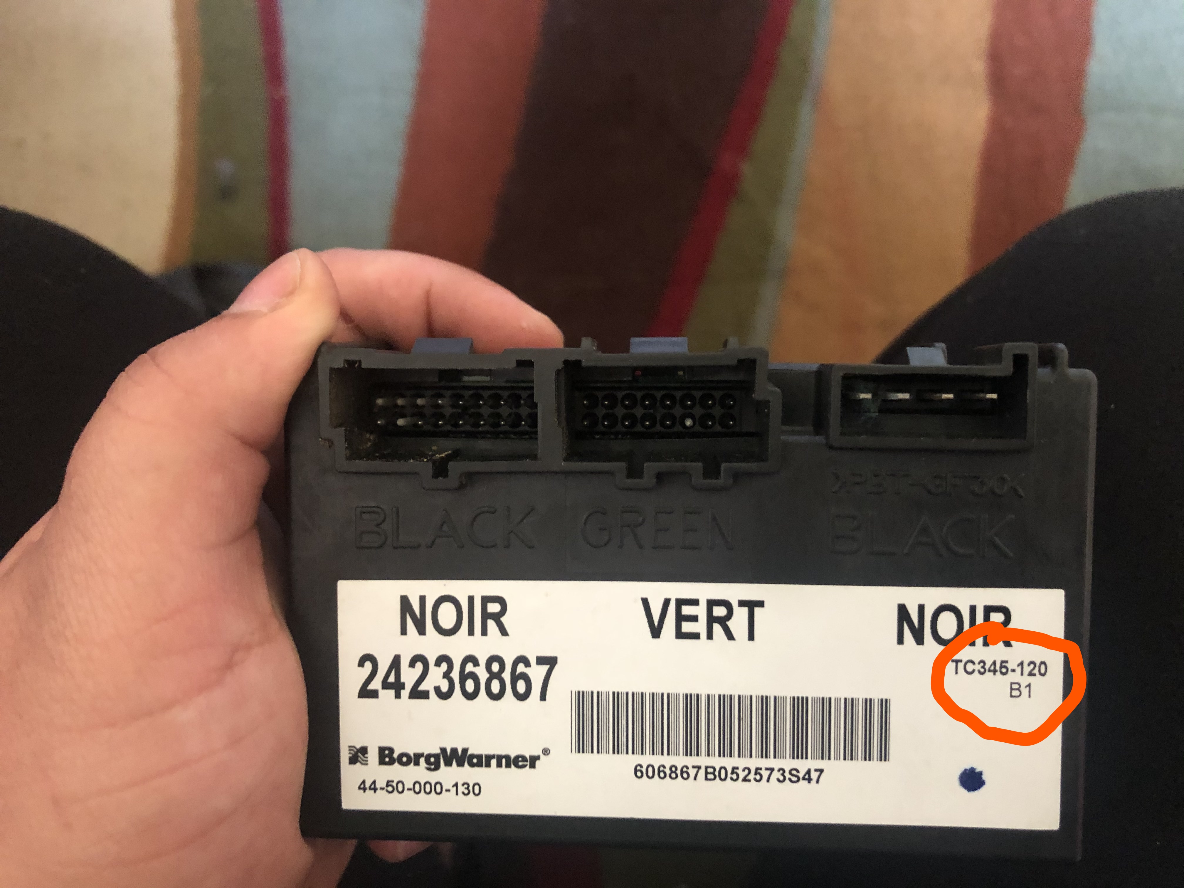

Hi guys, the TCCM of my H3 went bad, The service track failure message was showing and I was reading that it was a common problem with the H3s.
4WD option was not working but after I cleaned the TCCM it started working again but stopped working after I selected any 4WD option.
There was dirt and water on it.

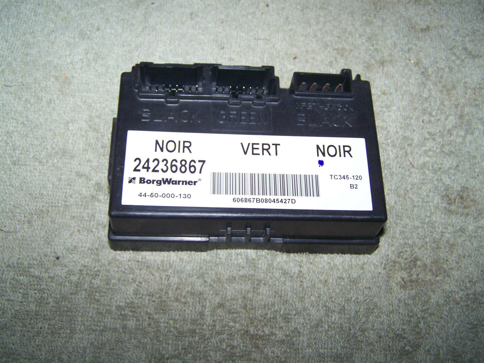

I need help finding the part, is there any difference between B1 and B2? Any place I can buy the right part? I appreciate the help, thanks!
This is the TCCM from my 2006 H3 Adventure B1
This is the one I found online B2

It has the same part number. Should be good to go. Assuning it does not require dealer programming like a BCM does. Plug it in and see if you can operate as normal. You can get the part from any online GM parts store, rock auto, GM dealers etc. Rock auto will probably be the cheapest

I have an 06 tccm sitting here you can have it. Just cover the cost to get to you.
Worked when boxed up, as far as I know. Worth a try?
