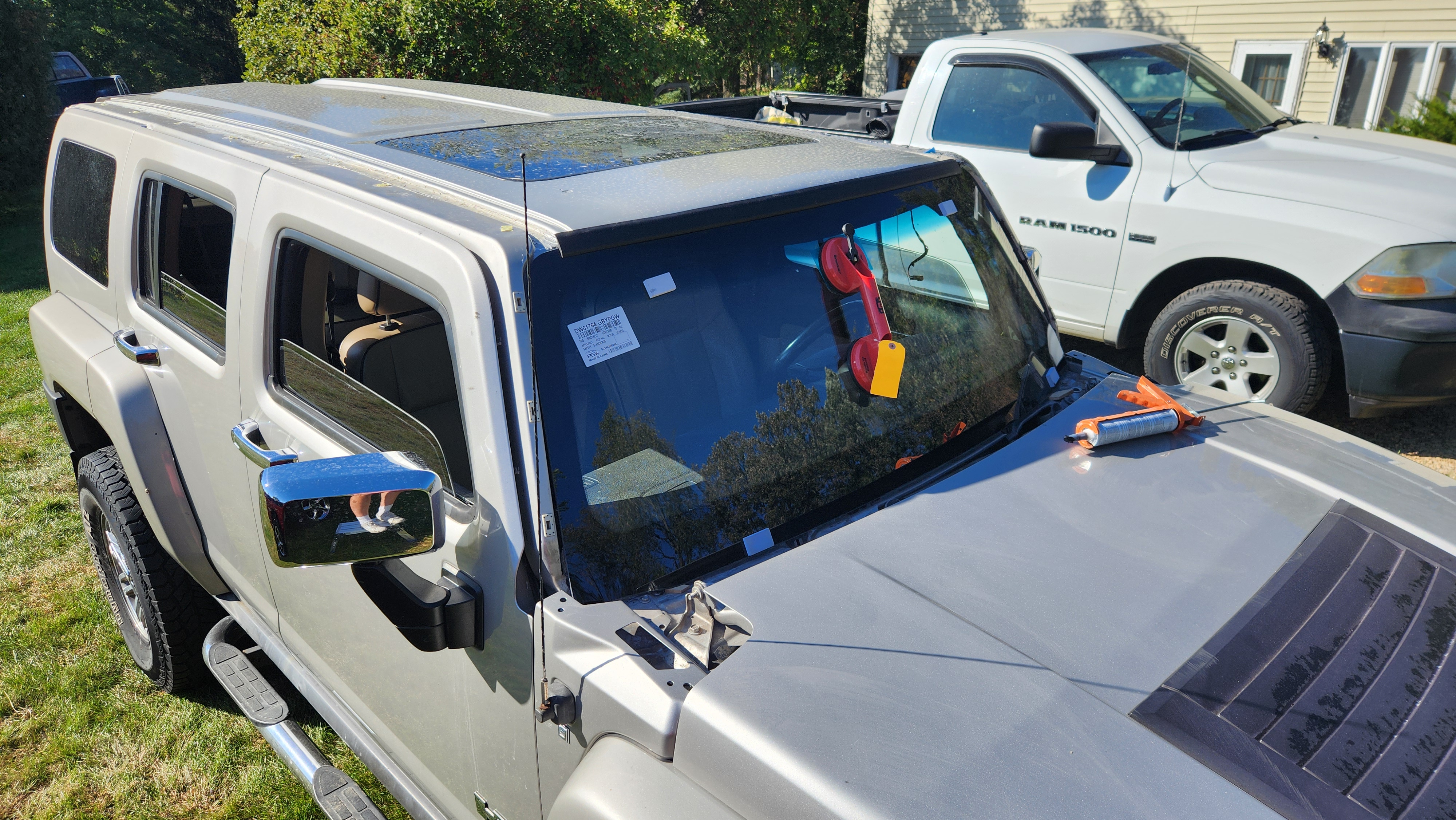

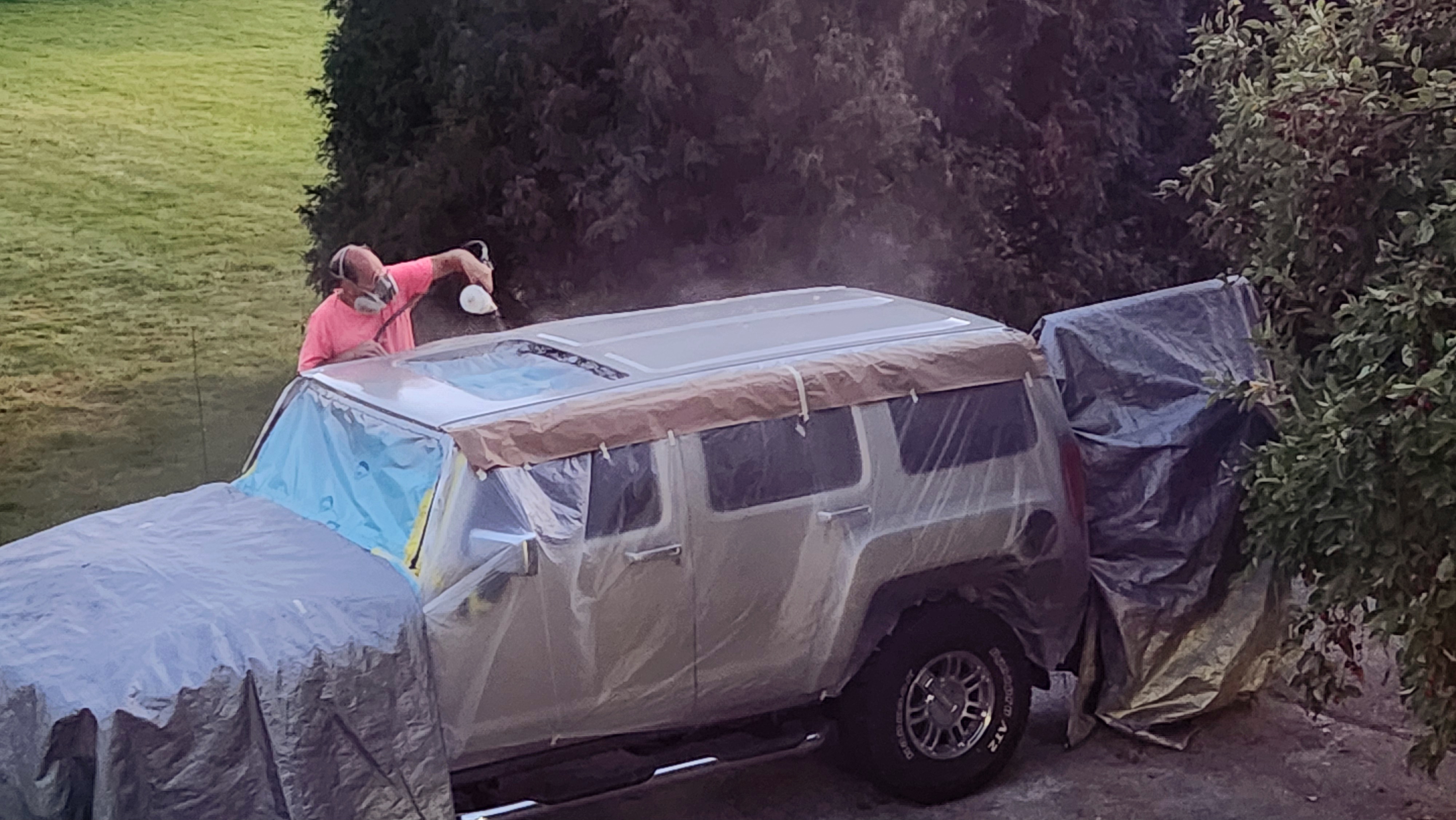

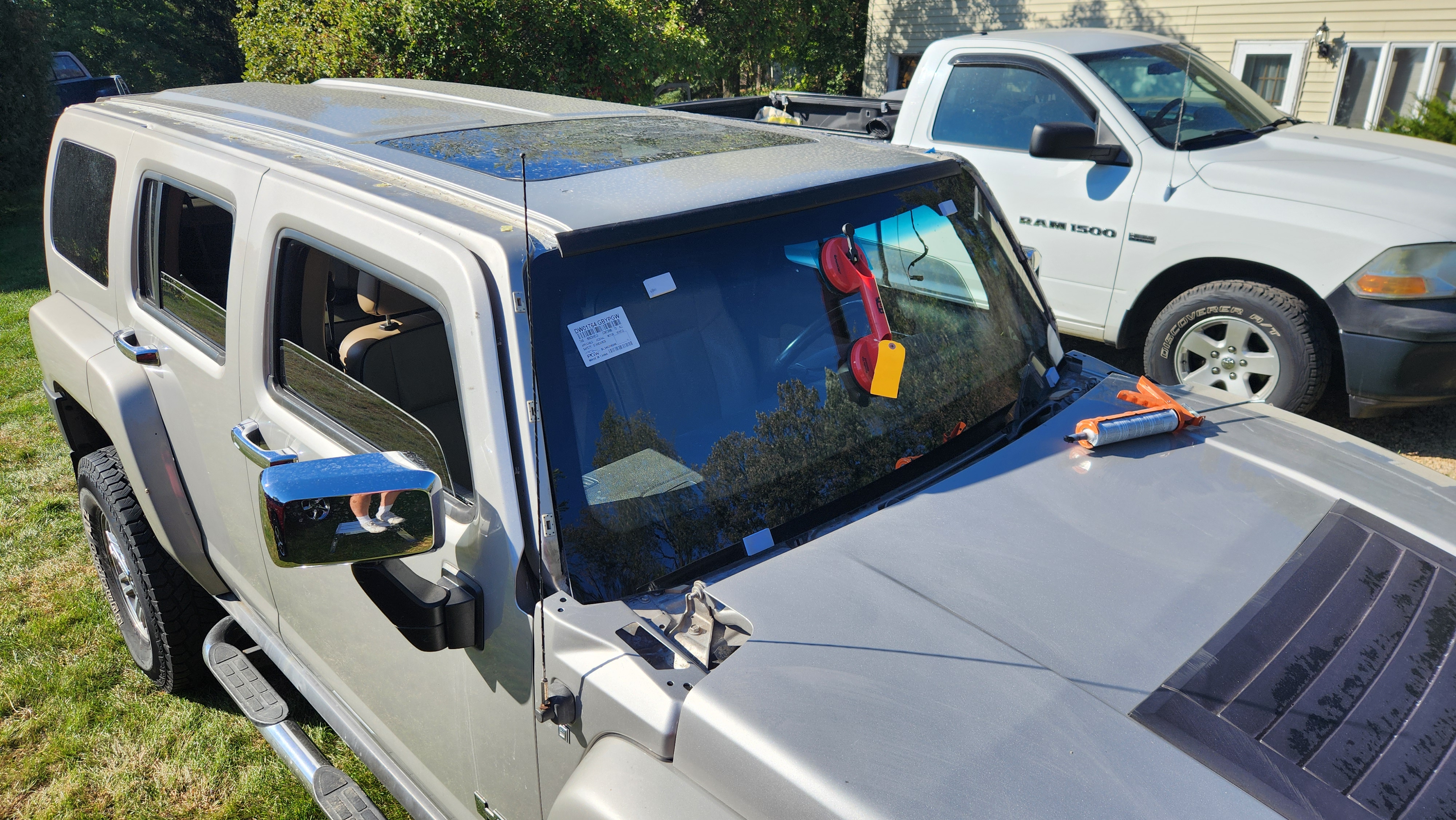

I re-did the roof on my H3 last summer (degraded clear). Re-did the ugly-looking roof rails with base/clear. Put in a new windshield. New glass makes it like a new truck.
