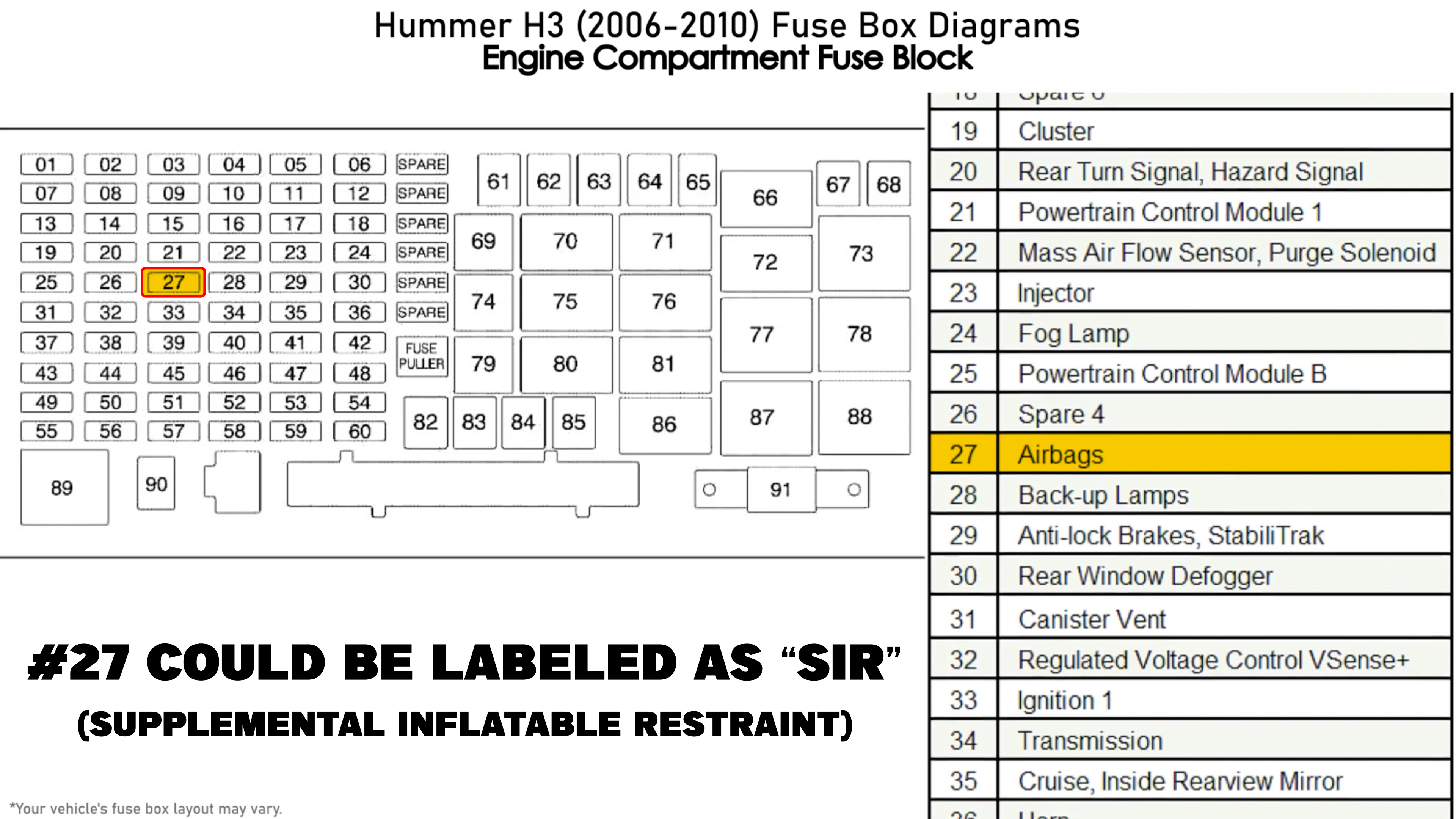

2. Open the Fuse Box: Pop the hood and locate the main fuse block (driver side fender well area).
3. Locate the SIR Fuse: Find Fuse #27, labeled "SIR" or "AIRBAG" (verify with your owner’s manual).
4. Pull the Fuse: Use a fuse puller or pliers to remove the fuse. The airbag light on the instrument cluster will illuminate, confirming the system is disabled.

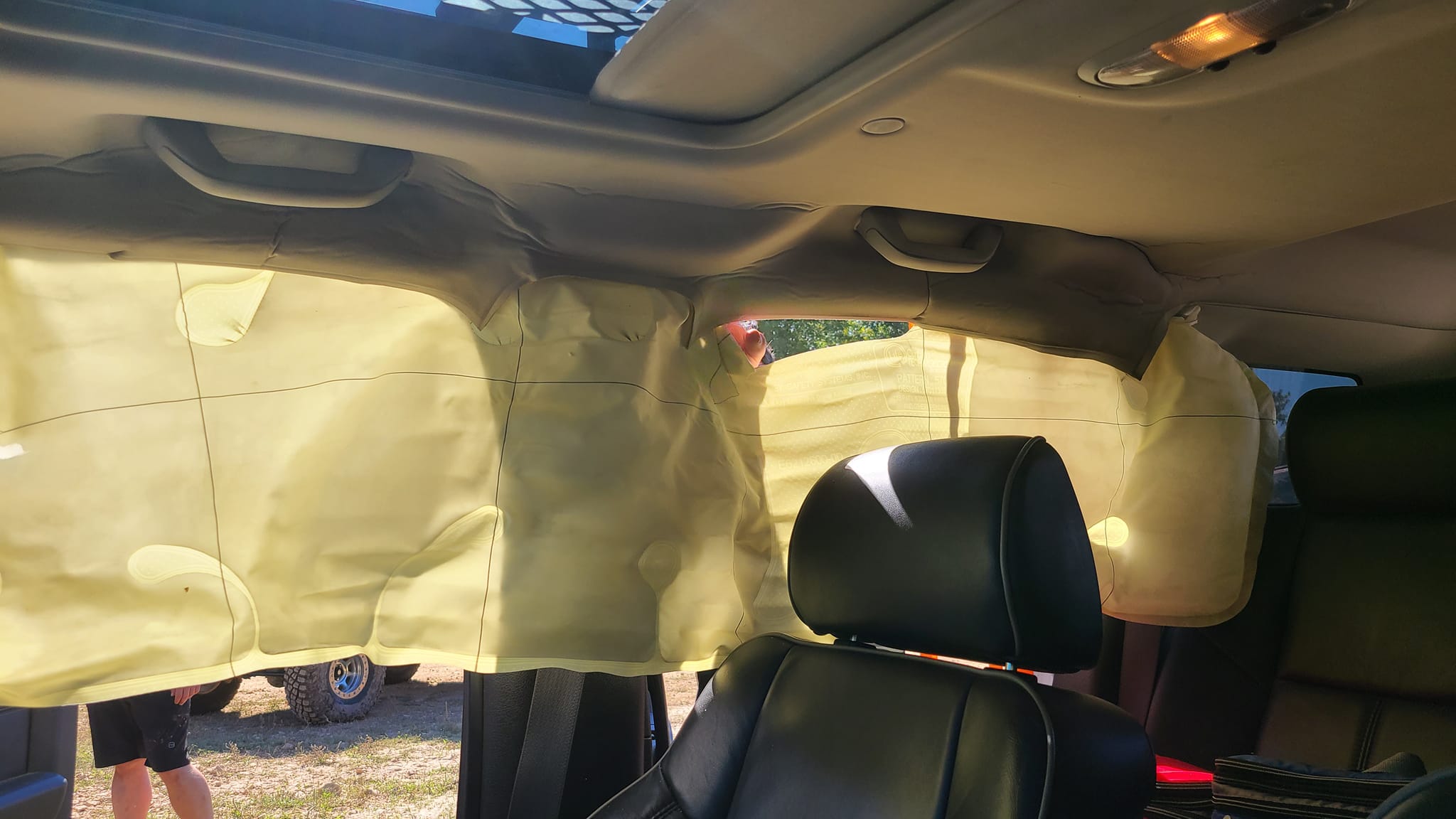

Example of Side Curtain Deployment Caught On Video:​

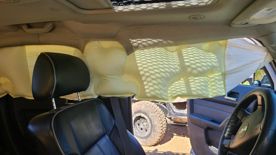

A great tip that I personally would advise to use but you do need to weigh the risks and benefits. I have done plenty of trails that airbag deployment would've been warranted, but the gremlin reared its head on a light trail to the actual trail in this picture at BSW 2022. Surprised a lot of us, especially me 💩. As you can see, it's not on an extreme obstacle or angle so this can happen at any point though I have not heard of this happening on normal highway use. I can tell you GM will be no use whatsoever to get this fixed. Not worth the risk of repair costs to me. I pull that fuse.
Yep, I do agree. Did you ever actually get everything repaired? It's actually kind of a complicated thing to do. There's not a whole lot of info out there on how to do it yourself. It can be done. It's just kind of technical.
I found a parts vehicle for cheap that had everything I needed & I used to work in the collision industry so nothing outside of my comfort zone.

I never witnessed it, but I know people who had it happen and did see the circumstances when it did. My fuse#27 is pulled every time. Off road I can control if I put my 09 in a rollover risk, I cannot control when the system detects a false assumption then trashes the inside of the vehicle.
