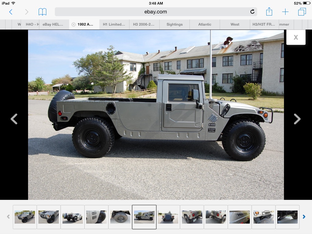

I've done my research but I'm sure you guys know more then I. First time buyer interested in pulling the trigger on this local 2 door.
Test drove this H1 yesterday. Ran and drove great. Apparently hadn't been started in 3 months, started right up.
Had small cloud of white smoke on initial start up, but dissipated shortly.
Paint job is a 6 or 7 out of 10. Rear underbody is painted well but EVERYTHING(nuts and bolts) is painted.
Thoughts?

Interior looks clean. There were only 10 HMC2 trucks in 92 and only one silver if that is the original color. The rust concerns me. It was hard to tell but it looked like the A frame in one of the pictures was rusted also. It always concerns me when a Hummer has an undercarriage that is that shiny. Makes we wonder what they are covering up. I would relook at the truck and really go over the under carriage. I use a screw driver to test for serious rust. Might also try to remove a few nuts and see what you find out. Price for a 92 is a little high. 6.2L NA motor with a TH400 tranny is not the most pleasurable driving combo. I love my 92 but it is a trail truck. I have driven it to Moab numerous times but that is an exercise in patience.
10,514
It is also a pretty base truck as the earliest were. No winch, no rocker panel protection, no CTIS, etc. That figures into the value. I have been told that my 92 was the first with a factory winch.

This one was originally tan, was resprayed at one point.
Paint job isn't the best but it's holding up. Where do you see rust? I'm mechanically inclined but it's hard to look for faults on machinery you've never truly looked at before.
Let me add, I have the ability to purchase for 30k even..

I think the point is your not seeing the rust. It's very very possible to think they painted the under carriage on purpose to hide all rust.

Thats what happened with mine, looked clean as could be, but at soon as I tried to install the lift we found out. Alot of PB blaster and impacts later it all worked out.
One of my friends that worked at the offroad shop said it was the most rusted rig he's ever worked on.

12th picture shows the A frame. Looks like they painted over rust. Maybe they just painted over a bunch of road crap. Inside lip of the steel wheel in the same picture has visible rust. Impossible to tell how bad it is by the pictures. That is why I suggested you relook at the truck looking for rust. That is why I hate to see the underneath of a vehicle so freshly painted. My be fine but better to be sure.The 6.2 NA is fairly bullet proof. Not a lot of power but it is a little torque monster. With the three speed, gearing, etc 55-57 is about your comfortable top speed. Inclines will sap a ton of power. The AC is marginal. They are fairly easy to work on. 30K is a much more realistic price. I love mine but I only put a couple of thousand miles a year on it.

I'd have to agree with everyone's comments. You can easily tell underneath where there is possible rust that was painted over. To me is doesn't even look like it was ground off but simply painted over. The biggest red flag in my book would be the condition of the engine compartment. Look at the amount of rust on the AC lines, brake lines, etc. If there is that much rust up high you can almost assured the undercarriage was rusted beyond belief and the reason why it was painted.
When my wife (girlfriend at the time) moved to AZ from OH her car was bought new and lived in OH for only 2 years. In that short time the road salt had eaten away at every piece of metal in the engine compartment after only 2 years. If I can I always stay away from older vehicles from states that have snow/road salt for that simple reason. Most everything I've bought is from CA or AZ, nice and dry!

I haven't been looking for a while, so I could be wrong, but I would say you could probably find a better deal than that. It is a long addictive road (at least for me). I always tell everyone the cheapest part of owning an original Hummer is the initial purchase. It may not be a bad idea to shop around a little. It doesn't look like this one has CTIS either, which I think is a must for one of these. I am in full agreement with everyone else on the black paint. Looks like something is being covered up. Even the aluminum diffs are painted?? The body mount above the exhaust pipe looks pretty crunchy. I could be wrong though.

Update: Went down to Brooklyn to see this H1 again. Have to pass on it.
Had heavy leaks everywhere underneath(oil pan, trans pan, transfer case) and one on the top side of motor, couldn't pinpoint it. Rust was visible but not overly excessive.
Buyer beware this truck needs a serious gasket overhaul at the very least.

The background says it all if I'm looking at the right listing...look at the roof of the building behind it...ceiling falling through and every single stack/vent is rusted and stained the roof....like an omen or something sheesh. They should of painted that building too to cover it up hehehe.
