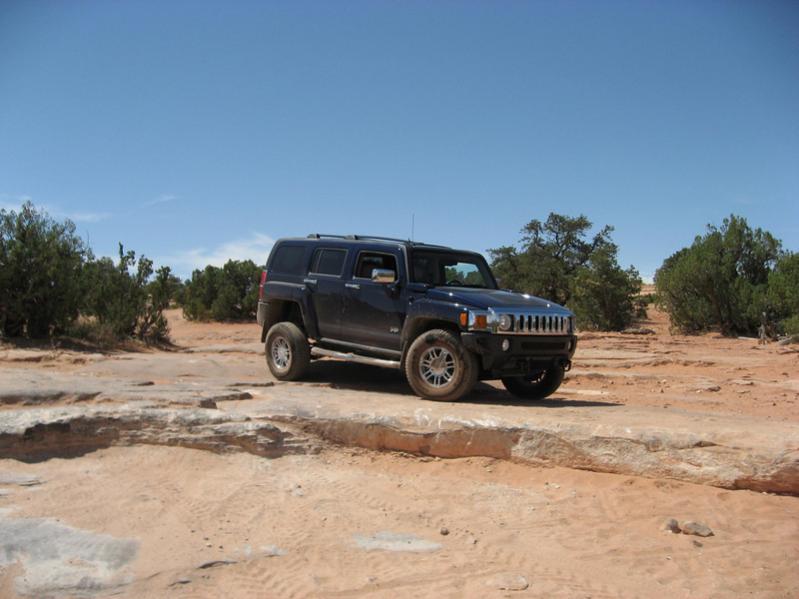

I picked up my buddy Jason in Grand Junction after he flew there from Phoenix and we did some intense (for us) offroading in Moab, June 2007. Gemini Bridges and Shafer Switchbacks! Please note the nerfs are still on and I declined to drive down this ledge
We did tackle other gnarly ledges
