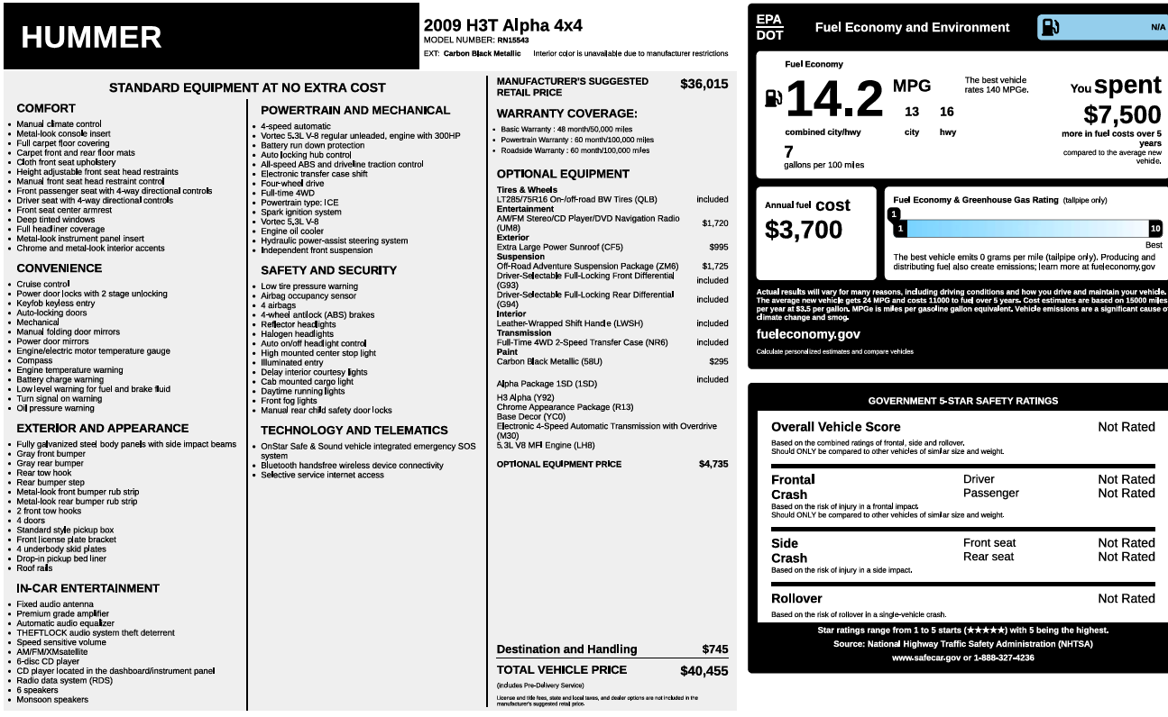

I also found some H3 leather seats on marketplace and this is a non luxury package, I may snag those and put them up front for the leather seats and then do seat covers out back as my 2 kids under 2 will probably ruin the rear seats if they dont get covers.
Heres the window sticker

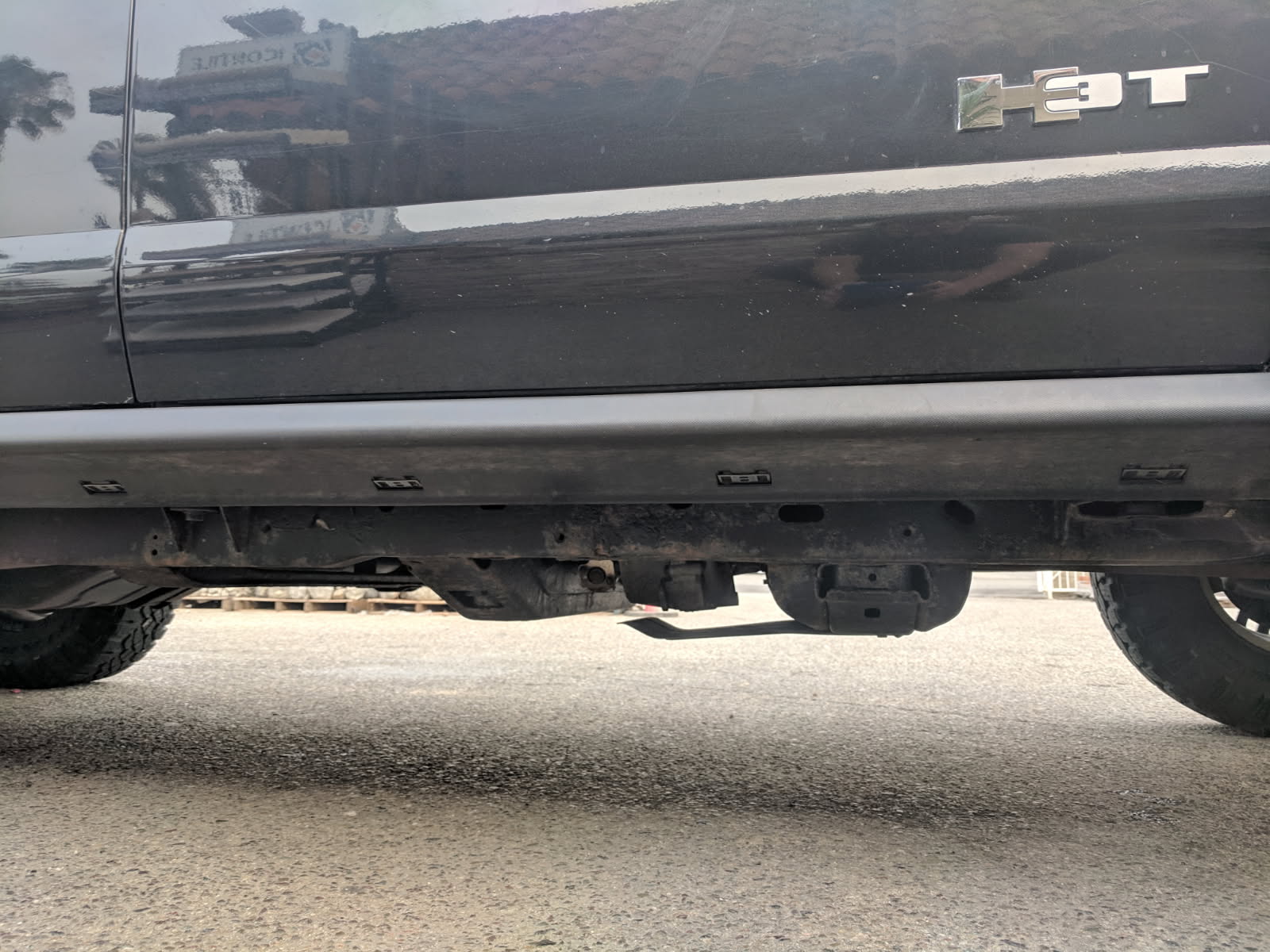

Yeah, the rust isn’t bad. I got pics of it
9,500
The previous owner is a piece of shit though.
Now that the rig is at my buddy’s place the pics of the sale are very inaccurate, fucking asshole.
Again, I’ll deal with it but I hate liars
2,830
Wow, looks good underneath. Did he take the marker lights off? WTF. At least your daughter will have a bad ass classic truck to drive to school.
