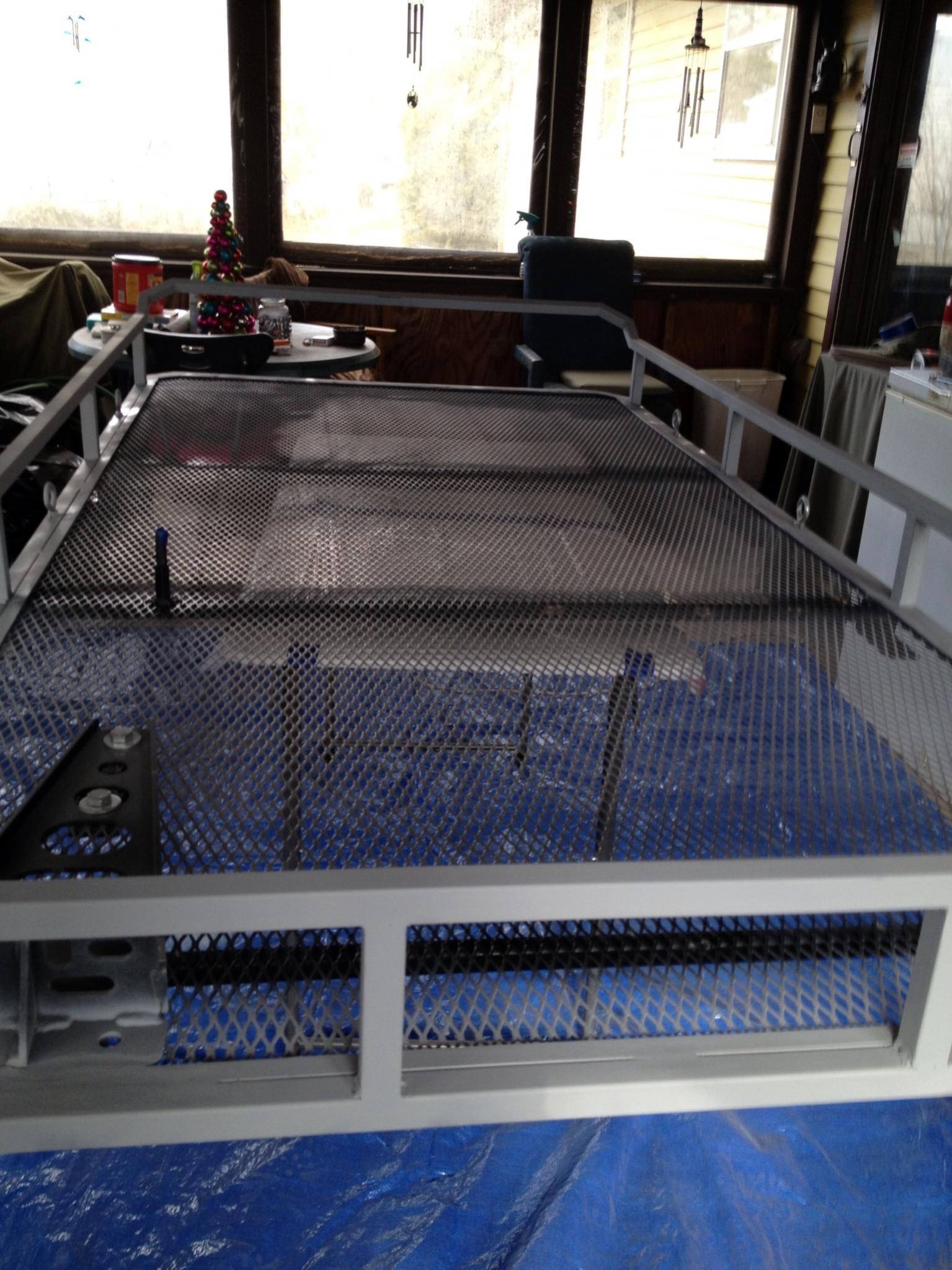

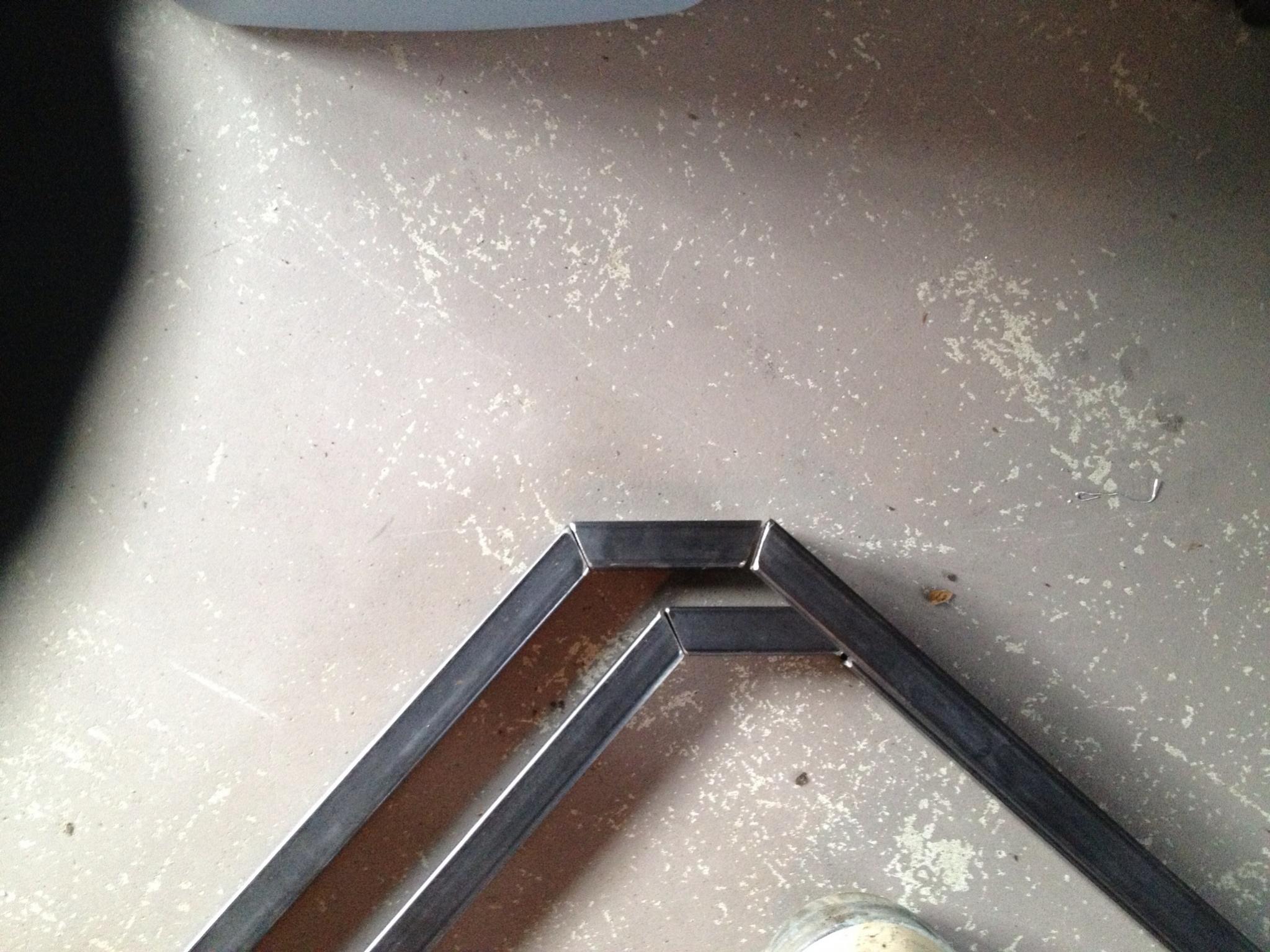

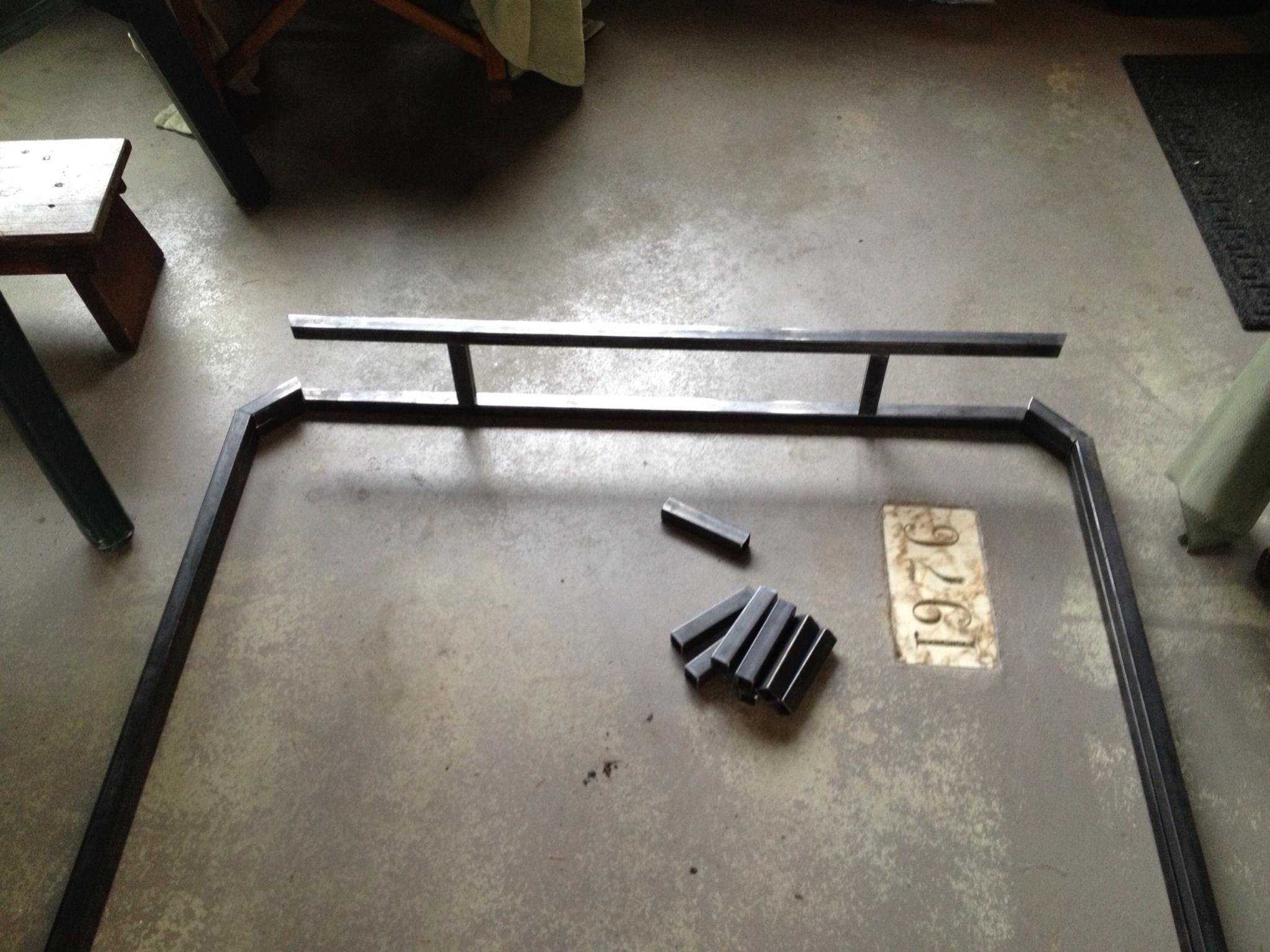

image.jpgimage.jpgimage.jpgStarted on the roof rack today. Framework all cut except crossmembers. Gonna get it all tack welded today(hopefully) square it up and go to town. More pics to follow.

I knew I should have patented/copyrighted/trademarked my design! :wink: Lol, just kidding! Looks good. How tall are your sides?

Thanks guys. Sides are 7" total. 6" after decking goes on. Sry scarsman It's such a good look. I did email you bout making me mounting brackets though.

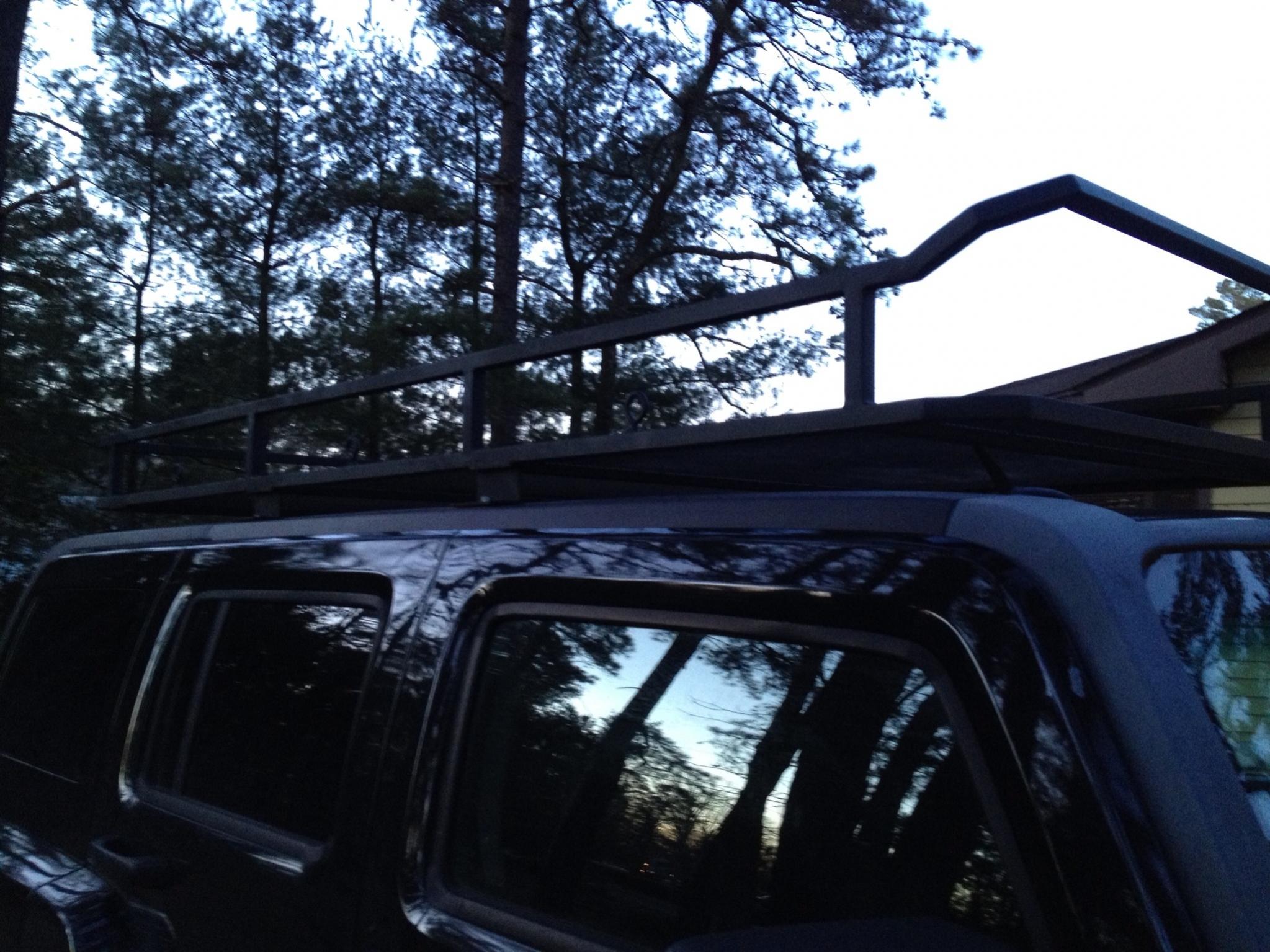

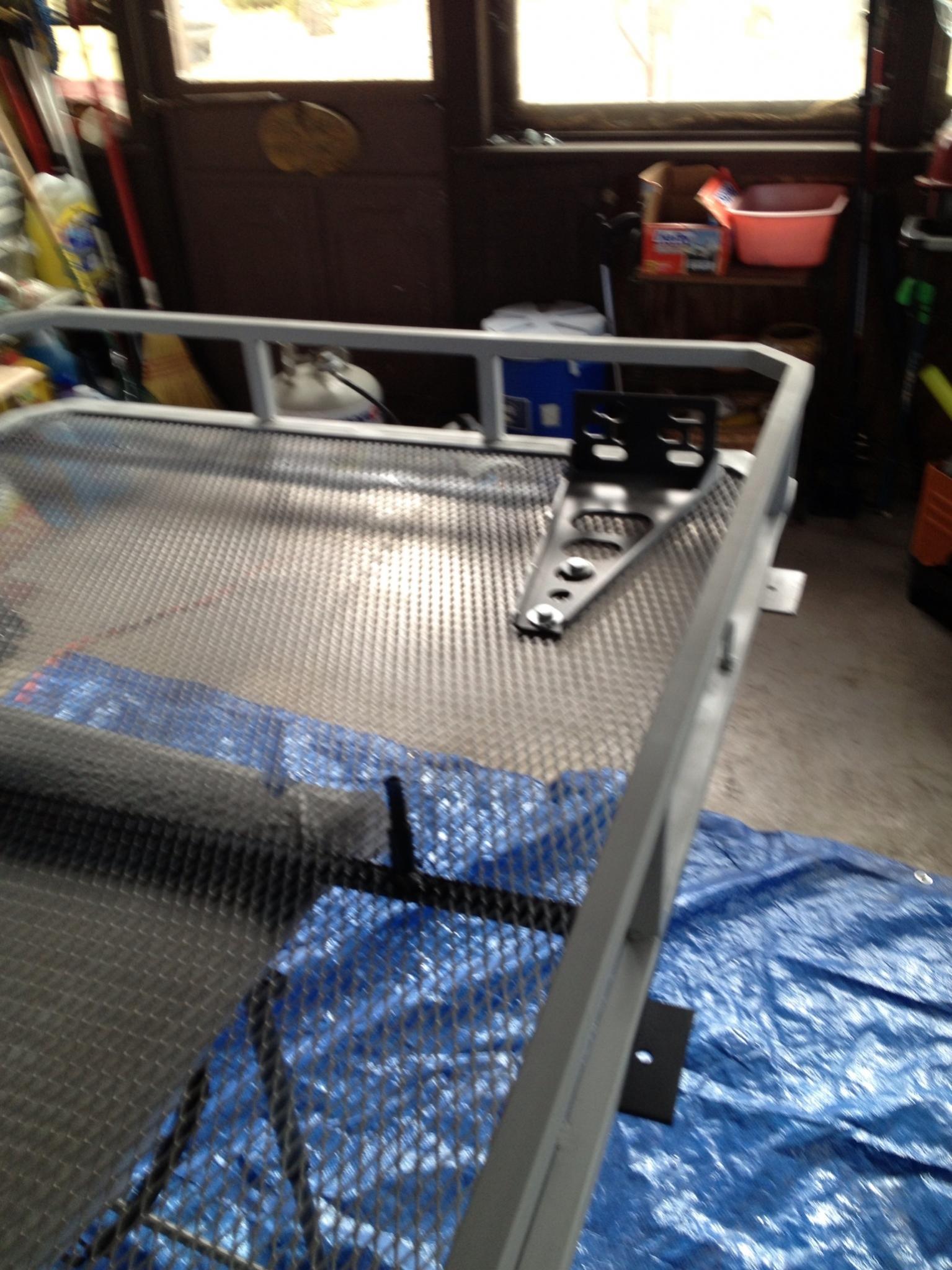

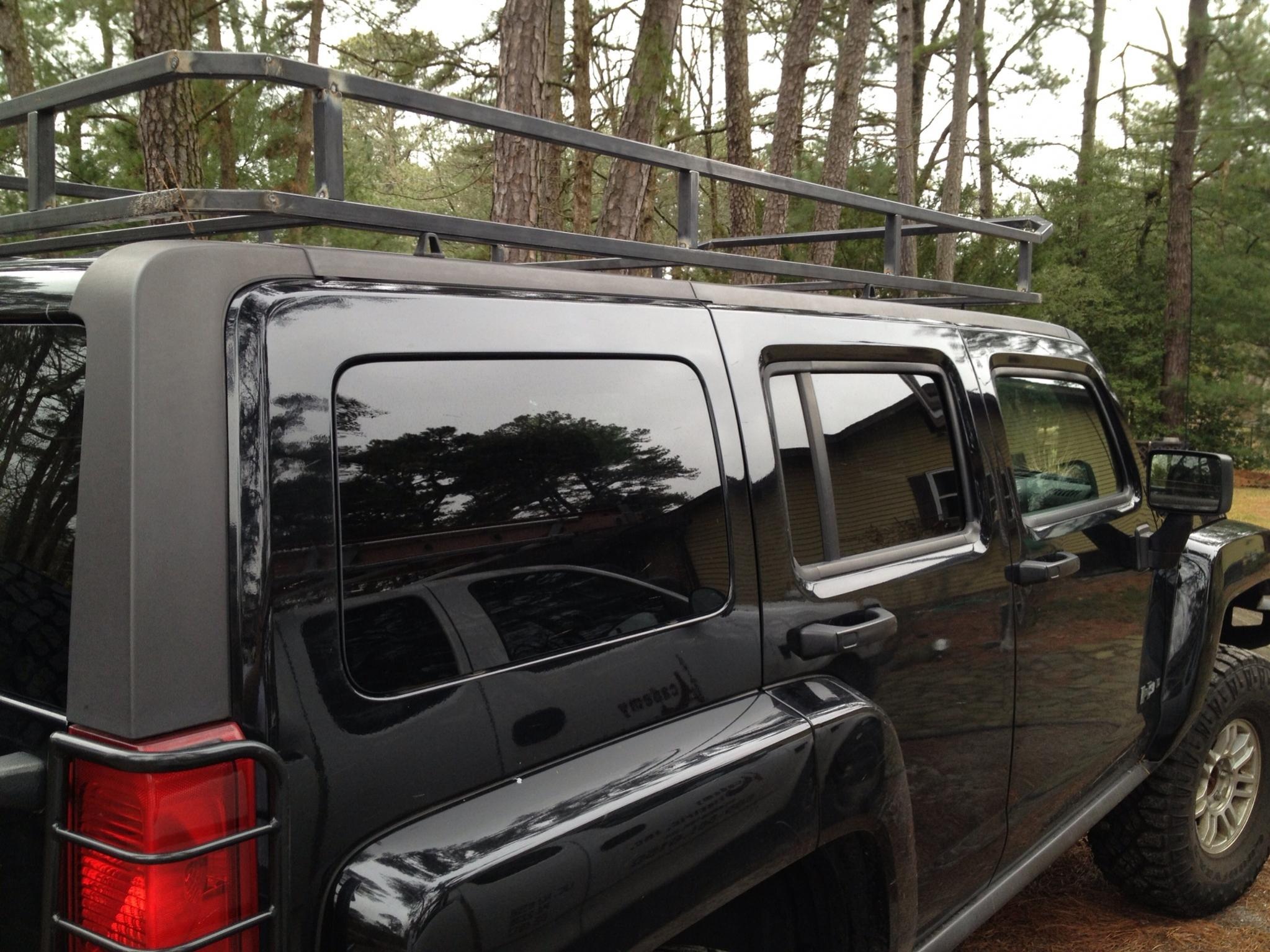

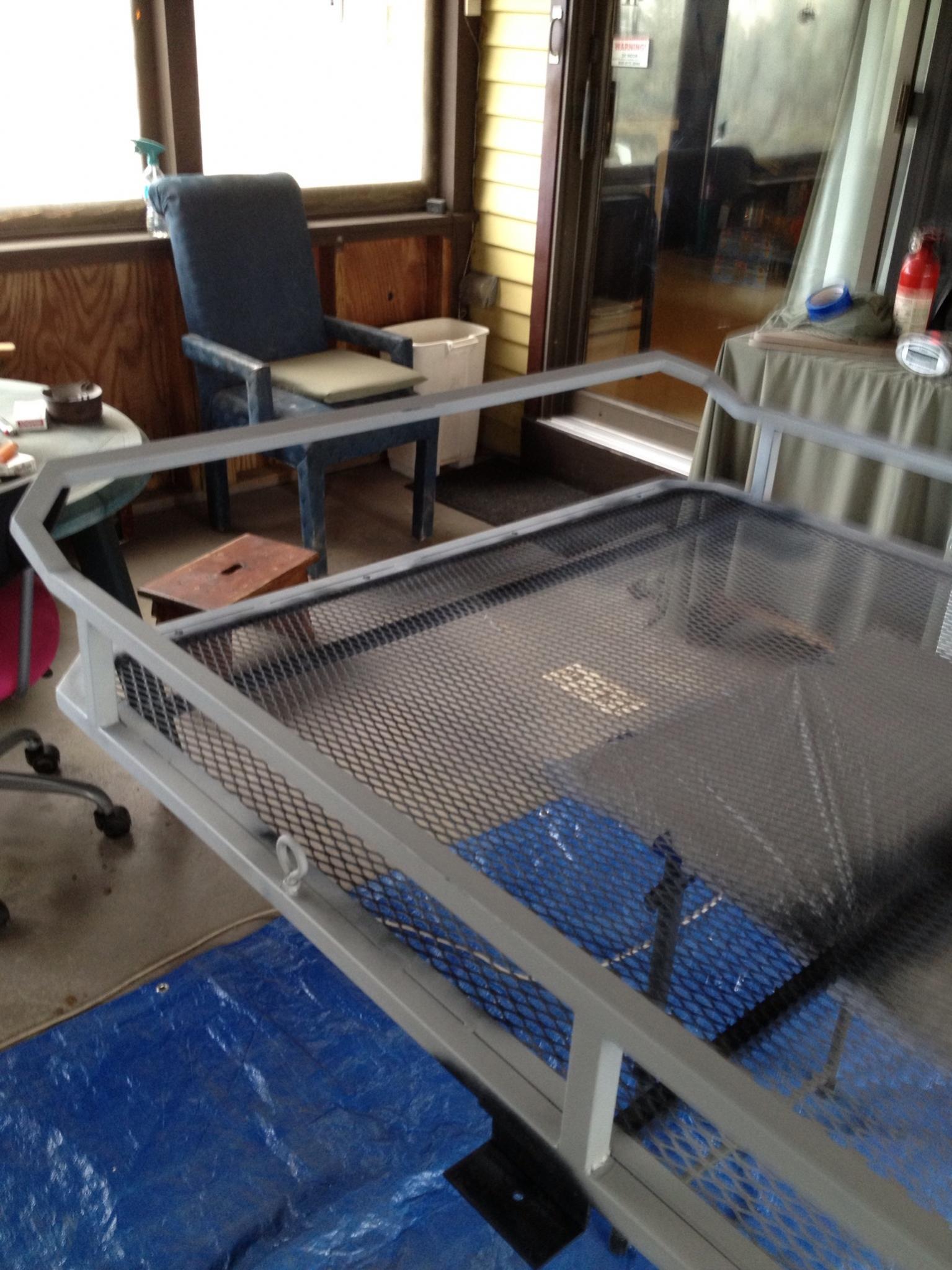

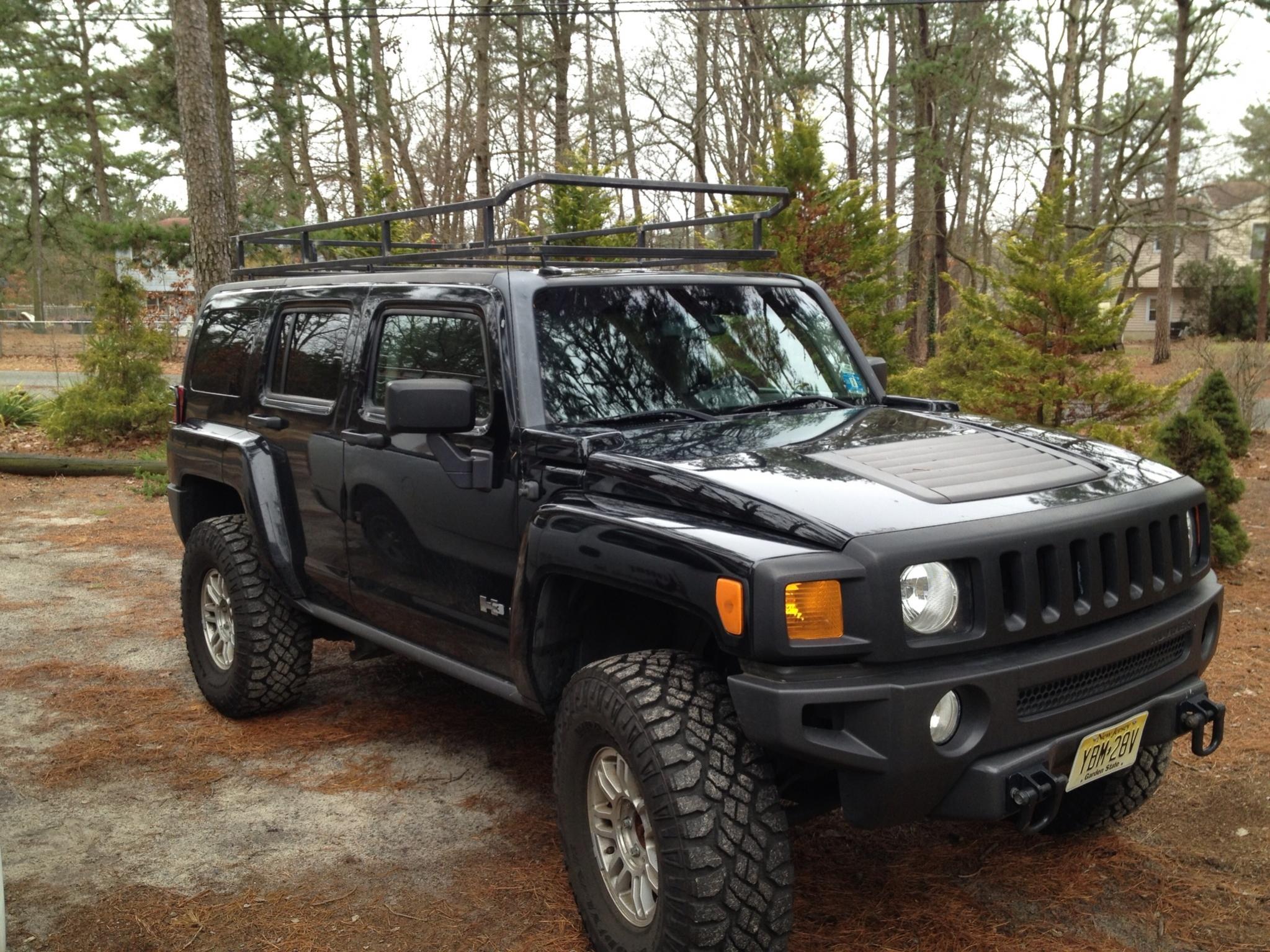

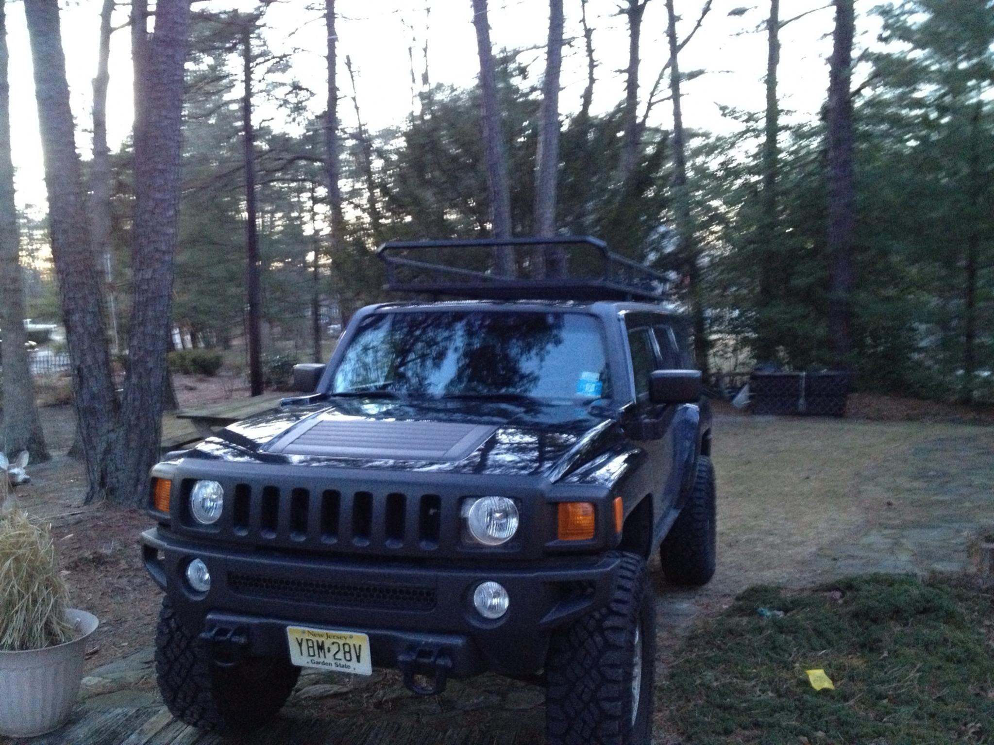

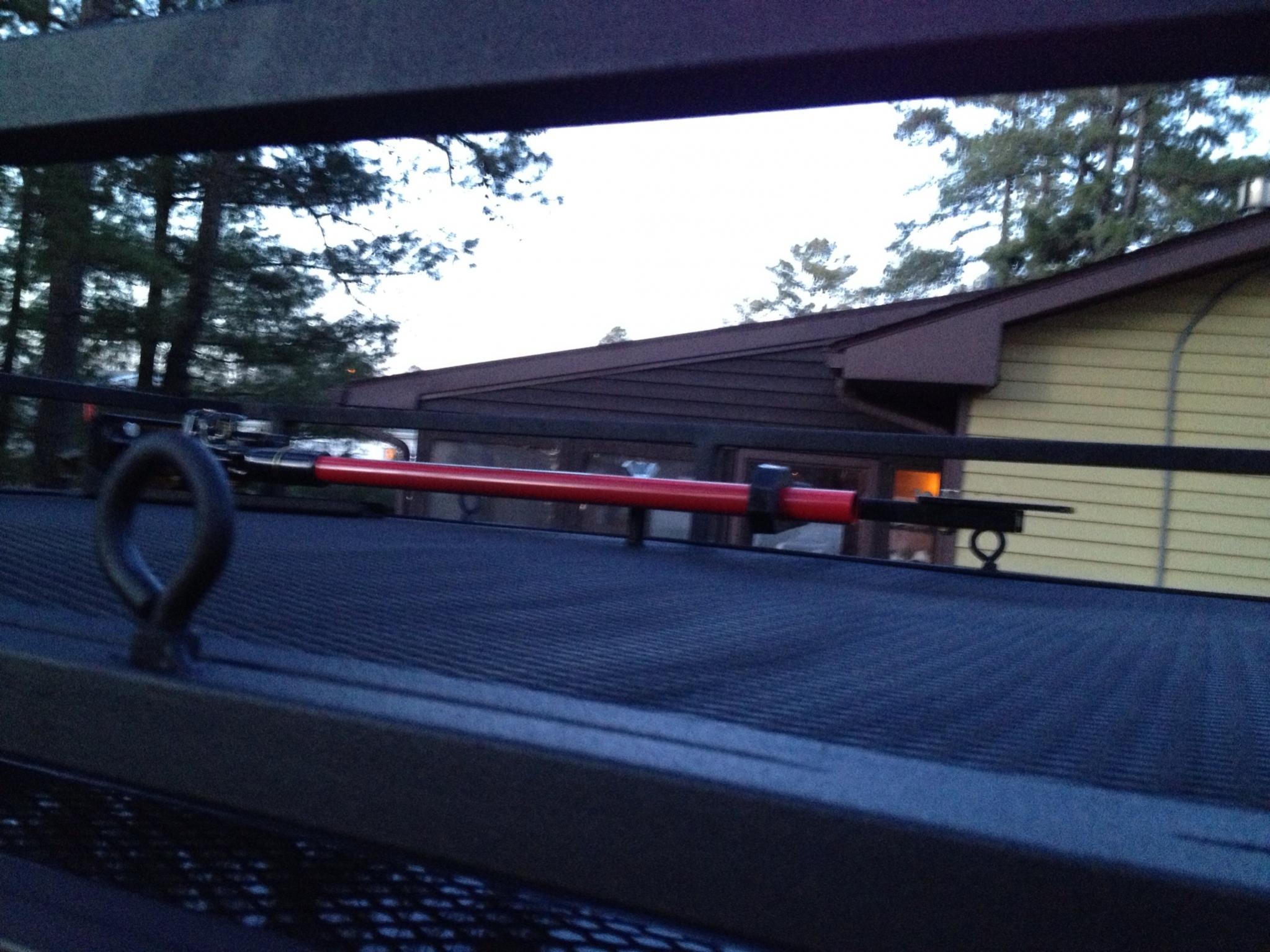

Just finally got it mounted. Couldn't find a powdercoater that was reasonably priced so I used my new favorite bedliner spray. Repurposed a jeep hilift mount up top.image.jpgimage.jpgimage.jpgimage.jpgimage.jpgimage.jpgimage.jpg

I got some ideas for stuff to build. Algin, do you think this could be done with round tubing and a pipe bender for the framework?

I was gonna go with round tube but the amount of notching involved turned me off. Could've bought a notcher I suppose.
I forgot where I found it, but with round tubing if you use a drop saw, angle grinder with cutoff wheel and or something to that effect you can cut at certain angles which create notches that fit great for welding corners, etc. similar to how you cut crown moulding at certain angles to be able to fit corners, etc.

You could do it with round tube and a bender, but you would not be able to do the angled corners, so to the radius of the bend. You would end up with the corners being very "rounded off" and lose a lot of usable space inside the rack.
