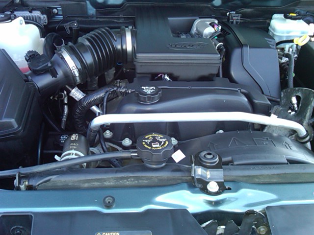

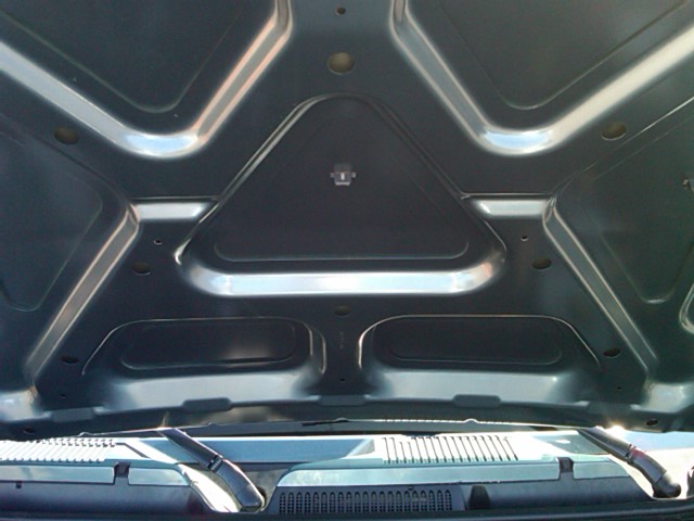

After driving through mud holes for 2 days (first 2 pics) the engine bay was totally mud covered - even the entire hood. Everything covered. $15 in quarters for the "Presoak" and a bit of amorall and it looked like the last 2 pics.

Wow, that's impressive. I have the exterior clean, and did the inside this weekend, but didn't get to the engine and some of the undercarriage much because of the nasty weather that we've had. I'll get a pic up today.
