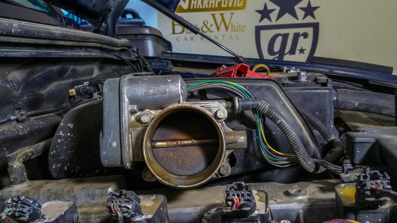

Also cleared out my catch can! Talk about gross!

What is the actual real reason the catch can is filling up with oil? Is it due to blow by on the piston rings? Is this a sign your engine is going to ****? Just wondering because I am starting to see more oil in my throttle body too.

Its been on for about a year, so its been long overdue to empty it out (lazy and busy) - No blow by going on. Its because I put the intake on, the stock one has all that **** in the way with the weird chambers. When i put the intake on it was basically a smooth highway right into the TB
2,402
Because while that's supposed to be the fresh air inlet for the crankcase ventilation system (the suction side is the other hose across from that one on the valve cover that routes to the throttle body) it has a bad habit of puking oil and vapor out instead. Theoretically that shouldn't be happening, but it does, and it probably gets worse with age as the suction side gets gummed up and the oil vapor is sucked/blown out the fresh air side instead.
I'm going to put a catch can in myself and next oil change I'm going to blast some Sea Foam through both the fresh air and vacuum ports on the valve cover to try to clean them out. I'll do it before I drain the old oil so that it reduces any potential issues, plus Sea Foam is supposedly safe to put in your oil, so a little bit left in shouldn't hurt anything. It's that or I pull the whole valve cover off and clean it properly.
