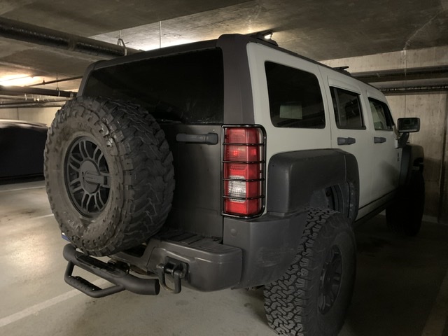

Small update. Had some major issues water leaks in the H3 over the summer. Luckily Geico covered it under collateral. Shop steam cleaned the headliner to remove water stains and replaced ALL of the carpet brand new. Turned out the sunroof drains were clogged with pollen and other small debris.
So, I get it back and you’d think everything is fine and dandy right? Wrong. There was another leak that was overlooked in this whole process, that luckily Geico classified as the same claim. It was coming from under the glove compartment and explained why the front passenger footwell was soaked. Come to find out, this cabin air intake drain had also clogged so water was overflowing into the cabin in heavy precipitation. Cleared out, new carpet was steam cleaned all throughout the area and I’m good as new.
I know I’ve said it before, but I’m actually going to try and do a big update on my build thread this time. Keep a look out if y’all are interested. Hope everyone’s been doing well on here!

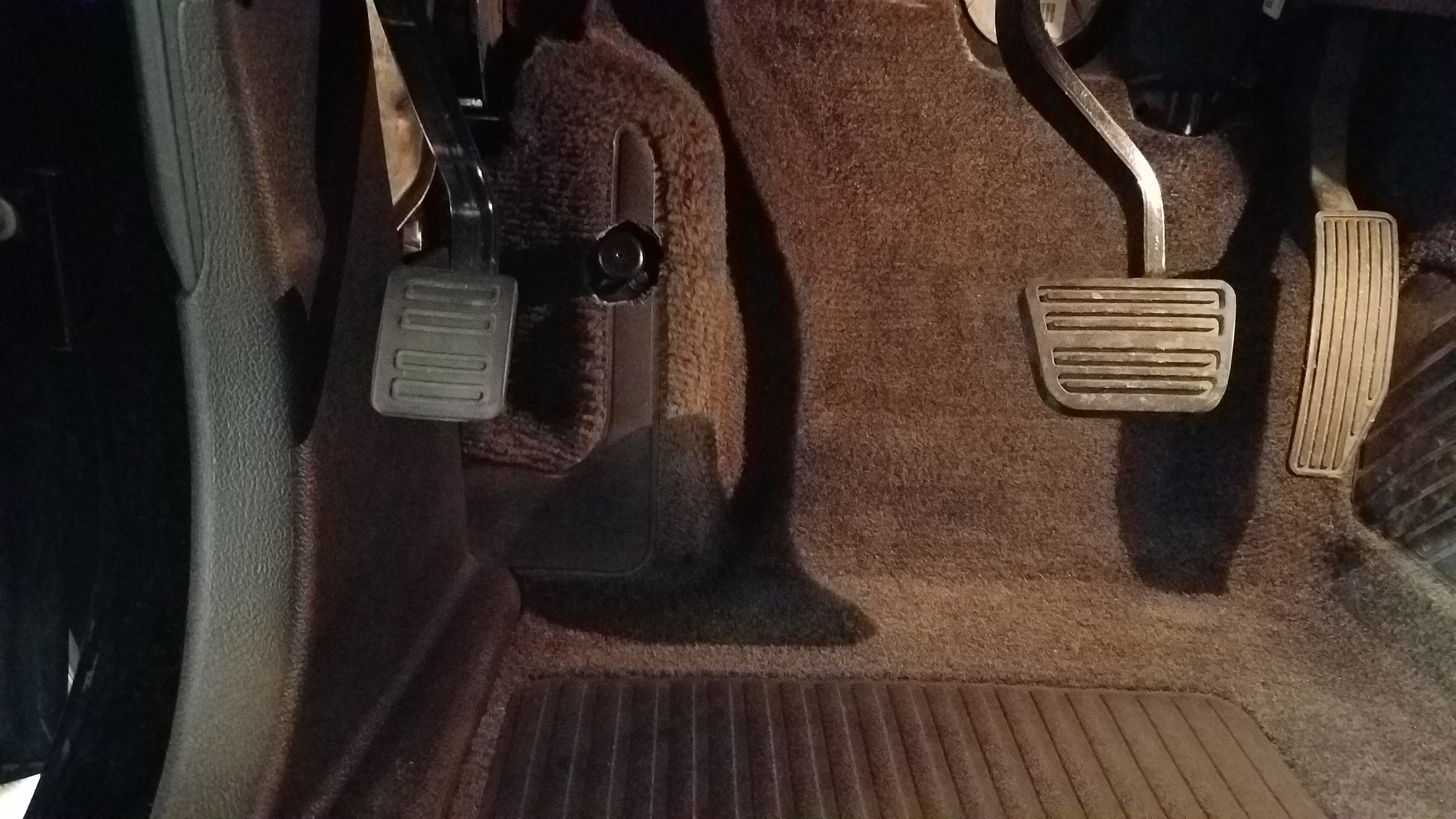

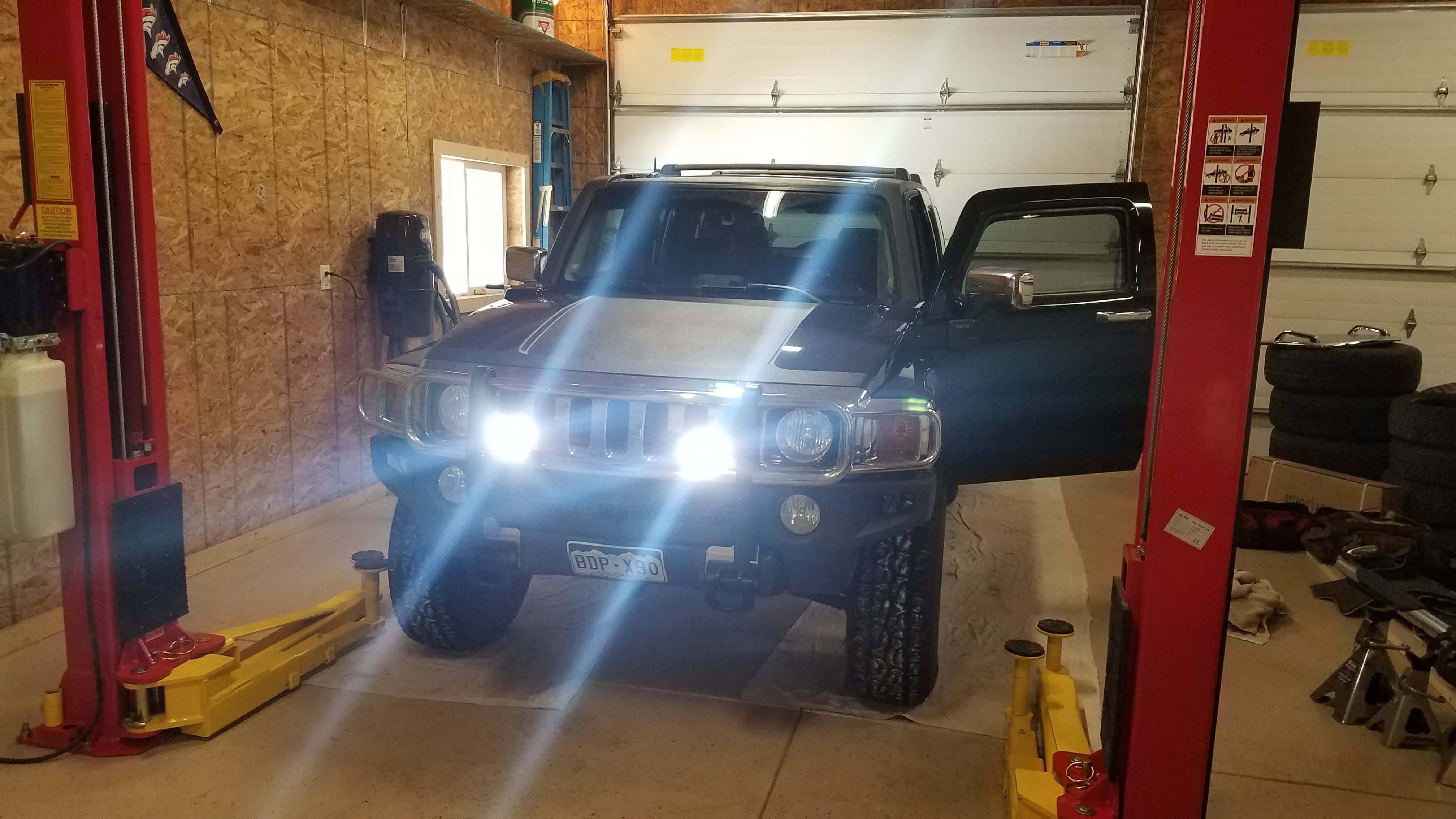

installed a foot switch for my lights
They are temporary (good thing they were cheap) temporary because they don't throw the light down the road as far as they claimed to. They are awesome trail lights though, extremely bright and a wide, wide pattern. I want them to go way down the road to spot deer/elk while i am crusing rural roads in Colorado. I will be going back to the hella 500s i have had on previous rigs. The hella 500s reach way out there..

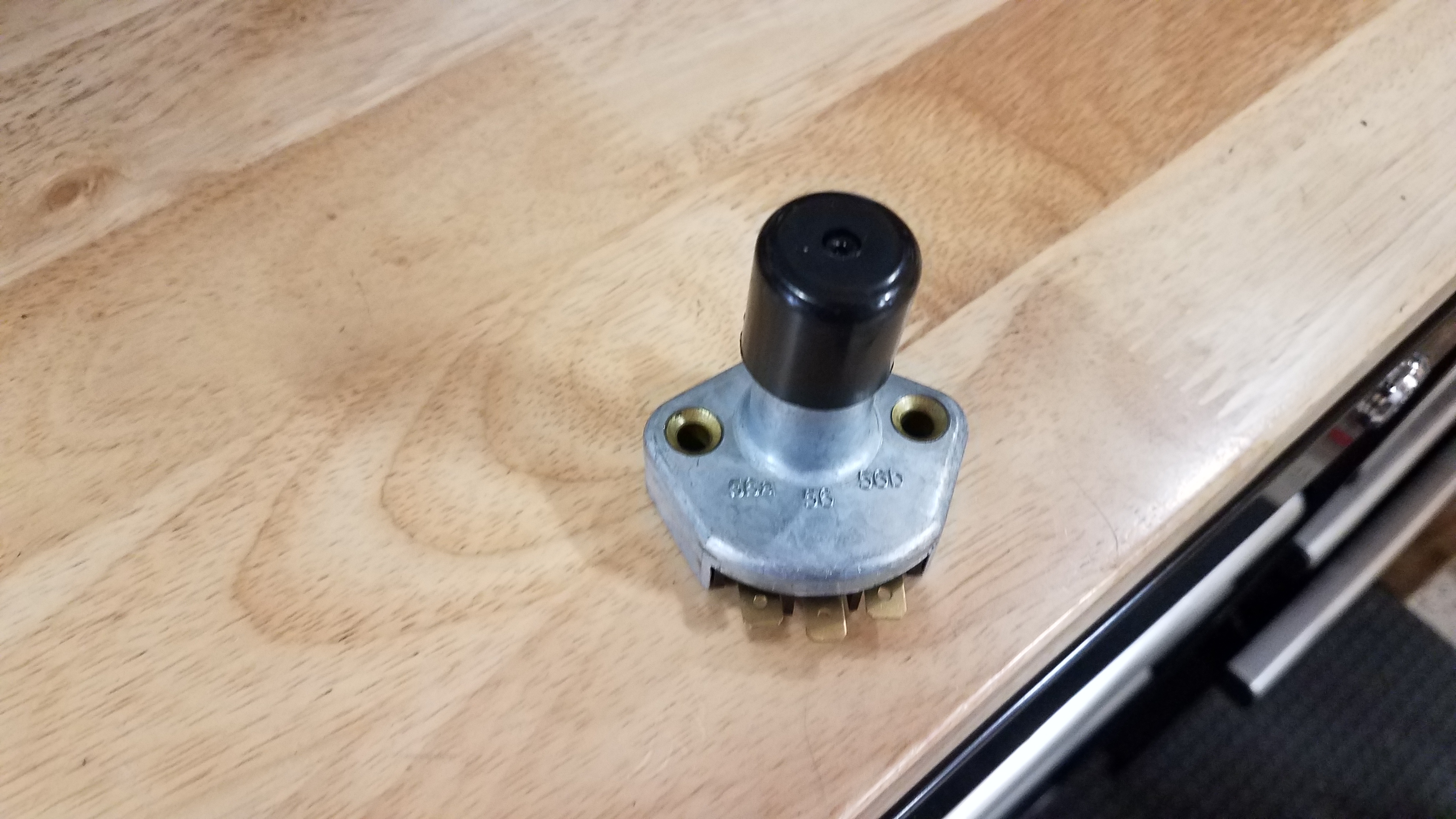

I want to be able to use them as my brights at night on those back country roads. It's a pain to have to reach out to the dash every time i want them turned on or off. They are already on a switch that is right next to the steering column. Coming around a corner, down shifting, does not leave my hand free to dim the lights for oncoming traffic. Foot switch is the easy solution...
The lights:
The switch:

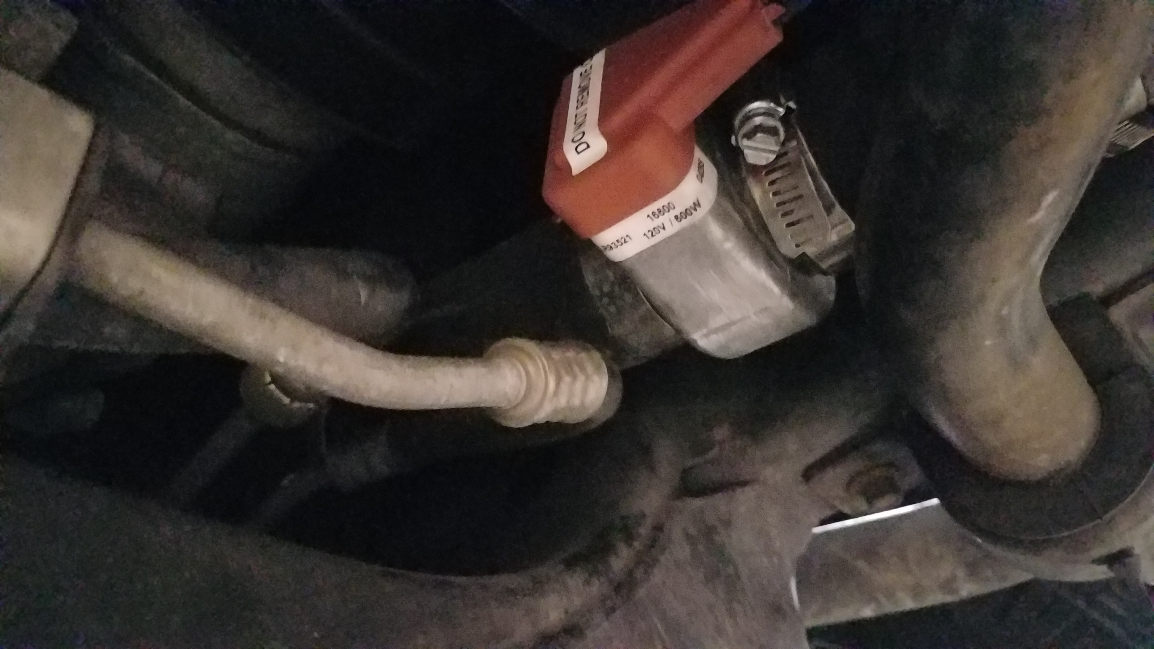

installed a engine core heater, 600 watt, installs into the lower radiator hose.
I using the hummer more during snow storms that the truck so it's been sitting outside under the carport.
It was -22 degrees the other morning. The h3 did not like that one bit. Very hard to start.
the heater seems to be helping:
